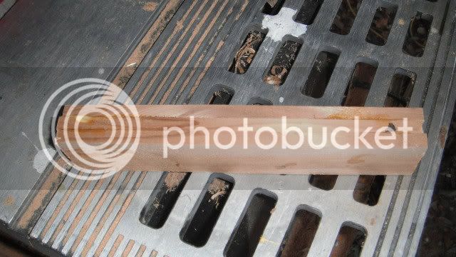

    I have built some paddles but never a oar or a birdmouth type shaft. So I figure there is no time like the present so here we go.

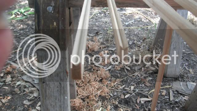

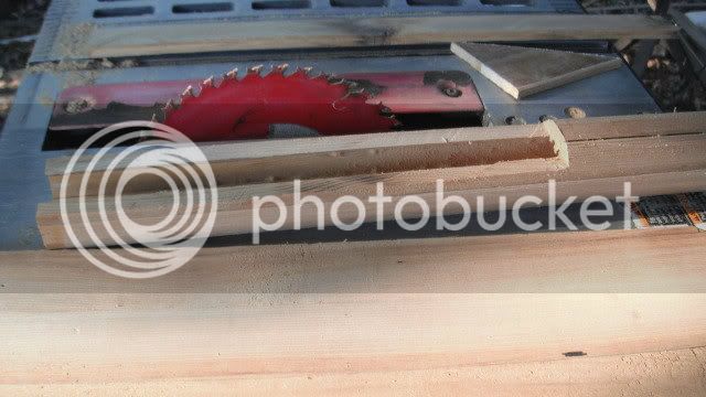

    Had some cedar strips 1/4 thick so I ripped the 45% angle in the edge.
    [​IMG]

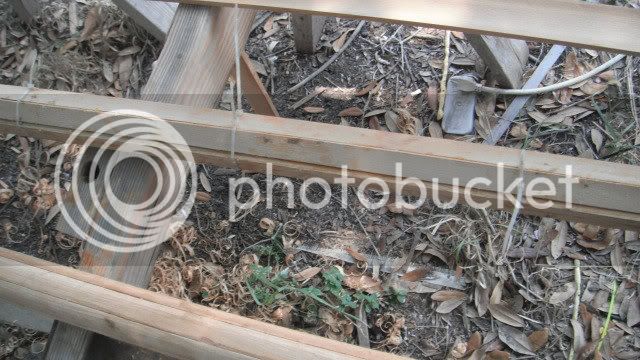

    did this to seven pieces and the glued them up with tit bond II

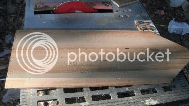

    [​IMG]
    The zip ties work well to hold them together.
    view from one end

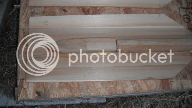

    then I glued up the blades and ran them through the planer
    [​IMG]

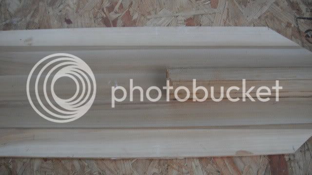

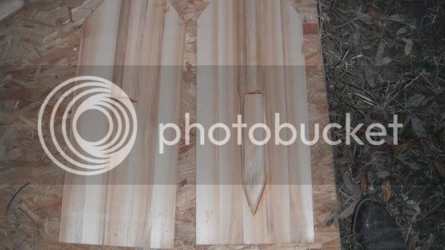

    Cut a slot 1/4 deep on the side of the shaft
    [​IMG]
    glued on the blade.
    [​IMG]
    layed up another piece of cedar for the blade brace.
    [​IMG]

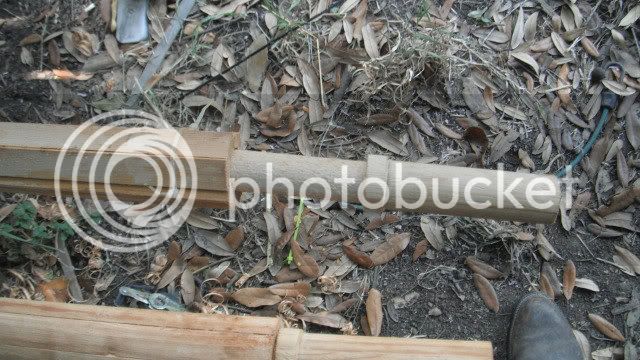

    Trimed the tip piece , it laps inside the shaft for an inch and a half.
    here is one I am fitting
    [​IMG]
    one glued in place
    [​IMG]
    then I started sanding and finishing the shaft.

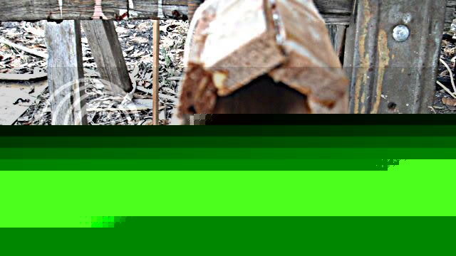

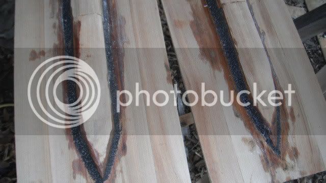

    Fillets run on paddle blade.
    [​IMG]
    a lot of sanding and then a precoat of epoxy.
    [​IMG]
    There starting to look like some thing now and still plenty light.

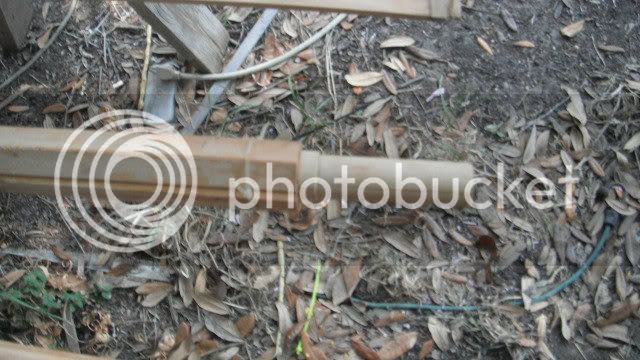

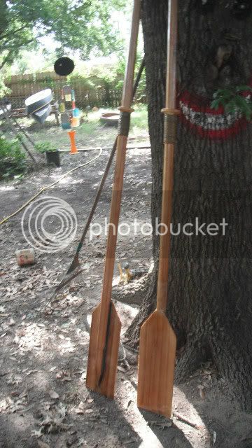

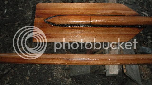

    I put cloth and epoxy on the blades and 6 inches up the shaft. then wrapped the wear points with rope and made stops for oar locks and installed them
    [​IMG]
    put on another coat of epoxy and then spar varnish, they are still plenty light.
    I will be ready to try them before long.
