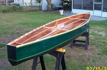

I paddle the rivers and swamps in Florida so for the most part rocks are not a worry. Stumps and downed trees are the things I have to avoid. For that reason , plus being light weight , I like the Luann or door skins for my boats. I epoxy saturate the wood then glass both sides. I use butt joints and epoxy saturate and glass each side of them. The joints end up with two layers of glass over each seam after the boat is glassed. I have used heavy glass ( 10 oz ) on the bottom of one boat and my youngest daughter has it in the Canadian waters with lots of rocks and so far it is working quite well for her.
The other boats have the 3.5 oz tight woven glass on and in them. One boat I added extra glass to the mid section on the inside for a little extra strength. One other boat ( Matt's , JEM Watercraft , Swamp Girl ) I used glass all around and then added strips of redwood to the center section in a oval shape covering the middle third of the bottom. Plus on each bulkhead.
You can see a portion of it in this picture Just before the forward Thwart.
