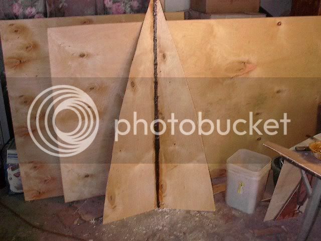

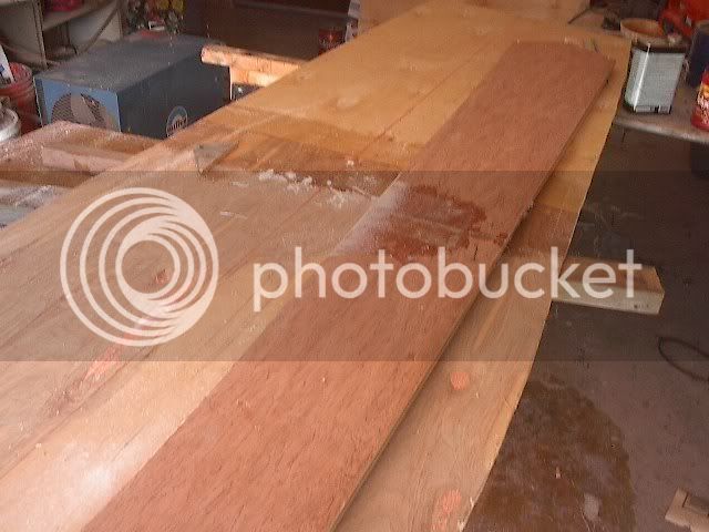

Glued a sheet and a half sheet together (for 12 ft boat) laid out and cut the sides

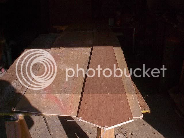

Started laying out the bottom
zip tied the ends and started putting on the bottom

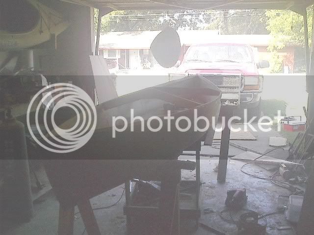

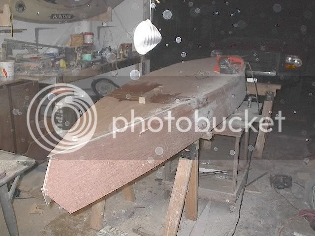

Well got a little more done.

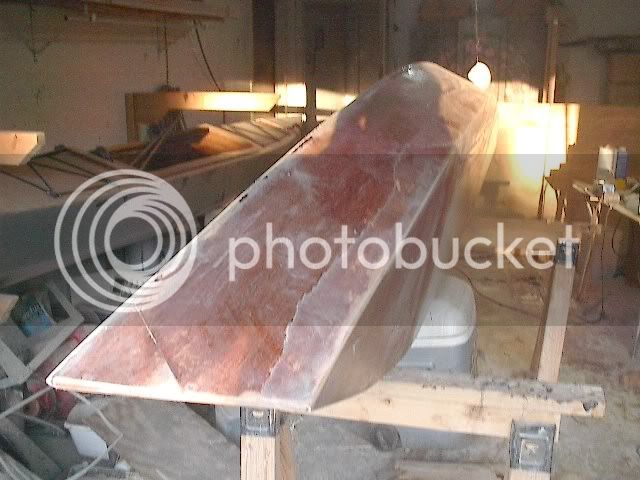

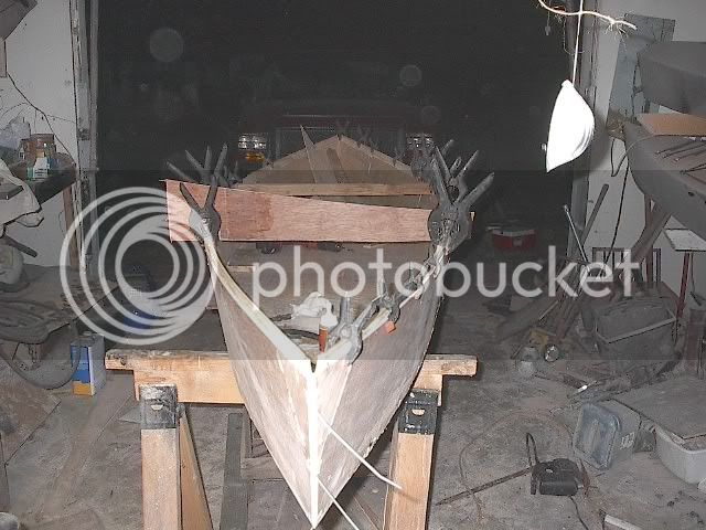

Got the yak flipped over rocker set.

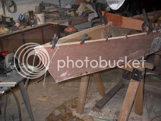

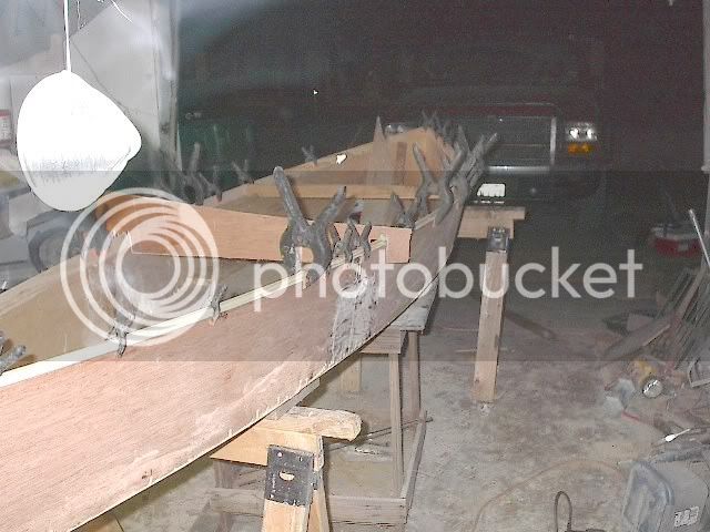

got shear strips installed

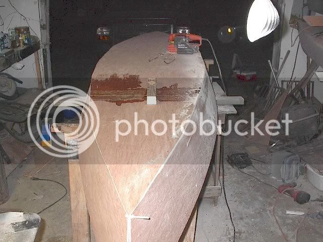

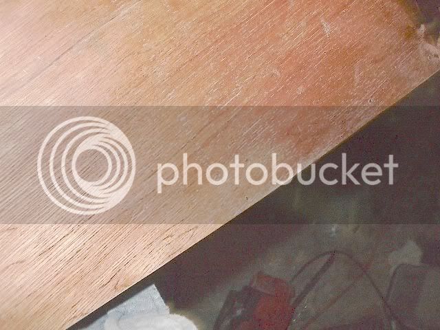

I fixed my little mess up I can't believe no one jumped on this

I was too busy admiring your "spacing thwart" to pee & moan about a small chunk of plywood missing & patched in.
When I was gluing my inwhales and spacers into the canoe, I used a cut down yard stick bowed in to press against both sides of the boat and hold the inwhales up against the side.
A Spanish windlass is handy sometimes too. Tie a doubled rope across the two sides, or take two entire wraps around the boat. Then, wind up a stick in the rope to tighten ti up and draw in the sides. It should be just long enough so that if you pull it a bit off center with one end sticking out further than the other, it will hit the bottom of the boat to keep from unwinding. The latter is then like a large tourniquet.

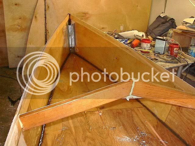

Filet done and end pores.
Got the deck cross braces in
inside glassed
front deck filet ready for cloth

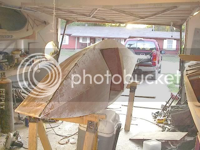

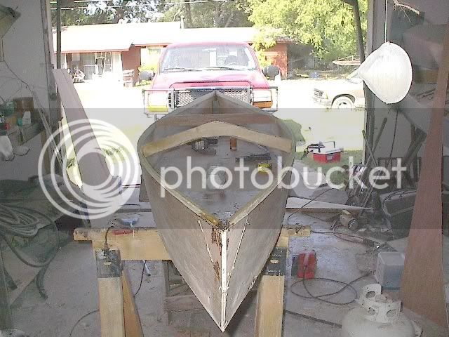

Decks are on
started fileting the decks to the hull
View from front
I will start fitting the cockpit out next

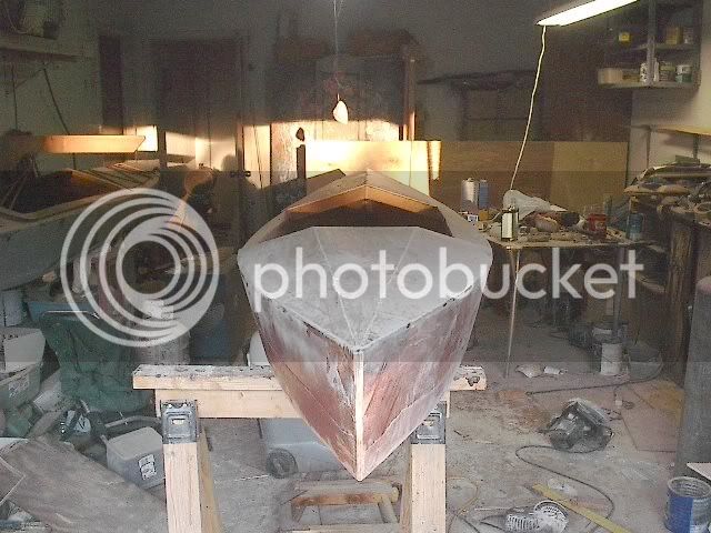

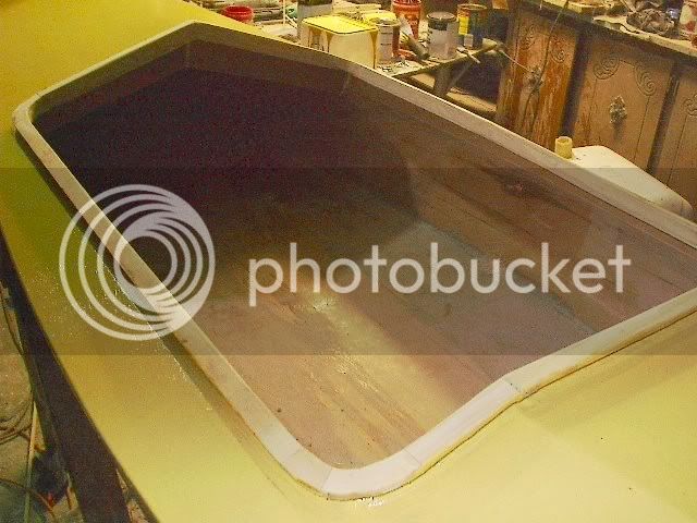

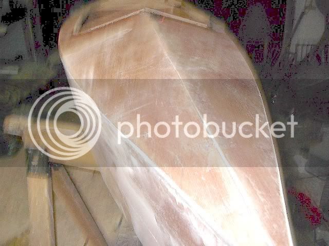

Little ole boat is starting to come together.
All seams filleted and sanded

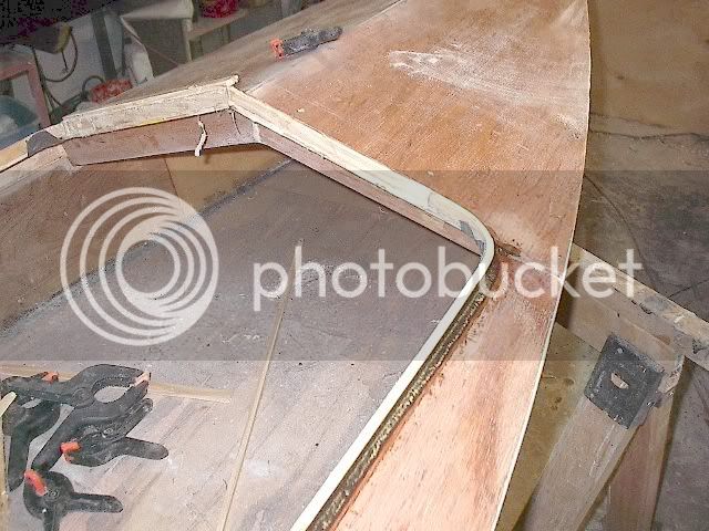

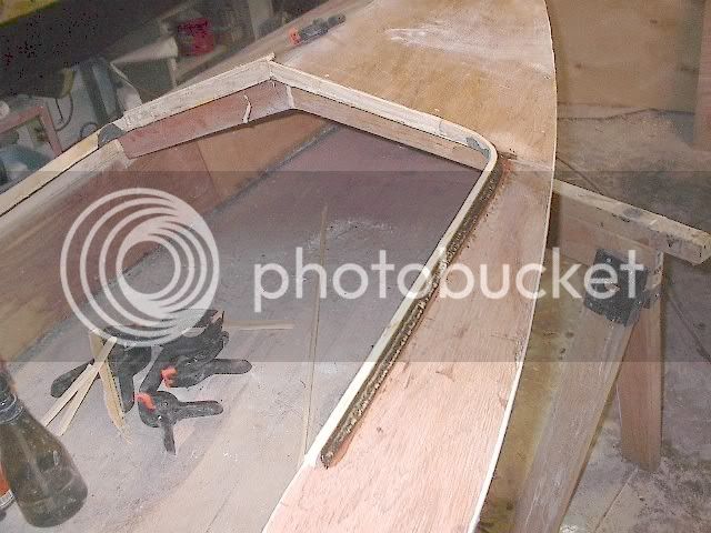

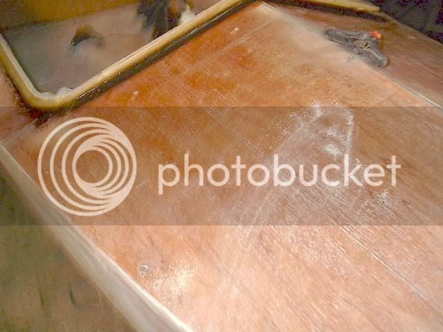

I decided to try something different on the combing
I took a piece of 1/4 by 3/4 and steamed and bent it for the combing stood it on edge. I like the looks of it.
finished that and ran fillets around bottom before I started the top combing
Dang sanding is slow but tomorrow will start putting some finishing touches on her.

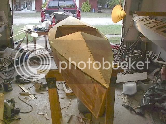

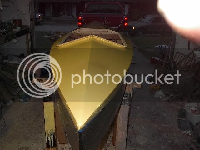

I started doing a first for me painting a wood boat
Now Chuck take it easy
It was what my granddaughter wanted so it what she is getting
It really doesn't look half bad
Still have the tape on the sides
