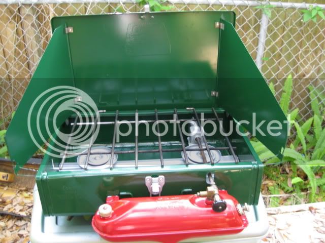

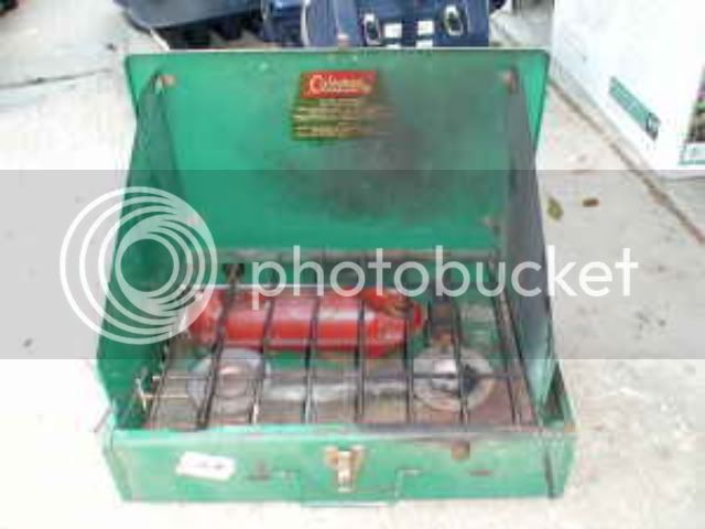

i love tearing them apart and fixing them up. here's a $10.00 bargain i found at a yard sale. looked pretty rough and nobody wanted it. i saw the gem behing the grime...
before:
and after:

thank you guys. i just enjoy tinkering around with stuff. i really the nostalgia and making things that someone would throw away, new again. plus, you just can't beat these old coleman camping appliances. i have a few old lanterns that i use as well.
