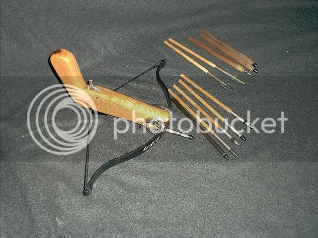

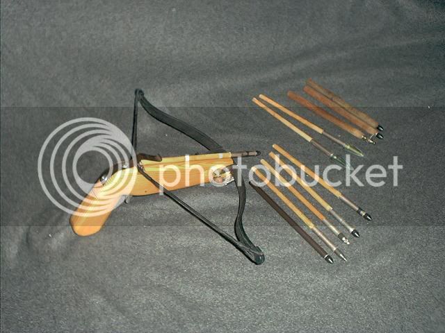

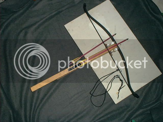

Built 5 so far. All use the rising pin trigger. I gave one to the neighbor to take with for hog hunting around San Benito this winter. I used commercial bows and strings with my own triggers and stocks. Three 150 pounders and two 80 pound pistols. The 150's bury the bolts past the fletching in my high density foam broadhead target at 30 yards.

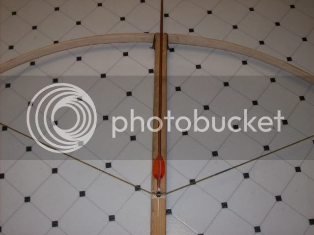

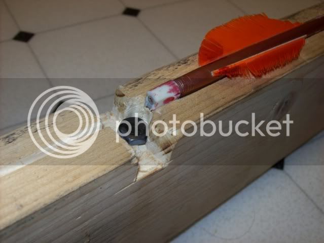

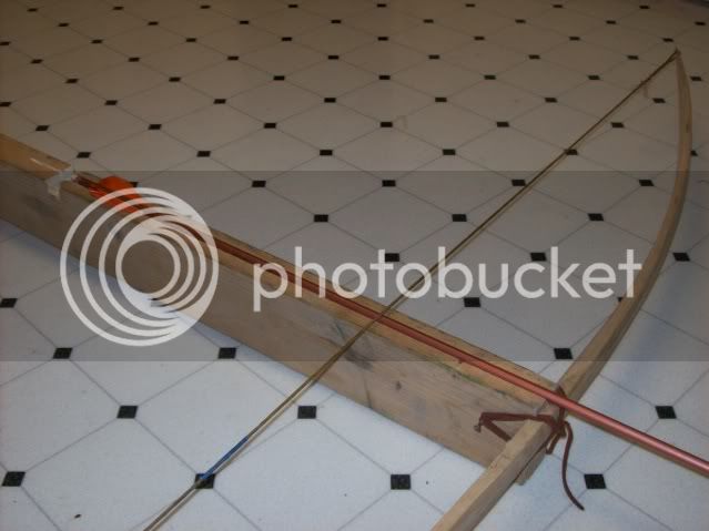

OK, so it took me a little longer than 15 minutes. Went out to the shop and 35 minutes later I came up with this.

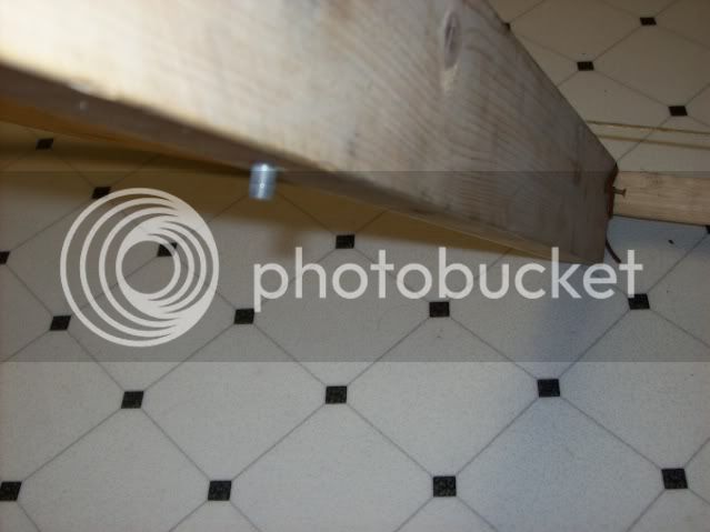

the "trigger"
It's very crude and has about a 15lb. "trigger" but it shoots an arrow with accuracy and authority. I had the short elm selfbow hanging around and grabbed the first piece of 2x4 I found. I didn't even have to cut it to lehgth. Drilled one hole and cut a couple of notches and ran a quarter inch kerf down the stock to guide the arrow. And my favorite thing : Cost $0.00. :roll:
You're slipping , Joey. Usually your project-completion estimates are closer than that. You could find a job in the gub'mint, though......somehow all their projects seem to double and triple in time and expense before they are done.
Nice, quick job......now, how does it shoot?
It actually shoots pretty good. The "trigger" has a long travel but breaks surprisingly well. Only shot a few times at 10 yards but it seems to shoot where you point it. I need to put some kind of arrow holder on it, add a pivoting trigger lever and refine the stock a bit. I'm not crazy about keeping a wood selfbow at full draw for that long so I might have to glue up a fiberglass version if I decide to continue with it.

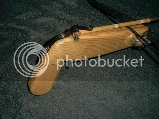

I use a piece of spring steel banding that presses the arrow down near the fletching to hold the arrows. Bend to shape and screw down to the stock behind the string notch. You want just enough tension to hold the arrow--too tight and it will twang like a tuning fork as you fire. A long trigger makes it easier to hold on target as you shoot. You won't send too many bolts off into the deep woods by pressing up too hard. :oops: :oops: :oops: :shock:

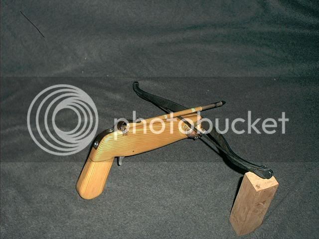

TOPSIDE VIEW Stock is 8.5 inches bow to butt. The bow is 18 inches and rated 80 pounds at full draw.
PISTOL UNDERSIDE Bolts are 5/16th dowel fitted with a section of old arrow and an insert hot glued in place to hold standard screw-in points.
Note hose clamp bow retainers.
BOLT RETAINING SPRING DETAIL The rising pin is a 1/4 inch bolt with the head turned smooth to about 3/8 inch diameter. There is a polished steel pin epoxied either side of the firing pin to take the pressure from the string and prevent wear on the wood at the slot
