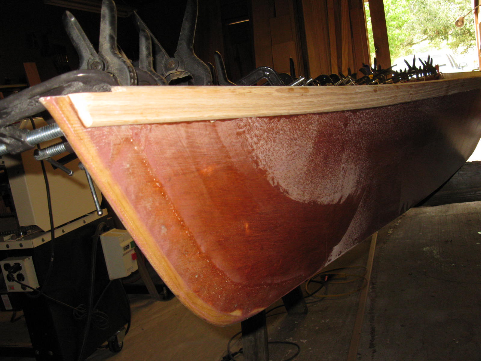

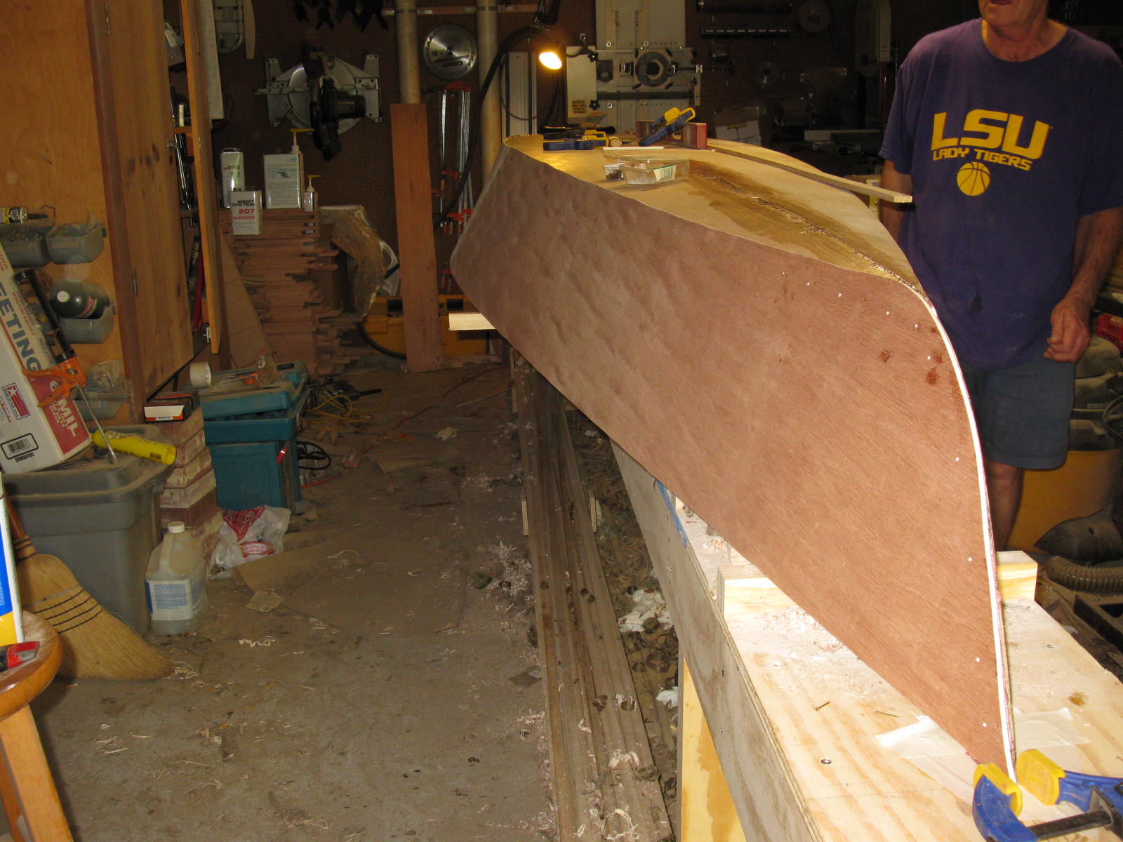

Chuck, I didn't curve it like a canoe stem because I never considered it. The whole proses has been to increase the water line in relationship to the overall boat length. These stems are a few degrees more vertical than the last boat. We had no issues with it and this not a drastic change.
Joey I should have stated a disclaimer with the post. I was not trying to show it was easy to make the "canoe" stems with wood. I only wanted to show how I had reduced the size and shape of my stem pieces to save weight and have a good fit.

Bee, I realized that you were just showing how you did it. When I was doing my stems, I realized that 1/4" ply will probably never make the curves that a real canoe stem has. It's just too stiff. I got about as far as I figured I could get with it and filled in the rest with putty.
Almost my whole reason for building a pirogue is shape..........a 3d shape that pleases my eye. I don't really care too much about the history, tradition or heritage of boat building when I build. I build for me. I am still very interested in the history and the tradition, but that's not the kind of boat I want. I'll use whatever material and whatever process it takes to get where I'm going. Some might not even call this last boat a pirogue. You can call it a flat-botttomed paddling craft. Cool.

We have discussed in the past how much the different designs evolved based on the materials available to the builders. Apparently it controls a lot of little features also, like stem shape. Round bodied canoes have rounded over stems, Straight paneled pirogues have straight angled stems.
Plywood does not lend itself to making rounded features. The "Fly Canoe" method may be the exception. Most plywood canoes are multi paneled, stich and glue.
Your epoxy solution was not the "usual" way to make stems but it worked and was right for the "unusual" look you wanted.

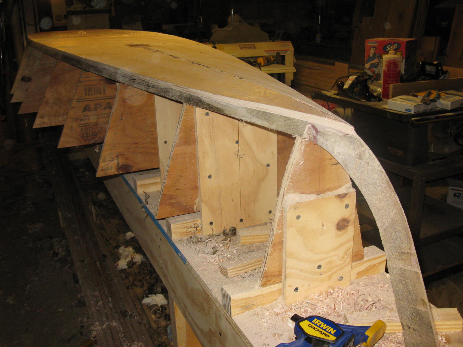

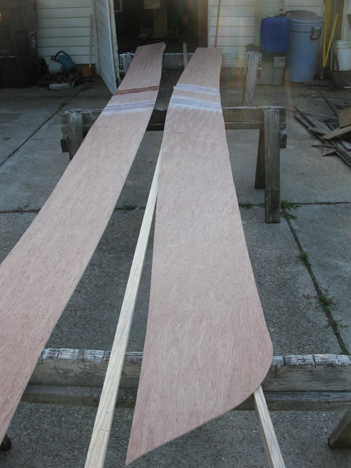

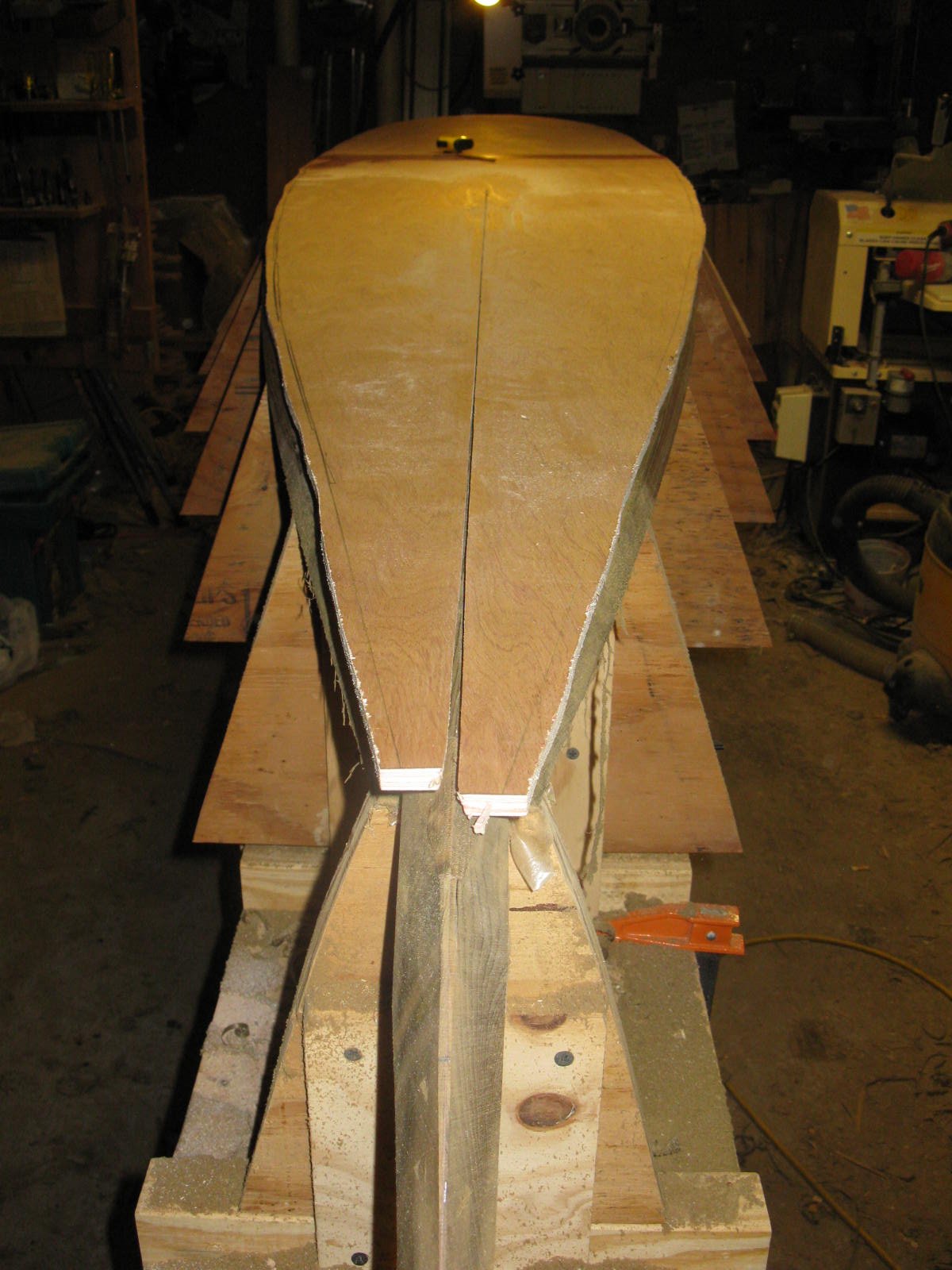

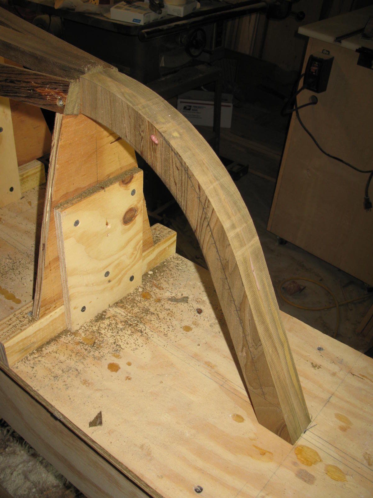

I have been stumped about making the curve stem shape(canoe look)that flows under the bottom. When you built your boat you had to make the transition between the floor and sides with epoxy goop. The floor sat proud on top of the sides and chine logs. My thoughts was to curve the stem pieces under the bottom and but the chine logs up to it. Still left the floor on top. Then I remember and realized why I was confused. I usually put my floor on first and the sides are attached to it. That makes the bottom of the floor flush with the sides. Here are some pictures of a curved (canoe look) stem being built. This on a modified pirogue that has a shallow V bottom in the bow end. You may recognize the boat> I believe it is the boat islandpiper got from swampwood.

Thanks for the pics. I figured it had to be done something like that. He did a good job. Still, way too much figuring and fiddling for me.

The V bottom part would probably not be needed. If you wanted to build your normal method (sides attached to logs and stem first) the floor would be standing proud. A external stem piece (cutwater / batter board) could be fitted and faired to it. Thin strips laminated together in place would probably make the turn with little problems. That is how I fit them on my pirogue curved stems, but if you think that is too much trouble we know the epoxy peanut butter will work.
