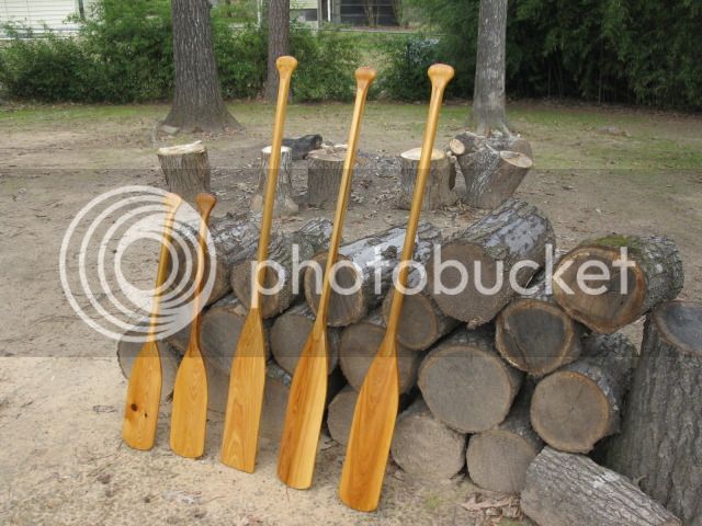

After practicing on some scrap wood I bought some cypress and made these.
I want a shaving horse befor I build any more paddles. Anyone have ideas on what kind, size, or features work best?

Thanks for the link and tips. I like those plans better than the others I have seen. Three things I learned making these paddles that works best; straight knot free wood, sharp sharp tools, and the work piece needs to be stationary. Clamping to a table works, but does not allow for the best angle of work, and the clamps tend to be in the way.
I finished these with epoxy and varnish, but I understand now an oil finish would be easier on the hands when paddling. I don't plan on paddling hard enough for that to be an issue :roll: :)
