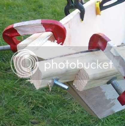

I have been looking at all the examples of UJ pirogues that I could find and wondering whether I could do anything to make the ends of the outer rails look smarter. The usual process seems to be to cut them off and just sand them down at the ends.
I am not building true to the UJ plans anyway, as I didn't order the kit and so my stems actually follow some free plans that I saw which described making the stem in two parts (http://www.lsuagcenter.com/en/our_o...ilding_Plans/recreation/equipment/Pirogue.htm).
Here is a pic of the stem as first fitted:
As you can see it is basically a block with tapered sides (I suppose that technically is a trapezoidal prism!). The outer rails were left long while gluing. Once stuck' I cut them off by following down the plane of the front of the stem block.

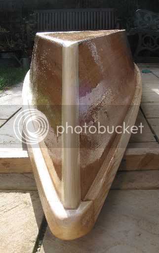

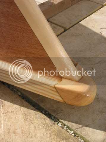

I have now made an outer block which cleans up the lines of the stem and this matches a block above which then continues the lines of the rails around the bow and stern.
These pics were taken just after the saturation coat was applied. I am going to post a different thread about glassing in the questions section in a moment...

Fair point Bearridge but I think the wideangled lens made it look a bit lumpier than it really is. I am impressed with how little the pirogue weighs so far. I will try and get it on the scales before I glass it.

You did a very creditable job of rounding off the prow. With the boat inverted, I was reminded of the rams Alexander the Great had on his boats when he attacked navy of Tyre. "Stand by for ram!"
It is likely the perspective or a trick of the lens, your sides look tall in comparison to beam.
