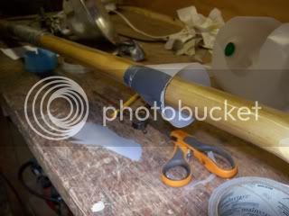

The WW paddle is all but finished-- just needs another coat of spar varnish. The wife and I went out on Lake Verret and I tried it out with some parachute cord tied around each end a few inches down from the blade. It stopped the drips from running down onto my hands, but still dripped on me and the inside of the boat. It seems most of the drip caps I see on the market stop the drip by causing it to drop off before it gets to the paddler's hand. I tried this idea and I think it just might work.
I took the paddle and a flashlight down to the bayou behind the house and gave it a test. Worked like a champ! The water ran down the shaft and into the cup and was held there until I lowered it and allowed it to run out. I'll give it a better test Saturday.

I sure will bring it. This is just the "proof of concept" version. I'll make a better looking version later.
When something like this water drip thing bugs me, I HAVE to find a better way. Like the old blues song says "It's in him, and it just has to come out.".

I'm thinking that it might be easier to cut out a piece from a milk jug like Joey did. A funnel won't be as flexible, and wouldn't fit over the end of a paddle anythehow. It would still have to be cut.
Let me know how it works out?
I wonder if I could fill the drip cup with Scotch, and sip it without spilling any?
