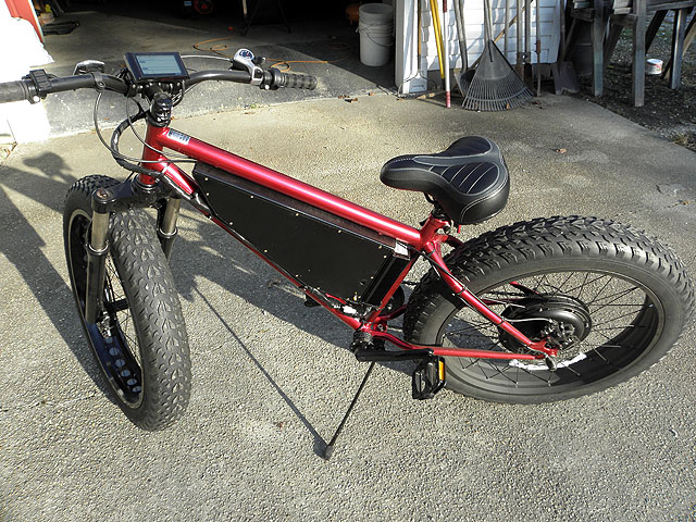

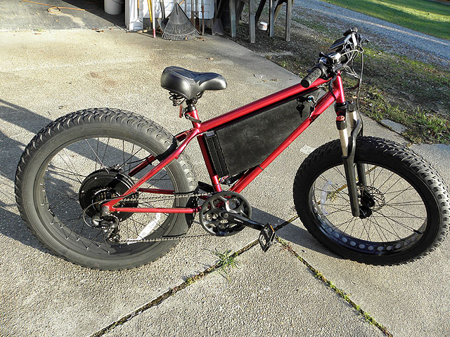

Been building an electric bicycle! 26" fat tire w/ 1200 watt rear drive wheel and I built a 48 volt 28ah lithium Ion Battery. Plenty of power for uphill climbs. The bike runs 15 mph and with a little assist it will run 26mph. 50 mile range on a single charge! Pics coming!

A Mongoose Frame, rear wheel motor, 4" tires,
2 speed front and 7 speed rear.

Observations & questions:
(1) Is the motor encased in the rear wheel?
(2) I like the coil springs on the seat. Have not been able to find seats with springs.
(3) Does the motor act as an alternator when the rider is pedaling without power drive engaged?
(4) Seat height appears low?
(5) Front tire on backwards?
(6) Where did you find the motor?
(7) Where did you get the ideas?

Jack,
The motor is a hub motor, you can run purely off the battery or pedal assist. The program has 5 speeds. The higher the speed the faster it runs w/assist.
You have to recharge the battery. The motor does not recharge.
The seat is set for me, the front tire is on right.
The battery is the most expensive part on an electric bike. I built the box to fit the V, that way I could fit a bigger battery and the bike would not be top heavy. Most people mount their batteries on a back rack. Too top heavy.
You can find all the info you need on the internet and everything was bought on E-bay in the US.
