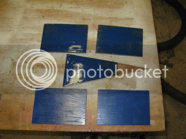

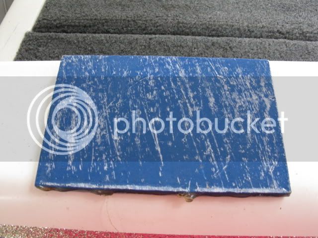

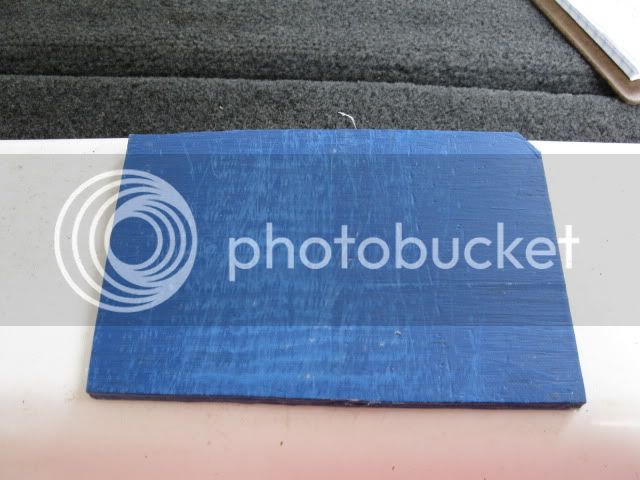

The test expands:
Top two square boards and the triangle one are painted with epoxy tinted with latex paint. The bottom two boards are wet epoxy painted over with latex.
I plan to do a scratch/scuff test soon. The U.V. queston will take time, but what's time to a board.

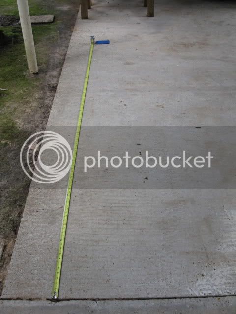

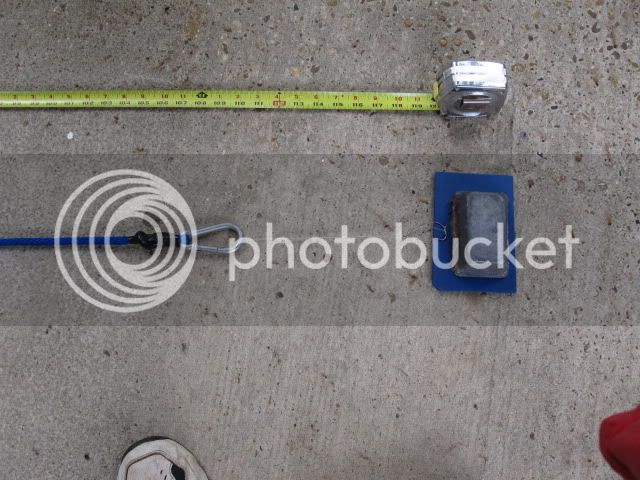

Ran the scratch/scuff test. Very scientific, accurate, and conclusive. I'm sure. :wink:
Pulled the boards over concrete 10' with weight on each:

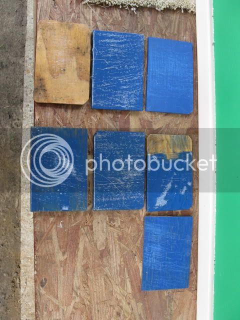

The results:
Can not get the picture to rotate. I hope I get the boards labeled correctly.
Top left = Varnish only
Middle top = 2 coats paint dry/1 coat epoxy dry/ varnish
Right top = 2 coats paint dry/top coat varnish
Left 2ed. row = epoxy tinted with paint dry/no varnish
Middle 2ed. row = epoxy over wet paint/varnished
Right 2ed. row = epoxy tinted with paint/varnish

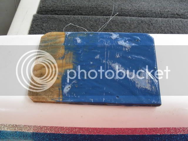

Bottom right = wet epoxy with 2 coats of paint

Observations:
1. 2 coats of paint only is very scratch/scuff resistant, and can be a viable option.
2. 2 coats of paint over wet epoxy did better than paint over dry epoxy.
3. the epoxy tinted with paint and the epoxy over dry paint seemed (looked) to not do as well.
Conclusions:
1. My skiff is finished with only 2 coats of paint. I feel better about its chances of surviving regular usage. A practical
and inexpensive finish.
2. Tinted epoxy (paint or pigments) has potential to be a hard and pretty finish. U.V. protection may be a factor.
3. 2 coats of paint over wet epoxy may be the best choice. The epoxy saturates the wood to protect and it bonds to the
paint. The paint resist abrasions and offers u.v. protection.
4. Epoxy and latex paint bond well together if applied befor drying.
5. All these conclusions are from visual observations. I have no way to measure the actual depth of the scratches.
Recommendation:
1. Get a scrap piece of board and try it befor useing any of these ideas.

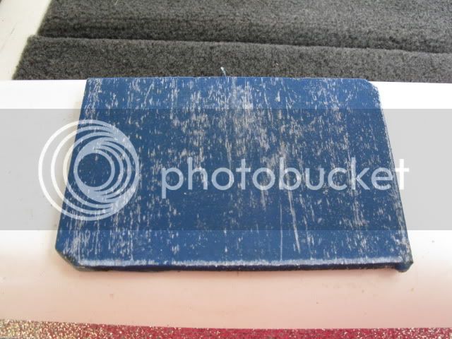

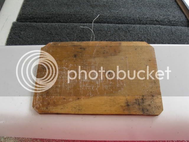

2 coats paint/varnish:
Varnish only:
Epoxy over dry paint/varnish:
Epoxy tinted with paint/varnish
Epoxy over wet paint:
Epoxy tinted with paint/no varnish
I failed to take close up of paint over wet epoxy. I will try to post latter time. It is lower right inthis picture:
