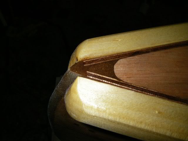

For the ends themselves, I do a sort of exterior epoxy wood flour fillet then sand off so that it is nice and round.
Generally takes about 3 goes to properly fill out.
This pic also shows the triangular piece in the deck you asked me about mate. All it is, is the end pour or I would call it a big end fillet :D . I get the nice even rounded shape using a dremel. :D
