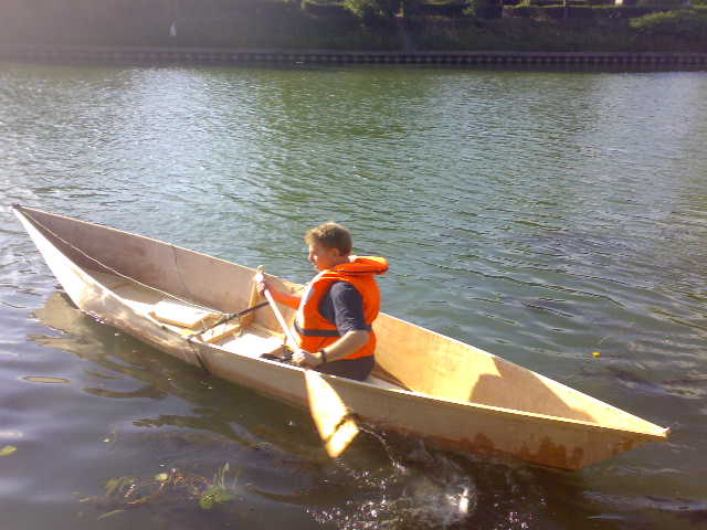

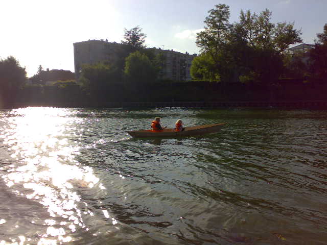

The "Marne" (a river near Paris) was cold, but "the thing" did not sink during the "splash-test" then we did not have to swim :)
"The thing" is a kind of ..."family perissoire"(1), or pirogue, or simple canoe, or dory, or... something else..?
"The thing" is build without epoxy (my parking box is too cold) but with polyurethane glue(Sikaflex pro 11FC), in exterior plywood (5mm) with a first coat of G4 (kind of varnish polyurethane) on the bottom.
Lenght is 5,02 m, width on bottom 63cm, actual weight <~20kg (but I think it will be ~35kg when all finished). Actual cost is ~200 € (I just need to buy the paint), and build time ~25h.
Now it will be time to put seat, external stern, rails, foam, an other global enduction with G4... and paint when my 10 years old daughter will make her choice about the colour :)... (there are some other things to do but I forgot the "english" name..!).
Later (but before hollydays time, the 1st of july..!) I will (must!) do 1 outrigger for sailing "the thing" with my wife on the sea (near shore!)... but I don't know if I will go from France tu US in "the thing" ;-)
And "the thing" will have a new name after a family ballot...

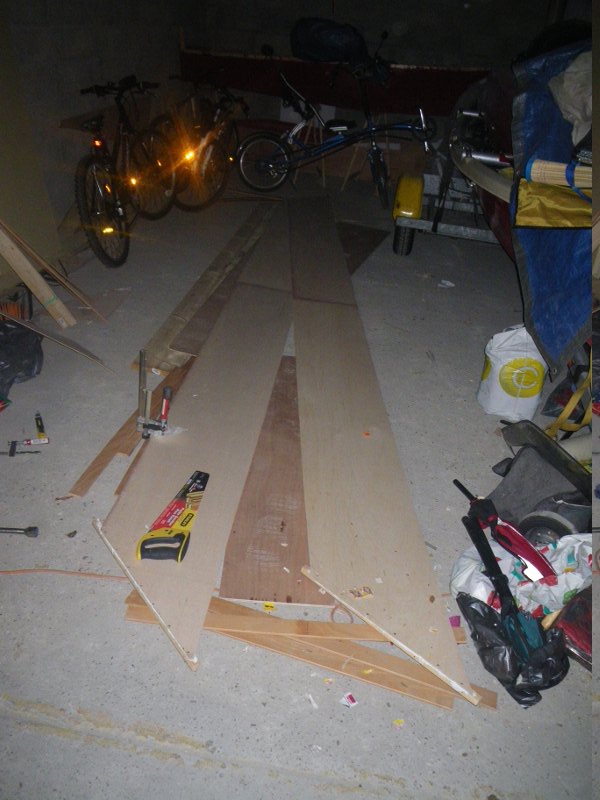

(in the first one (2009/05/11) you can imagine my "car-box" is full of boats, bicycle, and light... It's true for boats and bicycles... but the only light is the flash of the camera, and there is no electricity in it... I worked with a little camping battery powered head lamp :-(

For the "belt thwart" nobody try it as seat, nor as kneeling thwart :) It was not because I had question about my glue, but it was the simplest way to attach safely a line (only inner sterns at that time), and I look the boat alone in the water to be sure she does not sink before trying it (water is cold in Marne;-)
I, and my daughter, were surprised how stable she felt , even in the waves of some big barges! And the high rocker (~9cm) does not affect too much her tracking ability (I am a canoeist and dinghy's sailor for "few" decades - more than 40 years! - then it is not a completely novice feeling)
