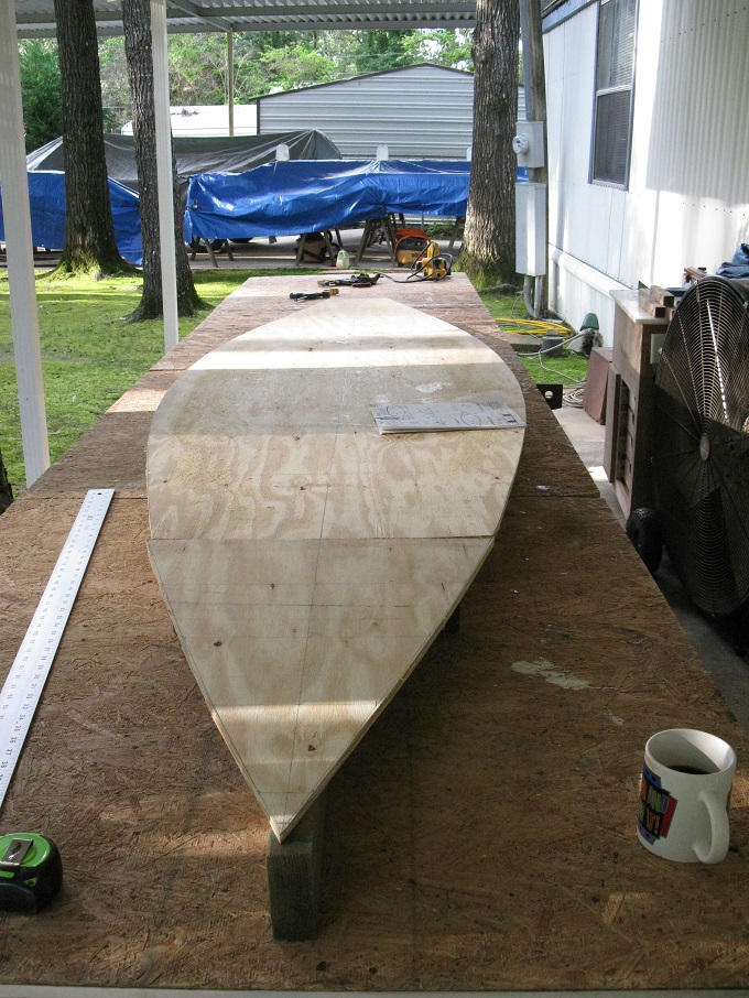

The first boat I built was a "Gator Boats" Croc model skiff. This is their smaller version "Gator" model.
My goals were to build by the plans to see how long it would take, and if any "improvements" could be made.
6/02/21
2hrs. cutting chine logs, gunnels, etc.

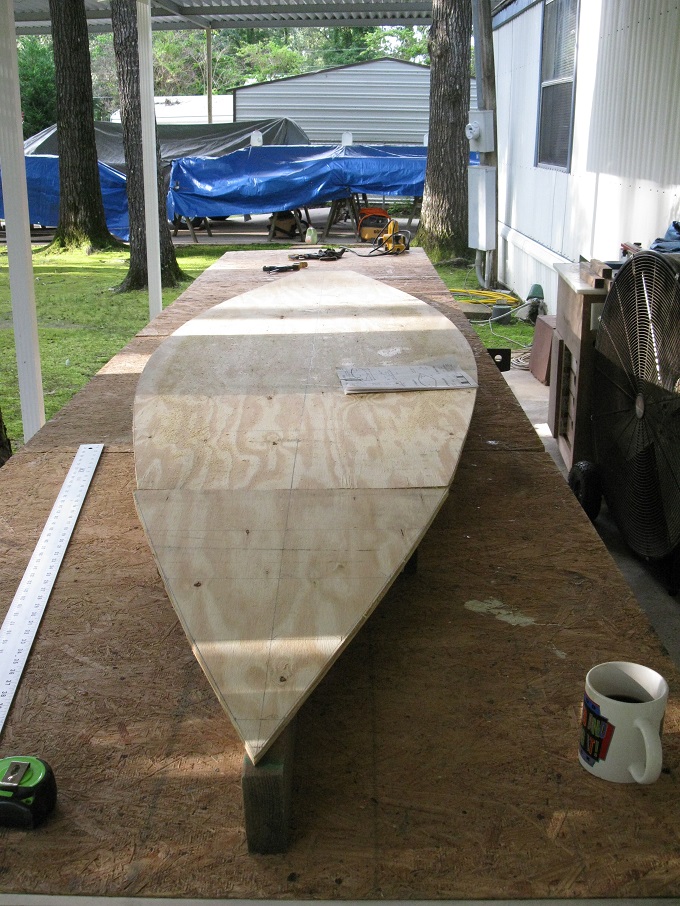

3 " marking, cutting and trying to fit floor to the logs
1,911

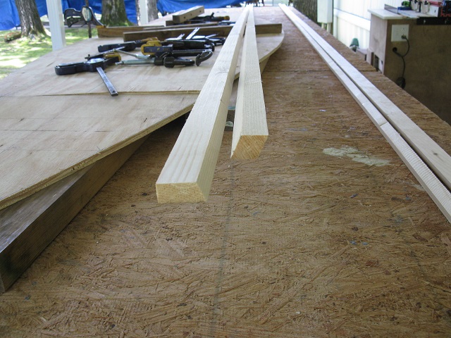

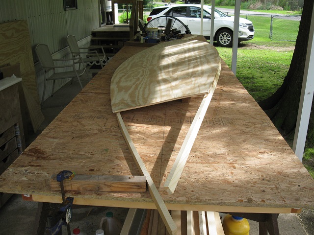

First lesson learned was; If you are building with plans, follow them. I cut the chine logs shaped and sized the way I normally do them. They did not want to bend around the shape of the floor. The boat's floor beam is 30" and is only 10' long. Plans called for ripping a 1" X 4" to make two logs. I did not have one so I did what I usually do and cut them from a two by something board. Had to redo that. The chine log on the left is sized according to plans. Mine is on the right.

6/03/21

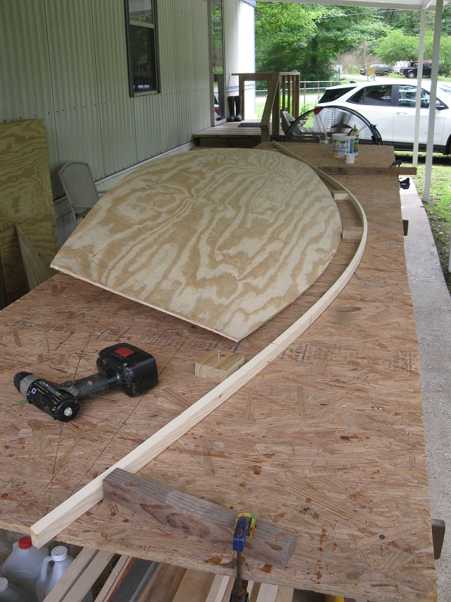

6 hrs. cutting the chine logs again and attaching them to the floor. Easy, once I followed the directions.

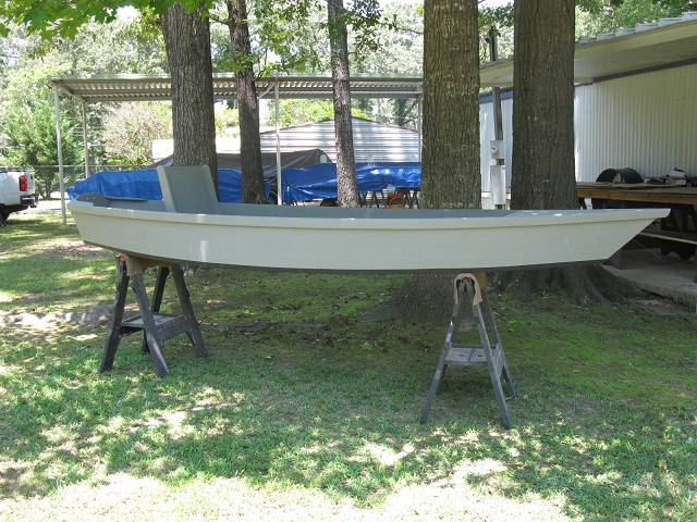

Another lesson learned; Made the side rails 1/2" thick not 3/4" liked the plans called for = not stiff enough. Added a top rail/cap and that corrected the problem.
6/15/21
61 hrs. total invested and the boat and seat are finished.

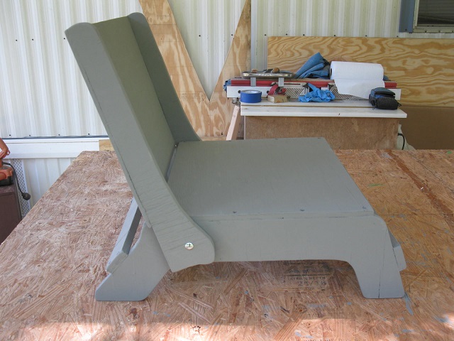

Seat made from scrap plywood. Not pretty but cheap and it will work.
