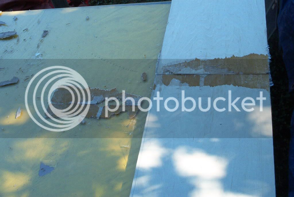

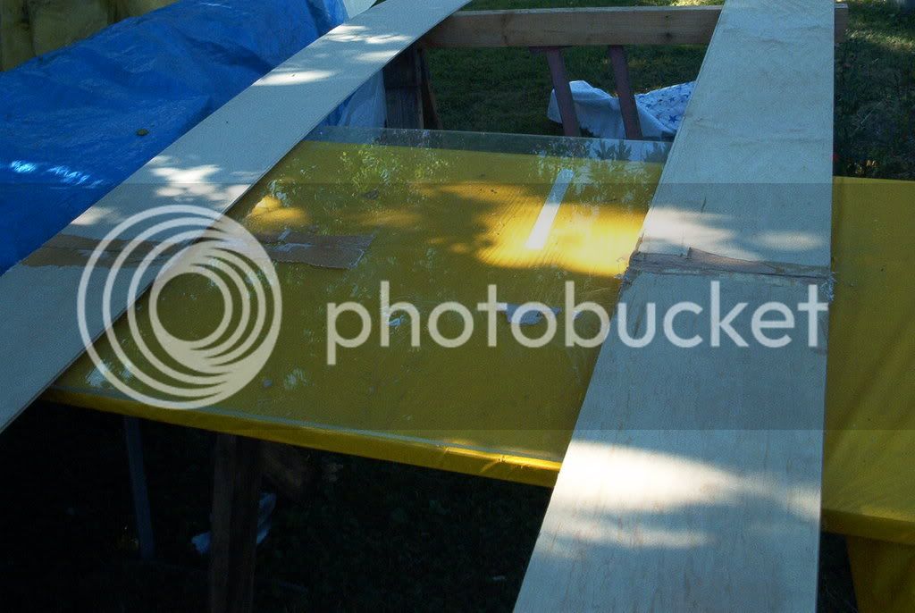

Yesterday I had time to butt glue the two side panels together and put them between two pieces of plexaglass. Well, this morning I went out to see what they looked like and found out that the epoxy had glued itself to the sheets of plastic. When I separated them from the plastic, the plywood separated and left half the plies glued to the plastic. I have a great butt joint but minus half the layers of plywood!
I guess I have three options: Cut out the damaged sections and re-glue and have a 12 foot piro or build up the area with more glass and paint the outside( it looks terrible now) or put a backer plate (right name?)over the damaged section.
I am not sure where to go from here. Any suggestions on what went wrong and what is the best option. By the way, the strength of the joint is amazing with only one layer of cloth.

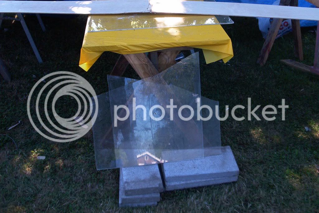

Thanks for the suggestions, guys. But I think I had too much weight on the plastic sheets. Chuck said he uses a light weight and I had two concrete blocks on each piece of plywood, so I think that was the problem.

Seedtick: Aha!!! This is old plastic sheets that have been laying around in the storage shed and they are beat up pretty bad.
TX RR and Piper: I am going to cut out the bad sections and re-butt them tomorrow morning. My 16 footer will now be a 13 footer!

Is it posible that there is another material that appears to be plexiglass but has entirely different properties from plexiglass that you used. Don't know but was wondering about?
You might be able to correct the problem by mixing up some wood flour and epoxy to fill in the damaged area.
I would suggest trying it before amputating all of that wood and having a shorter boat.
When you glass the boat the filled in area will be covered with the glass. I have filled in voids with the epoxy and wood flour mix and it worked for me , nothing ventured , nothing gained or lost. I have even built up some areas with the mix and they worked perfectly.

Matt: It's 5.2 mm luan from Lowe's. Maple on one side, birch on the other.
Jack & Wannabe: The plastic is polycarbonate(lexan). It's used for windows and doors. I replaced the window in my aluminum storm door a number of years ago because the wind broke the glass. I bought a full sheet. It's been in the shed ever since. As you can see, I actually broke one piece in half trying to peel it off the plywood. It's 1/4 " thick!

I used new plexi when I made mine....my friend used the same plexi building his with no issue. I may pick up an aerosol can of mold release to spray on the plexi before I do the next boat. I wonder after it gets scratched up just like the Tick said is what may be the issue. ....I'll bet you was sick when that happened.
