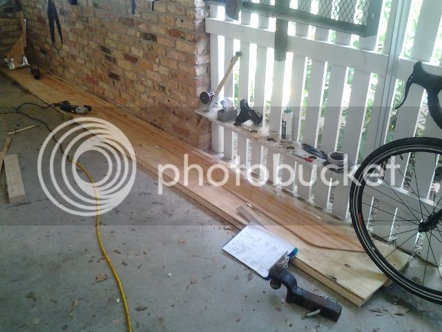

Hey Guys. I got a little bit done this weekend. Cutting strips again, glued the first panel, lay-out and trimmed. Now it is time for another decision and question. I have seen that at this point some folks dribble epoxy into the glue joints, some glass the entire panel, and some just install it on the boat as is. Right now, I plan to dribble epoxy into the butt joints and glass about a foot in the middle and on each end. The build is going to be slow, so imagine this thing stored on the carport for a few weeks or months. Any comments appreciated?
Thanks
Dan
Dan
Glass the whole thing or glass nothing , I didnt glass anything before I assembled the boat.
You will create hard spots just glass part of the boat.
Epoxy the glue strips , that makes sure they will hold for you.
If you are going to have the panels laying around for a while I would epoxy saturate them to seal them from the weather. You will have to give them a light sanding before you glass them or get around to glassing them at a later date. The epoxy saturation will raise some of the woods fibers and form what I call whiskers and a light sanding takes care of them later on.
The epoxy saturation will let the panels bend to form the shape you want for the boat , glassing the panels will offer a lot of resistance to them when you want to bend them to the boats shape.
No matter which way you go , make sure nothing with any form of oil gets near them , containers , liquids , sprays , dirty rags , NOTHING or you will have some spots that epoxy and glass will not stick to. Alcohol usually gets rid of the oil residue but you don't know it is there till you see the dimples in the epoxy where it refuses to remain.
Chuck.........

Thanks for the advice Ron and Chuck. Yeah, wasn't sure about using the glass, but I don't want it to come apart. I think a coat of epoxy may be the best way.
Thanks again. This panel has to move so I can build another.
