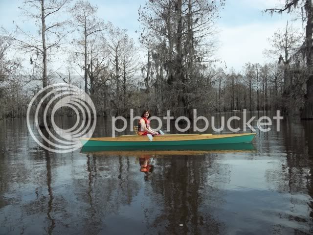

A few months ago I was reminded, that I had not built my granddaughter a boat. So ...
She liked it:

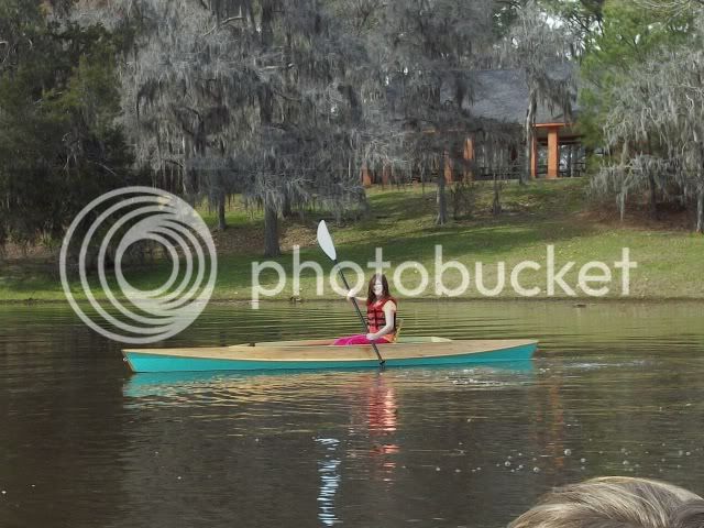

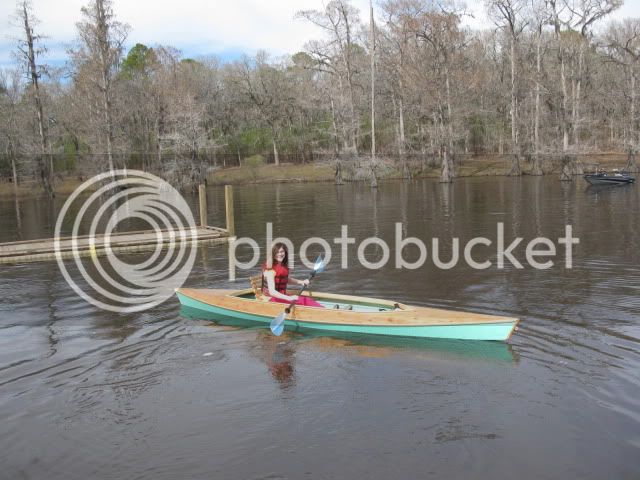

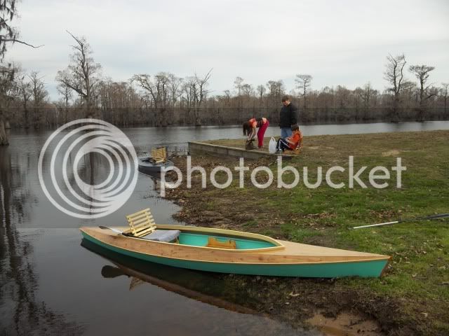

Maw Maw Bee shuttled the boats and us to the lake for the maiden voyage, and a shore snack. Brother went along as technical advisor.

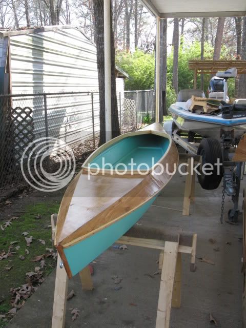

Thank's guys. This boat is made from "sow's ear" material. I don't think it rates being a "silk purse", but it turned out ok, for what it came from.

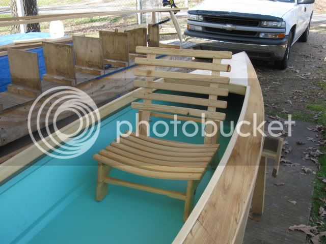

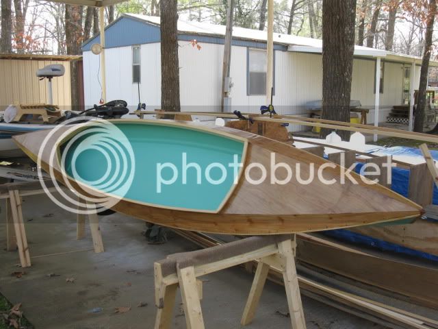

2 - 22" cut offs of 1/4" BC pine plywood for the floor
2 - $ 5.00 each sheets of bargin bin Luan
Left over 1 X ? pine boards
Stems and batter boards made from pine and white oak Swampwood and I logged, and milled ourselvs.
1/2 quart left over varnish
1 - $8.00 gal. of returned paint. Lady at ACE remixed the color for us.
Maybe $5.00 glue and ring nails.
Total cost less than $75.00.
