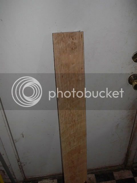

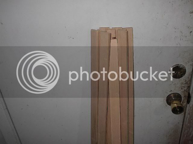

Found me a 2 by 6 that looked pretty good

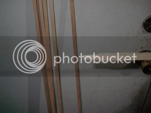

sawed it up in strips

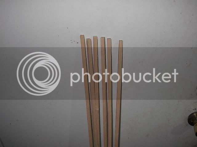

Then sawed it up in some smaller strips

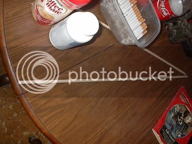

ground one end round

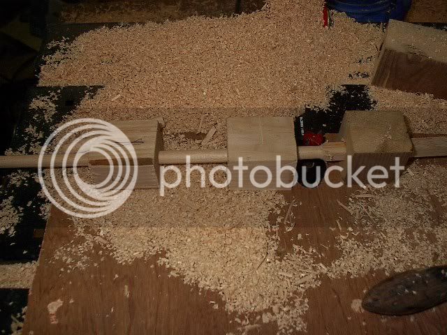

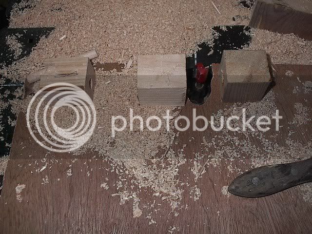

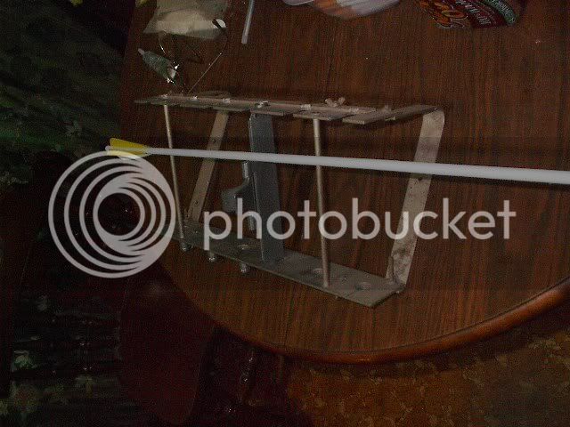

Then I sat down and thrue a little jig together for my router table
Ran the small squares thrue the jig
and wound up with this

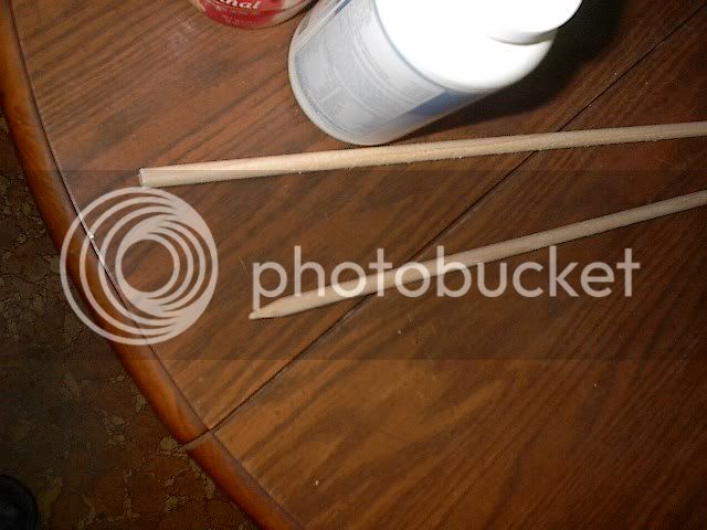

cut them to length,straightened them then cut a bevel on one end
Well you figure out what it is yet. More to come later

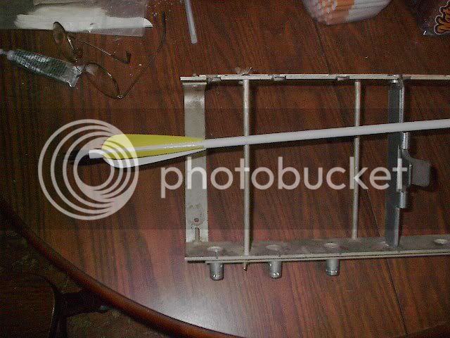

Maybe this will explain it better .
Add a little paint

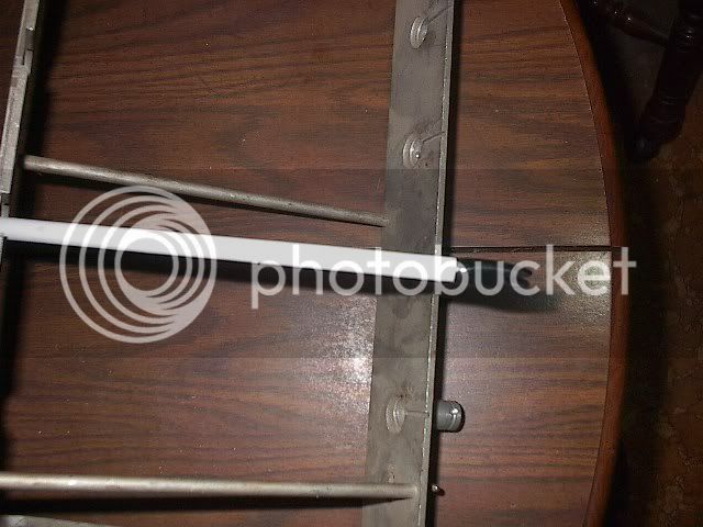

A little plastic
A little more plastic

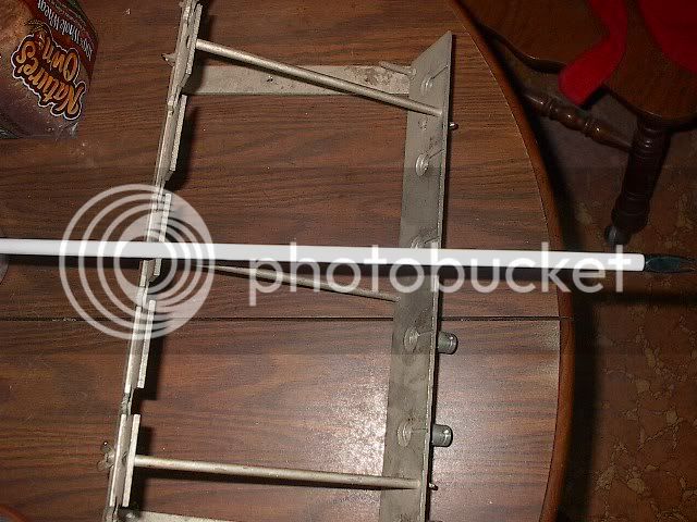

and you have this
A finished arrow, You can take a 2 by 6 8 ft long and make 72, six dozen arrows, they shoot good.
I hadn't made any in a while so I geared back up. I usually put 38 hulls on for blunts,they make excellent bunny squirrel snake arrows,put a broadhead on them and they will take whatever you want to take

Ron,
Speak to me about your router bit and the jig set up please.
Specifically, how the block work with initially square wood being turned into round.
enquiring minds NEED to know. :D
Bloody nice work BTW
Mick
I will try to explain how it works
cut the squares big enough so you have no flat spots after they are turned.
the first block hole size is a snug fit around your square.
then comes the router bit, just a straight bit ,you adjust this in and out to get your shaft size
second block is the size you want the finished shaft
the third block has the finished shaft size hole also this just keeps the shaft straight.
The end that is ground round fits in a drill.
turn the router on start feeding the square wood into the first block while spinning it with the drill. as it spins you feed it past the router and that turns it round
I hope that explains it
If not tell me and I will try to explain it better.

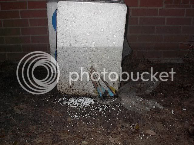

We shot some of the pine arrows we finished ,put a 45 acp hull on the end , they buried up about 8 inches in 2 lb foam out of a 50 lb re curve,then Darrel shot a piece of concrete didnt bust the arrow but hit so hard the nock flew off.
The pine are ok but I think the fur is better.

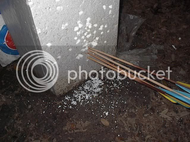

Put some field tips on a dozen of these shafts today and shot for a while,They were grouping good and hitting hard .
I was shooting my 62 inch 55lbs at 28 inches pse Sable take down. With my 31 inch draw I am pulling around 70 lbs. Might just have to try some of those Javies out with it next week.
