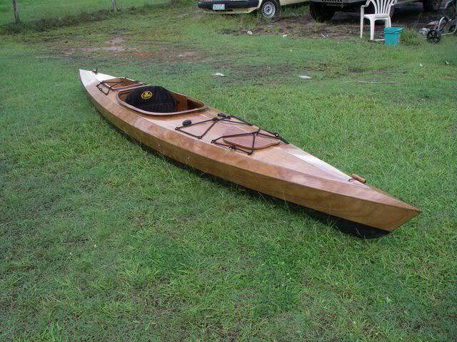

Just finished her today 8)
Taken her for a lil walk in the morning.

I think this design will make a very good cross-over boat. More capable than a purely recreational kayak with styling approaching that of a smallish sea kayak and similar qualities.
I liked the original Okwata Matt designed and bought the plans some time ago. I have been studying and comparing the drawings of both boats and am confident that this one will prove superior in every way.
I wouldn't be at all surprised if Matt recieves requests for longer and shorter versions of this boat. I really like the false rocker in the bottom that has been achieved by very clever design work. The keel line has minimal rocker to facilitate straight tracking and the extent of the tortured ply bottom panel in the ends achieve very fine entry but at the same time will allow the bow to pierce the water like a spear and the stern will realease with minimal drag.
My biggest problem will be keeping mz Robin out of this boat. She has been known to steal MY boats before. :D

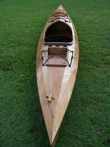

Is that the natural color, or did you stain it? What kind of wood is it?
G'day Mike, It was sole to me as Gaboon, BS1088 marine ply. I have been told it is identical to what you call Okoume (SP) and comes from Africa.
Not stained mate, that is the natural colour after epoxy. I really like it but the mob I was getting it from have sold out to a Malaysian concern and they no longer stock this ply. I got their last sheets and some were damaged and scratched in places but it is only cosmetic.
The BS1088 ply we can get now is something they are calling Pacific maple. It is heavier than the gaboon and has a tighter more cnsistent grain appearence. I don't like it much and much prefer the more open wavey woodgrain look of Gaboon.

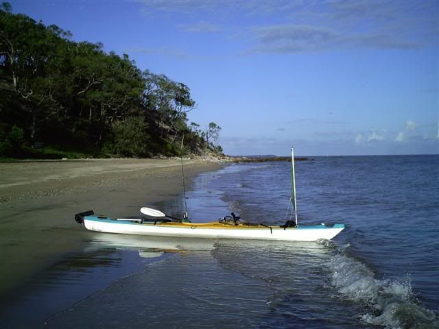

I fish from all of my kayaks end canoes and rigged Okwata similarly. When I first started fishing from a kayak, I used one of these,
http://www.natureline.com.au/osprey.htm
a smallish sea kayak - very fast and a hoot to paddle but I got wet more times than not just getting into it. Steep to bank - forget about it LOL

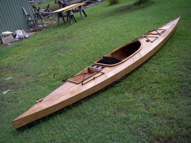

Speed, Okwata is just about as fast as either my Osprey or wanderer.
That is to say, very fast indeed.
Stability, Allways a complex thing LOL but Okwata is way more stable than Osprey or Wanderer, in fact, she felt more like a mermaid, which is very good. :D
Maneuverability, Not quite as good as my Laker but way better than any of my natureline boats. also very good.
Tracking, superb. This boat needs no rudder.

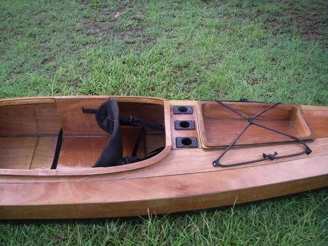

Comfort, I built into this one a laker style seat and padded it with 1" high density foam. The boat fits me like a glove. My knees tuck in nicely under the side decks and there is plenty of room for my US size 13 feet. I am 6' and 200 pounds. I am confident I could stay comfortably seated in this boat and paddling for many hours at a stretch.
Storage, She is a 15 foot, recreational, touring kayak. that just happens to be very much like a smallish sea kayak. :D For such a boat, the room in the front hatch is huge. rear hatch is also very good
As I get time, I will work up a proper review but the short version is thas is yet another stroke of brilliance from Matt. I bloody love this boat so much, that I paddled myself to exhaustion today and still wanted to keep going in her. I would have no hesitation in recommending Okwata to anybody looking for an exceptionally good, all round kayak. One they can take in skinny water easily but also one just as capable for several days paddling and camping or even for the occasional sprint across the bay or lake.
She will leave many store bought kayaks in her wake while at the same time, be stable, predictable and safe enough to let less experienced paddlers have a go.
As much as I love my Southwind, Sasquatch and Laker, i have a new favourite boat - Okwata. :D
