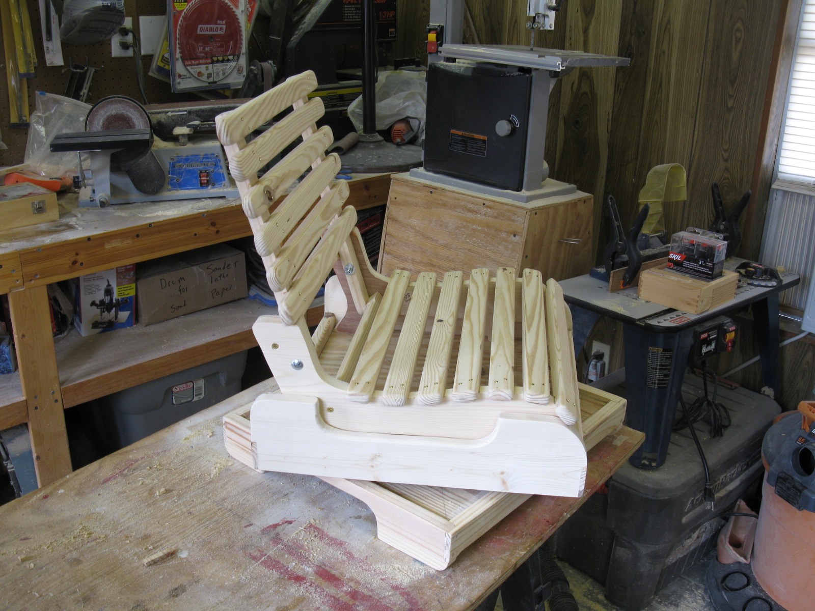

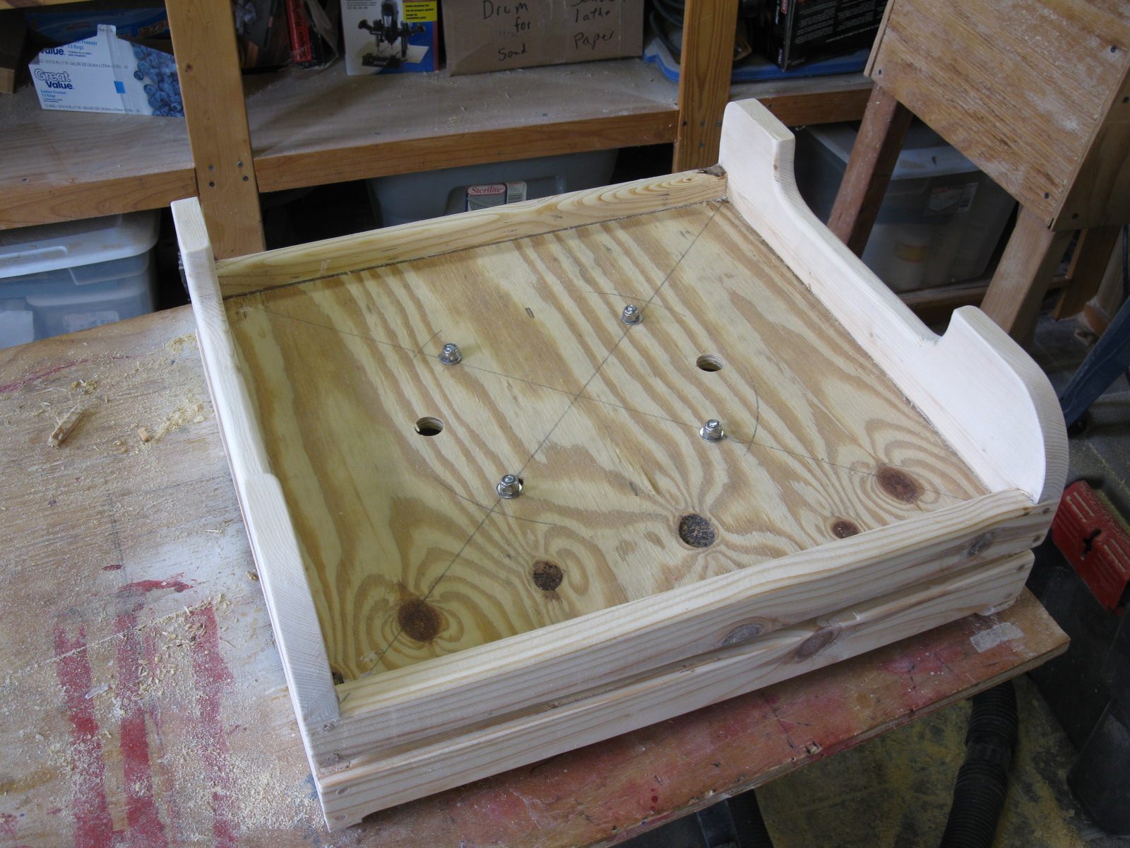

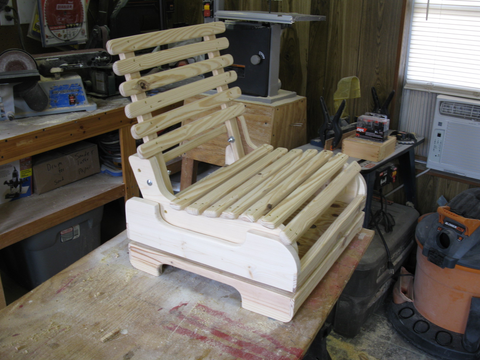

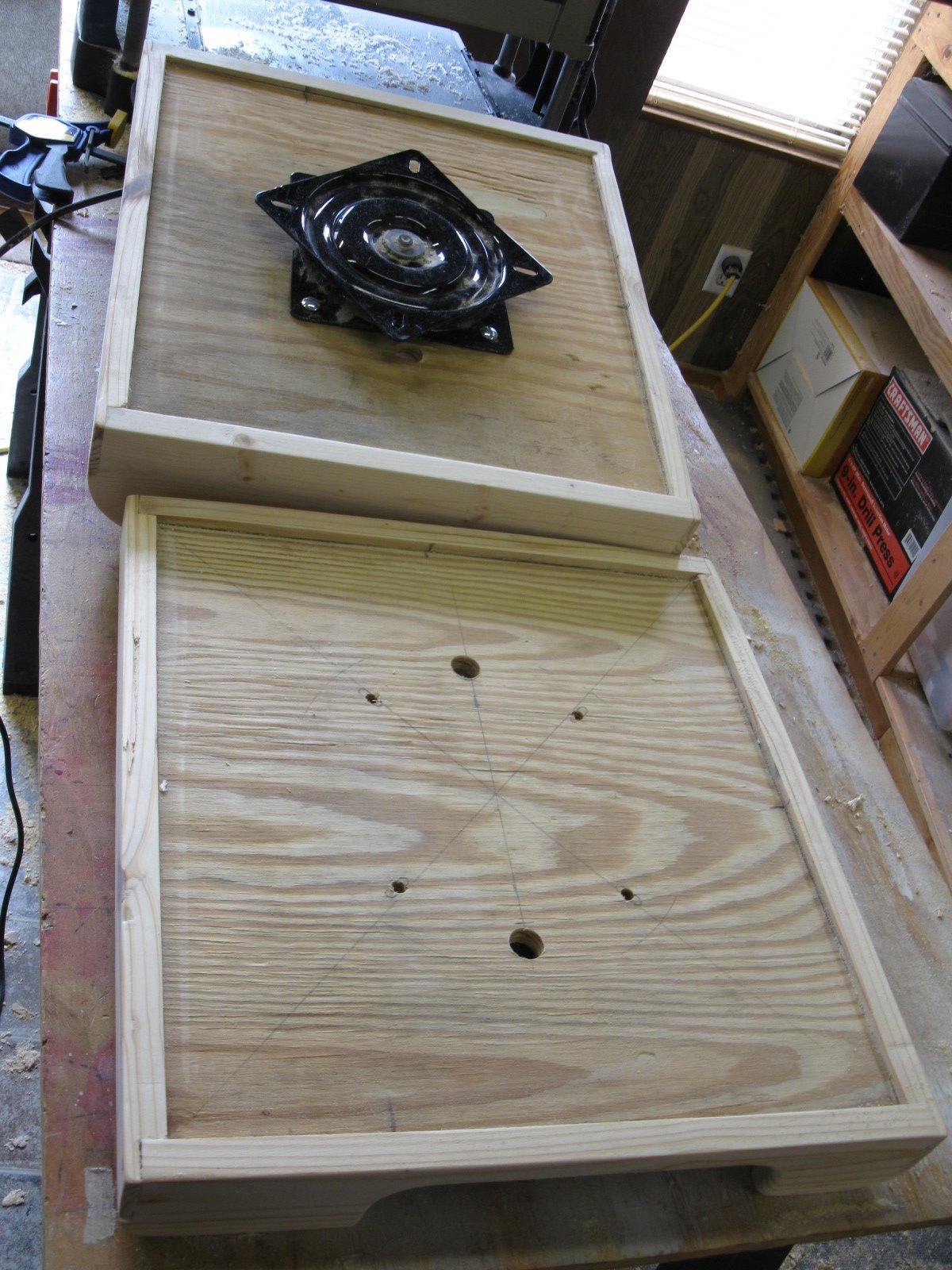

The seat I have and might use is mounted to a metal pedestal post/pin with 4 screws into the plastic seat base. I'm not sure if the screws will be long enough to use back, but I will figure something out.
I had a seat that swiveled in one of my first boats but did not care for it when paddling. It seemed to twist with each stroke. Might work for you.
1,912
That would work, but I have moved on to other seats. Andy may like the swiveling feature. He will have to go to know.
