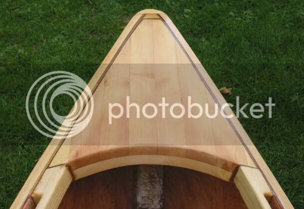

I have fitted pine breasthooks which I have faired to match the camber of the rails.

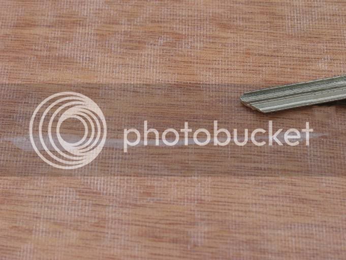

One scratch

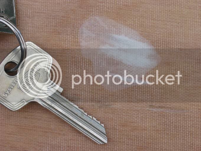

and one larger patch
It looks like the glass has delaminated from the bottom. How can I repair this and how worried should I be in terms of how the bottom will behave in use?

Unless I am not looking at it correctly it appears as though it needs a coat or two more of epoxy to fill the weave.
To me it looks like some of the glass has not been impregnated with the epoxy and is still white and not clear like soaked or treated glass becomes.
You might say the glass looks like it is epoxy starved. If the glass has delaminated , the only thing that I know of that causes that action is some form of grease or oil on the wood which would not let the epoxy into the wood.

Beautiful woodwork Steve. As for the glass, even though it is extremely painful to be agreeing with him, I believe Chuck is right. You need to sand out that white spot and re-glass it, then, apply another coat of epoxy to fill the weave. How long did the epoxy set before you varnished? Did you wash the surface and scuff with fine sandpaper before varnishing?

Ha Steve, I dont do much of that glass stuff BUT, I agree with chuck and BB. more epoxy and wash/ sand ( you need to wash before sanding to get the blush off without being air born). what epoxy are you useing? and no to that 3 day or 3 week wait stuff ( that was what they did in the old days ) and yes your boat look very good, nice work. later keith

Re the fibreglassing, I agree with Chuck and the others. Your woven matt is resin starved. All the literature I have read reckons that you should be able to completely fill he weave in three coats.
I use very light weight matt and still can't fill it in only three coats. Perhaps I am doing something wrong - or screeding too hard, I don't know. What I do know is that when your last coat of resin goes on and sets up, the surface should be glass smoothe with no sign of the matt to feel or to see. It takes me about 5 coats.
Re the de-lamination, Sorry to say mate, but the lamination of glass-ply-glass in an integral part of the strength of the boat. The de-laminated part of the glass needs to be competely removed and then that area needs to be re-glassed.
The more I look at it the more it appears to a shortage of epoxy. The clear areas is where the epoxy filled the cloth the white lines are where the epoxy did not fill the glass.
Before doing the whole boat over ...... I would take one area (small) and try some more epoxy on it and see what happens. If it clears the area up and makes the glass disappear then you have the answer , if it doesn't then you have a lot of work ahead of you.
On the up side , I don't think the glass delaminated on you , I think it just needs more epoxy to fill the weave. The reason I say that is because you don't have a white bubble (blister) under the glass which means the glass did not stick to the wood. You can see where some of the glass stuck ( the lower part of the weave in the glass ) but the top weave is not filled.
I wish I could see it in person then the guessing would be over with and we would know for sure. Try my idea in the bold print and see what happens.

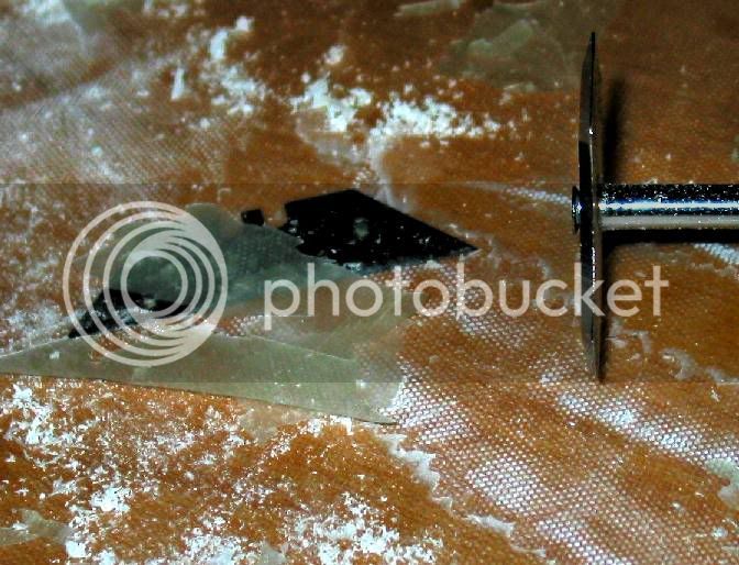

Thanks for your thoughts and suggestions everyone. I did try to explore the damaged area and found that the layers came apart with little or no resistance. The inside seems sound by comparison.
The glass is two layers of epoxy down and yes I had real trouble getting it to wet out at the time.
I popped into the local hardware store in town and bought a scraper. A quick scrape over the surface and this is the result.
Nasty, even though I say so myself. It looks like I am going to have to scrape the whole outside down to the glass, possibly back to the wood. The scary thing is that even if I have the time/money to do it, I don't yet know what I did wrong the first time. There seems to be almost no bond between the layers of epoxy, even though I sanded the whole thing with a RO sander between coats.
