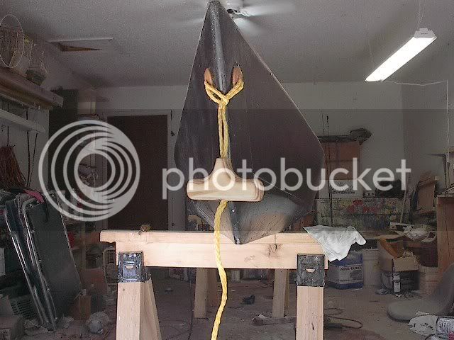

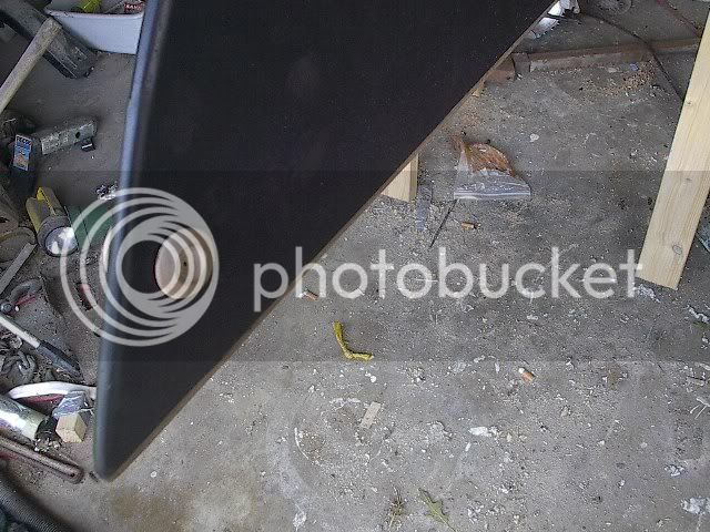

I put the holes in stern and bow like in the plans but I just didn't like the look and the edges were sharp I worried about it cutting the rope when I was hauling yak or tied up on river.

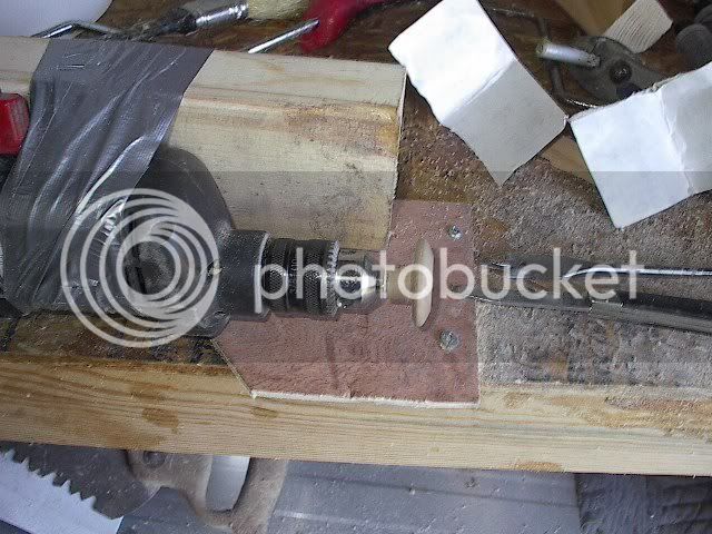

I got to thinking( Jack don't say it) and went to hardware store bought 4 wooden knobs. I took a drill and threw together a little temporary wood lath to shape them.

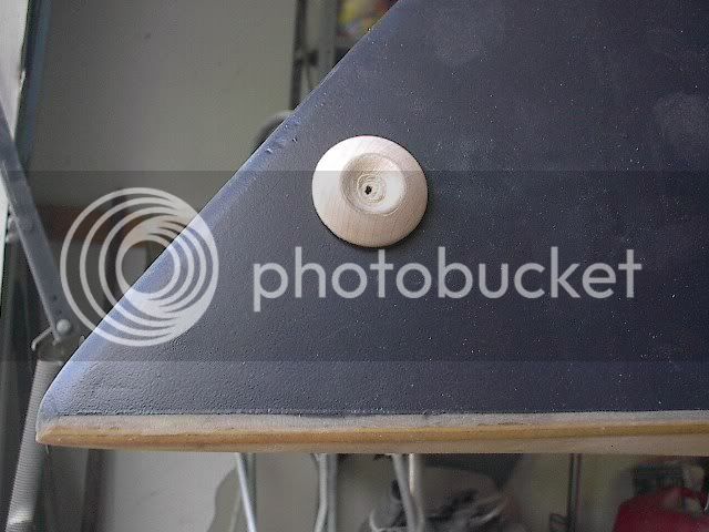

Mixed some epoxy and mounted them in hull, this is before holes are opened all the way Thu
another angle

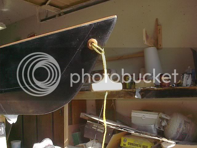

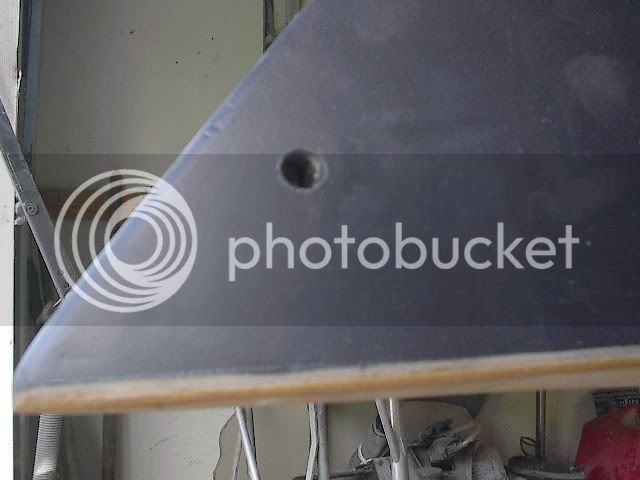

After drilling out holes and tapering them so they were smooth I took some of the scrap plywood and made 2 carrying handles. They were made so I could double rope and it wouldn't slide or wear on boat but my
line on the front could continue on as long as I wanted it.
The light is to bright but you can get the ideal of what I did
I like the way it turned out.
