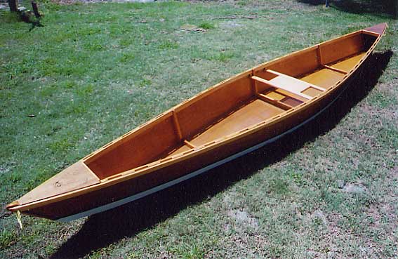

My 1st one........of many. :D 15 1/2 feet ..1/4 inch Luann , seams taped. The cost to build this one was a lot less , no fiberglass , just epoxy saturated and varnished.
Hopefully some of the guys who have just made on will furnish the up to date information.
Hey guys......there are no national security issues here, make a guess, OK?
Hey Chuckmeister: looking at your pic there it looks like that seat may be just a mile or so too high. Am I right?
I like to be about four inches off the bottom, not four inches down from the top. 'Course, being a little "light headed" would help. :D :D
My 1st one , Yep a little high but with a few minutes in it , no problem.
Remember I started paddling a boat at a very young age , very young. Even before I had a bicycle to ride. Guess Dad thought if I could do that a bike would not be a problem. For some reason that just held over the rest of my life.
Paddling a boat , that is , the bike I did take a few spills on. :lol:

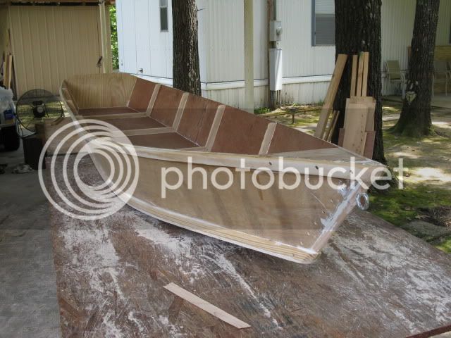

Don't know if this will help with the cost of an U.J.. but my firewood boat cost was approximately $114.20 befor painting.
Aprox. cost because taxes were not calculated. Some supplies had left overs. I did have to buy an extra sheet of plywood ($19.79 that is included in the $114.20)because my boat is wider than a pirogue. I used (please forgive) screws and S.S. ring nails (328 of them), and no epoxy or cloth. 1.5 gal. of paint $22.00 would have been plenty. I made the mistake of under estimating how thirsty Luan can be and bought quarts, also changed the interior color one time.
