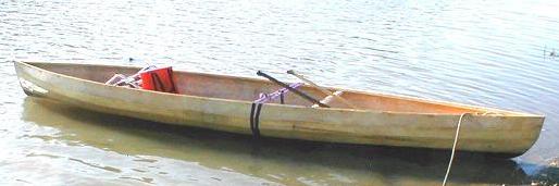

Installed a couple of temporary thwarts on the JEM S&G canoe this morning and went paddling. Very happy with the design. Primary stability is good and secondary is like a rock. Paddles well, turns easily. No cavitaion noises.
Best thing, IT FLOATS!

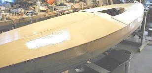

Hoz,
Your foredeck will be a long one. On my kayak, befoer installing decks, I buried a short hank of rope in the end pour and tied on a small pulley. I ran a circular rope (up through the pulley and back, tied off in a square knot). On this, I seized 30" of 1/16" stuff to tie around what ever goes in first. Easier retreival.
I added white pigment to the epoxy for the inside of the boat. Can look up under the decks and easily see if anything is remaining.
I now wish my kayak was a bit wider, say 27", and cockpit a bit longer, say 4'.

Some more pics of Hoz's great work.
I realize that hull configuration is a bit different, but what I see is a strong similarity to a Zephyrus. PARTICULARY when it comes to use. This hombre will roam the outback for weeks on end, take rough water, portage easier than some boats, and serve as a "home away from home".
If a guy took one of these boats, a Hennessy hammock, a Cooke rainfly, vittles, and two pairs of socks, he could live out there a long time.
Hoz, you might be interested in roaming Killarney or Lake Superior Provincial Parks. Lake Superior Provincial Park country looks very much like the Boundary Waters.
I suppose, that if a fella was hard up for pretty places to paddle, and just had to, he could paddle one of these beauties down South too. But that'd be a waste of a precious boat. Kinda like taking your sister to the prom, ehh?
Jack it has a very similar cross section. Differences are this one is shorter, a little fatter, and is asymetrical.
Hoz said it performed great. I'm tickled pink at the way it turned out.
Hoz provided some awesome insight to simplifying building and as you can see, the boy knows how to build a fine boat! 8)
Cutting it loose soon as just an open canoe. The decked sail option later on.
In case anyone was wondering....I was...the purple straps were for portaging. Hoz just decided to leave them on while he paddled.
