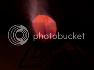

It's time to give this chunk of steel a soul. While the propane furnace comes up to temperature, I heat up the quench oil to 120 degrees F.
It's kind of strange that 120 degree oil cools the blade faster than cold oil. It has to do with effecient heat transfer.
I get all the other things ready for the treatment-- a flie to check for hardness after the quench and wet towel on the right to cool the edge of the blade while tempering.
The blade goes into the furnace for 10 minutes until it becomes that beautiful cherry red color.
When the time is right, it comes out of the furnace and goes directly into the quench oil.
Amid fire and smoke, a new weapon is born. 8)

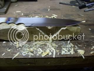

I did my usual torture testing of the blade. Doesn't go out of the shop unless it passes. This one passed with flying colors.
No nicks or dull spots in the edge. Still shaved after test. Jack, she's shaping up to be a good one. I have the handle scales expoxied on and curing. Will start shaping the handle tomorrow.
38
Jack, that test will tell you a lot about a blade. If it's not tempered enough it could chip out, if it's tempered too much , the very edge could bend over. It also gives you a good idea if the sharpening angle is correct. It also passed the end grain slice test. I cut a thin shaving off of the end grain of the board. If the edge is the least bit dull, it just crumbles the wood fibers.

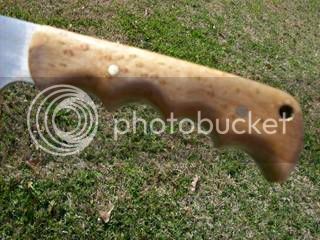

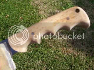

Sanded the "saturation coat" of TruOil.
Rubbed on another coat. The grain is starting to fill nicely.
This is how I dealt with a little bit of sap wood on the bottom of the handle. Tried to match them up from side to side. Hard to see but it is the light color "V" shaped area at the bottom.
