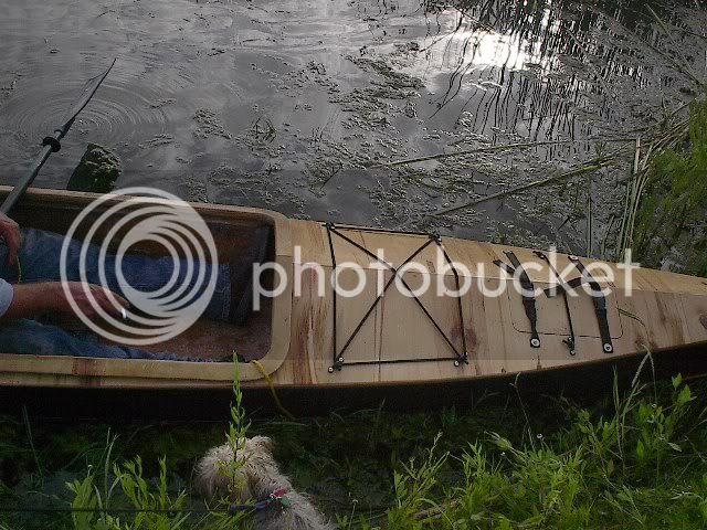

One way to make hatches almost fail proof is to replace the springy bungee cords with cord and good knots when going out into rough seas. That should stop any possibility of losing hatches.
Yes and no, Joey. A bungee applies pressure to a hatch, and works to squeeze it up against the gasket, thus aiding sealing. A rope will not apply that pressure. A rope will, however, limit outward travel of a hatch at a pretty specific point. A bungee will allow a hatch to travel outwards quite a lot before the elasticity overcomes whatever pushed out on the hatch. A combination of BOTH bungee and rope would serve to (1) seal the hatch, and (2) limit outer travel.
