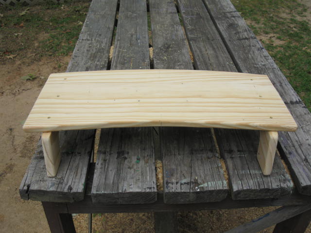

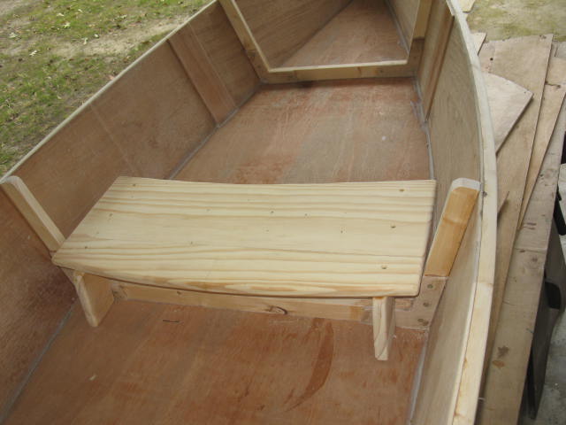

I did not want to invest much more time or work into this project so I built this simple seat/bench.

Chuck I like your ideas about the seat/bench.

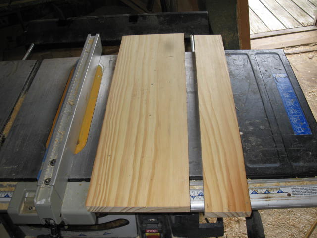

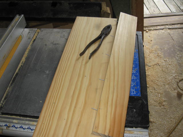

I joined two boards together to make the bench wide enough using an idea from a video Joey mentioned to me. This is how I did it. It worked fine but a word of caution. Do not try to saw into the lumber you could ruin a blade.
Drove galvanized finishing nails into one board and cut the heads off.

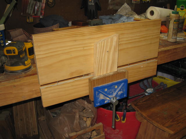

Aligned the two boards with glue between them and hammered together.

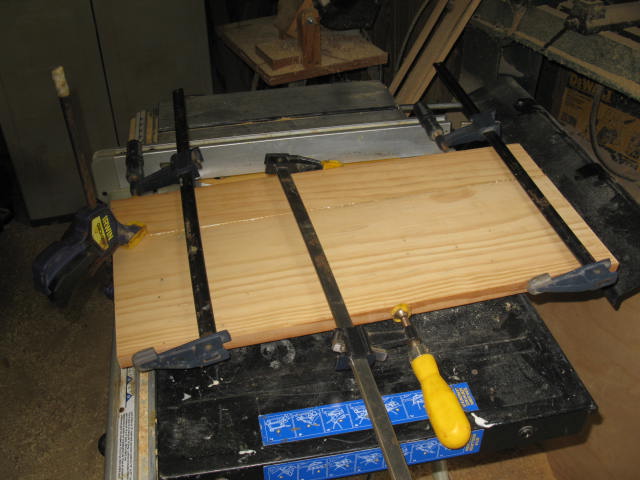

After clamping and the glue dried they were very flush and strong.
