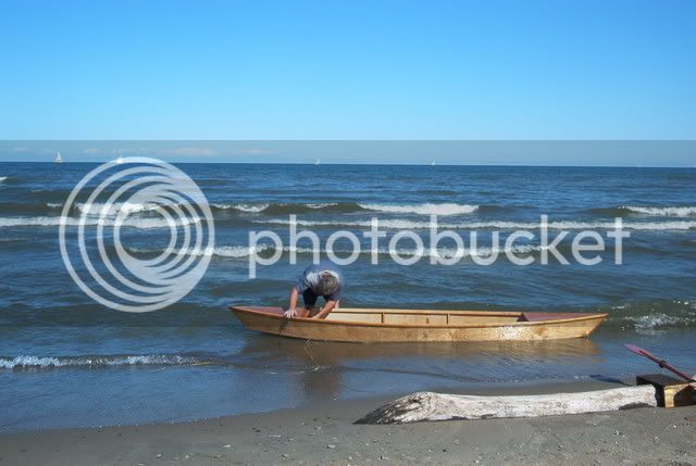

Grab your favorite libation and a comfortable chair and check out this unusual launching.
A comment about the pics first ..... No PFD. I did not intend to go into water deeper than my knees, this launching was to test the airtight compartments and not to paddle around the lake.
I am building an SS(Sparky Seat) seat and it wasn't finished, so I stole the seat design from Piper and used a temporary seat. (PS... Piper - It didn't work too well because my center of gravity was too high for the weather conditions.)
Piper .... here is your design. As you can see I added an improvement in the form of a brace under the seat. Thanks for the idea! Cheap, too!
[/img]

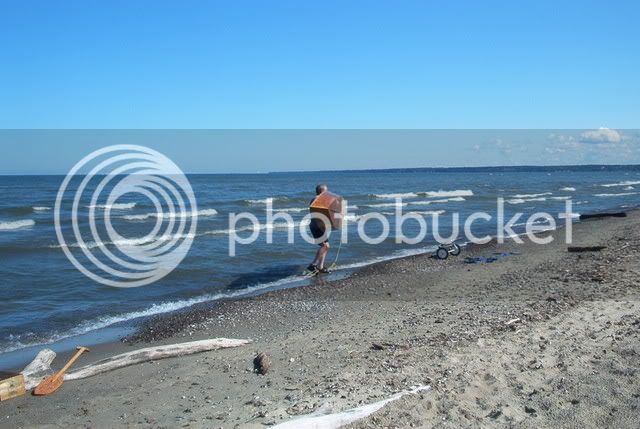

Off the cart and into the water. The narrow wheels will have to be replaced with balloon tires next week because they sunk into the sand and made it difficult to pull to the beach.

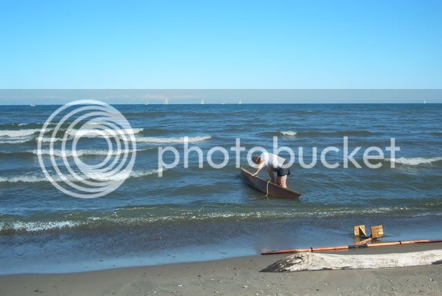

As you can see the waves made this inaugural launch a near impossibility.
Most of the waves were 1 to 2 feet high, with some more than 3 feet.
[/img]

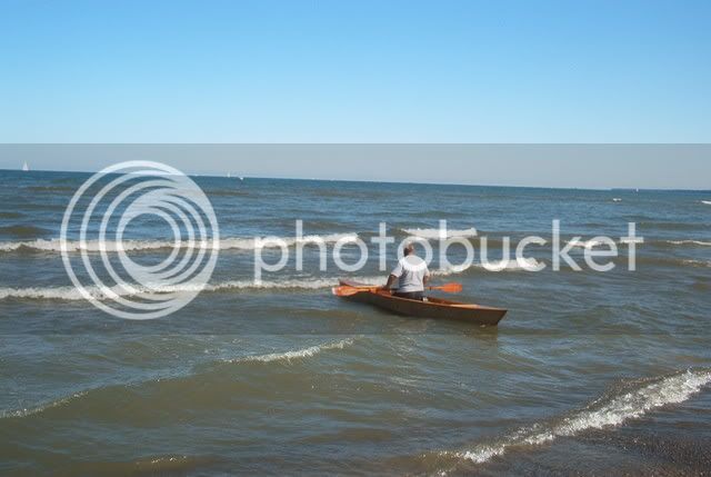

I was surprised at how well the piro rode the waves, at this point the water was about knee deep. I was also checking the stability of the piro and trying to get a feel for the balance. I also began to doubt the wisdom of launching today.
[/img]

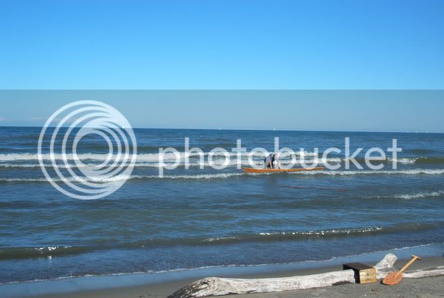

Took the piro back to shore and decided to check the buoyancy of the compartments. I am filling the piro with water and am trying to sink it.
Full of water and preparing to climb in to see if it would support me.
[/img]
The piro seemed to support me well. I couldn't get it to go any deeper in the water than this. The compartments worked very well.
Checking the compartments for leaks after sinking the piro. I had a leak in one compartment, but it cleaned up with a rag when I got back to the house, less than an ounce of water.
So, full of new found confidence, I decided to go out and try sitting on the seat rather than kneeling, which I had done to this point.

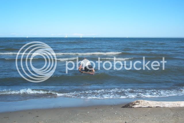

Well, everything was going well, except every other wave was coming over the bow , when I realized I have to spin this thing around and head back to the beach. Well, this photo is the beginning of a broaching maneuver and in the water I went.
[/img]
As you can see, the water was only knee deep, so I managed to recover and not drown. Obviously, this is not a good day to launch a flat bottom boat on the lake.

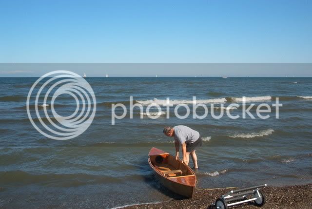

I pulled the piro up on the beach and drqined the water out. Very easy to do because of the light weight.
[/img]
Back on the cart and back to the house. I wanted to find the source of the leak in the compartment. Which I did, there was a separation in the stem area between the side panel and the stem. I had sanded the joint between the side and the stem to smooth it out and the resin was very thin in that area and had broken thru and allowed the water in. Just a minor problem and I will add a coat of resin and cloth to the whole nose of the piro to take care of the problem.
Well, I learned a lot today. One, it's not a white water kayak!!! Two, the lake is beginning to get cold! I would guess that 80% of the waves came over the bow and I think I will add a splash shield to the front of the deck. I do not intend to take the piro out in these conditions again, this was only to see how well the compartments would support a filled piro. It was virtually impossible to get it to sink lower than the gunwale, so I am very pleased with the buoyancy.
Now, I have to finish my SS seat( Is it Sparky Seat or Sparkey Seat or Sparky's Seat??) Inquiring minds want to know. I also have to add the bow and stern handholds and tiedowns . I also have to add an anchoring system and have been following the thread that FlaMike and CCtyer have and think I will steal Chris's idea for the anchoring system. It is very simple and seems to work well. Thanks for the idea Chris!
So, that is my unusual launch day. You will notice that all of the pics were taken from a distance, that is because my wife took them and she does not swim and avoids the beach. She stood about 40 feet from the water. The only boat she will get into is a cruise ship of at least 600 feet in length! We have a beautiful beach, but she only sunbathes and has only gone into the water once in the 12 years we have lived here.
I have made a lot of mistakes in the building of this piro but am very happy with the results. This is a fishing boat and not a show piece so I am not concerned about the minor errors in the resin and other small details. My next one will be a showpiece.
I will post more pics when I finish the details that I have listed above.
JC

Heya Jim,
Congratulations on the launching of a fine boat. Well done mate. AND you got wet, goodonyamaaaaate! :D
Nice piccies and beach BTW.
A couple of points mate if ya don't mind.
In the Surf, ya need to sit as low as possible. I would suggest you try that again in similar conditions, sitting directly on the bottom of the boat. You will be surprised at the difference in stability.
If ya don't mind getting wet, the pirogues are a hoot to play with in small surf like that.
Also, your temp seat has nothing to stop it from slipping sideways on the flat bottom of your boat. Not a big deal in flat water but a very big deal in surf or chop.
I think you are going to love your new boat mate. Bloody well done!! :D

Friend Jim,
Turnin' yer boat bottom upwards wuz a good thing. Until ya do, ya dont really know what it kin do.....'n what it caint do. However, I agree with Mick, set on the bottom 'n give it anuther try. Jest dont let a wave catch ya sideways. :wink:

JC,
Really good. I'm proud to see guys build and paddle their own boats.
Two observations. First, when you turned sideways, you proved exactly what happens with a flat bottomed boat in high waves. The flat bottom follows the angle of the face and back of the wave, rolling (sometimes violently) with the passing wave and tossing around the passenger.
Second, a thought for your consideration. In each of your waterproof chambers, I suggest that you drill one, tiny hole above the hatch, as high up on the bulkhead as you can get. As small a diameter drill as you have, no larger than the lead in a fine line eversharp pencil (if you are old enough to remember those, say 1/32"). This will allow passage of air as the sun heats it or water cools it, but not water. Also, store the boat with the hatches out and full ventilation allowed.
Oh, a third observation. I wouldn't store beer in there. If a wave hits when you're getting a beer, it could both drop the beer overboard, and sink the boat. At least one of those would be tragic.
