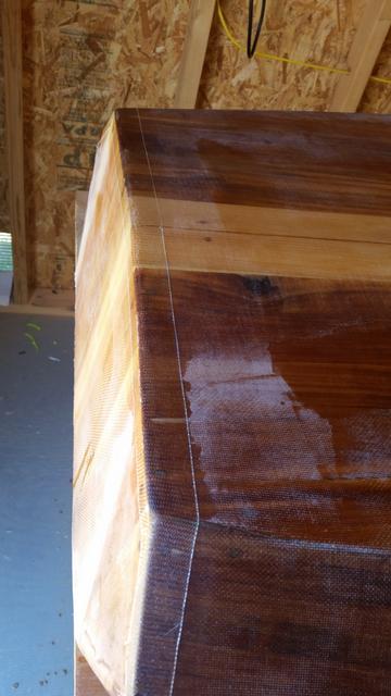

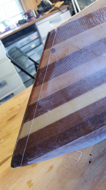

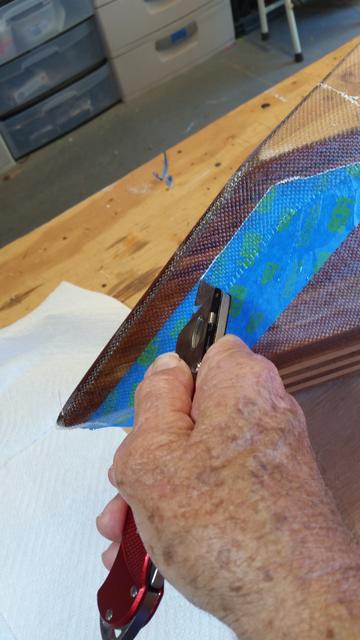

It’s been pretty quiet on here so I thought I’d at least make some noise. I’m working on a crawdad a couple of times a week. I have started using a “new to me” method of making seems in cloth. I like to double up on the wear areas and the “ragged” edge is hard to clean up especially on the bright finish boats.
I tape the future edge of the patch with blue tape the cloth the area as usual with the cloth overlapping the tape. After it’s cured (but not real hard) I score the cloth right on the edge of the tape. Let it cure a little more, fold the tape over and peal it off. This leaves a straight clean edge to clean up.
