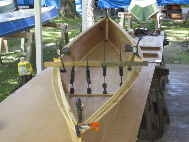

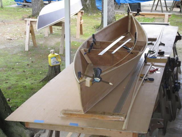

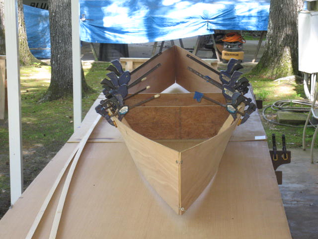

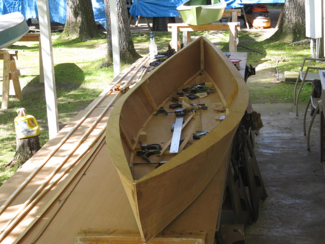

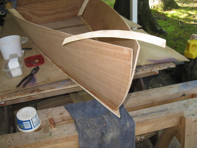

This is the sides spread by the jigs. The smaller clamps are holding a short plywood batten I used to stiffen the sides. They are 5 mm and pretty limber to work with.

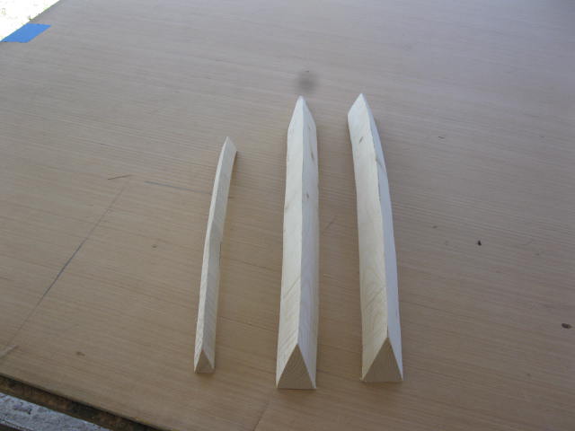

Installed the chine logs. They are sawed 32 deg. to flair the sides enough.
After drying they have to be planned/sanded level to fit the floor.

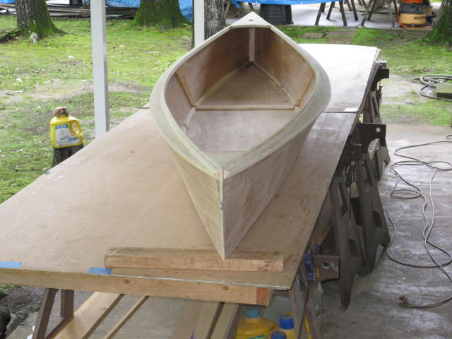

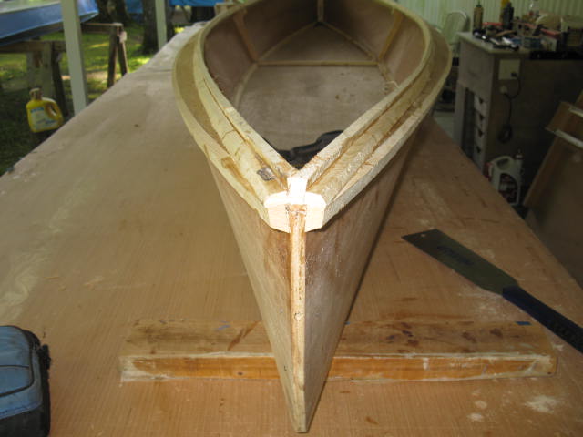

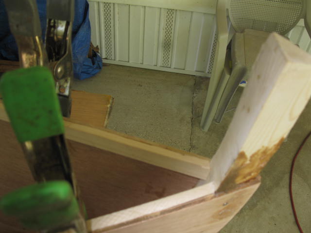

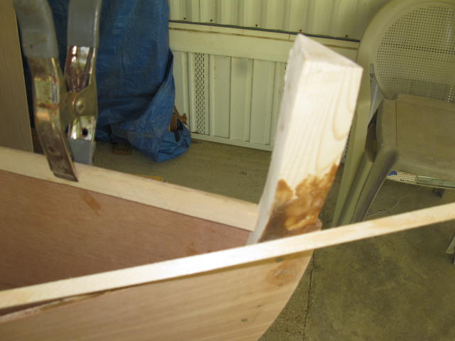

Made the stem pieces out of 3/4" stock to save weight. Did not work because it split when nailing in place. Careful grain orientation may prevent this. I just made new ones from 2X4 and cut away excess wood. They worked better with only a few ounces of weight gain.

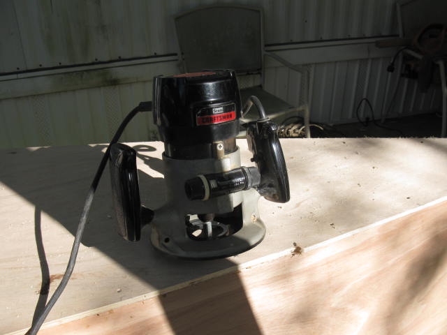

Pictures out of order. I installed the floor before the stems. Used the trim bit in my router. This left little sanding to do.

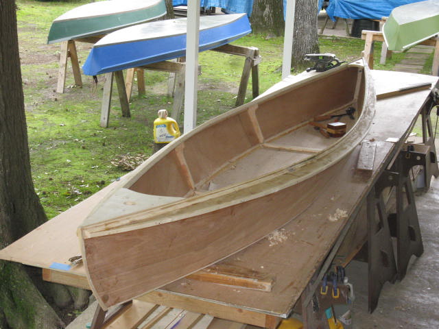

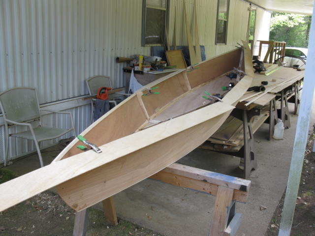

Installed inside gunnels to support the tumblehome panels. I wanted a change in styles and was not going to use tumblehome sides. The 5mm ply is just not stiff enough to work with gunnels alone.
Determined the size and height of the TH supports. I also had to install a floor rib/backing over the splice. When making the scarff joint I discovered a void and had to convert to a butt joint.
I used plywood for the panels and made the splices over the supports. This causes some waste, but is stronger than having the splice between supports.

Thanks for taking the time to post, we realize it takes some effort. I have some knowledge to gain with questions.... I'll ease into them one a a time. How did you "set" the rocker? was it predetermined?
"predetermined" only in general terms. My last boat was built to very specific dimensions because I was trying to milk all I could from the size and shape. I did reference the last boat's sides as a starting point. The idea for rocker was to keep it between 1" and 2" for each end. It came out at 1.5" for both. I was pleased.
Hard to describe total process, but basically placed the side panels on the table and drew the arch. This one worked out to be 4" about 8" behind center (widest beam). I started at 3.5". Spread the sides on the forms and measure rocker. Remove from forums and cut more, if needed. Baby steps until you get what you want. If you are not married to specific beam or floor width the forms can be moved or adjusted to change the rocker.

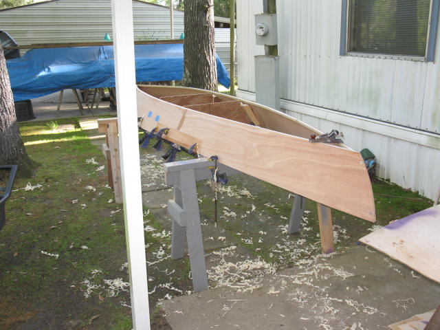

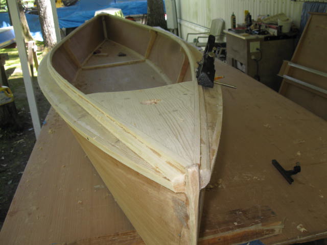

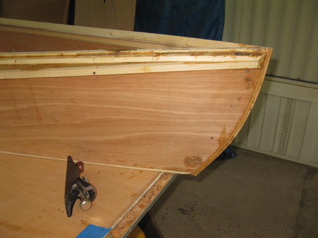

After attaching the panels to the sides and supports I shaped and trimed them.
Two strips were glued to the inside edges of the panels to make the combing, and outside gunnels were added.
Another floor rib was added. This actually stiffened the sides. When the sides were stressed the floor would flex/bend. After the rib was installed the floor would not flex and the sides did not move. Interesting to me how all parts and features interact in boats.
Added two batter boards and breast hooks. I used a hand plane to flush the boards to the sides. This works faster than the sander.

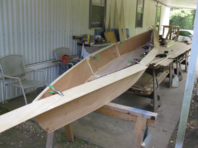

Used the rabbet plane to clean up the combing strips. Almost the shape/lines I was building for. The tumblehome shoulders and supports take away from the flared open look of a marsh pirogue. I think stiffer wood is needed. Close enough for me.
  • Like
Reactions: Gamecock

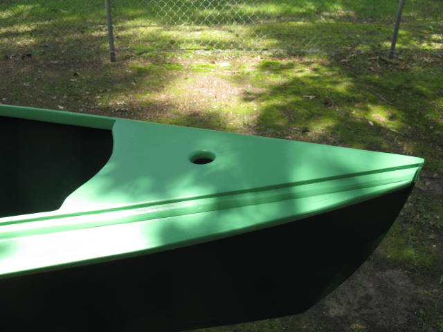

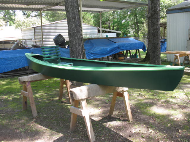

I had intentions of this one being different. The sides were flared to about 32 deg. so the boat could have a more open look. The 5mm luan was not ridged enough to work without some kind of reinforcement. I did not want the look of ribs or beefed up gunnels so for me the tumblehome shoulder worked best. I will try to do better next time.

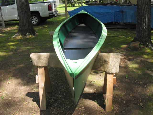

The floor has truck bed liner coating inside and the bottom is coated with Goop Coat It. The hole is not a spud hole, just a handy tie down feature if needed.

My son and I finally were able to make a fishing trip. He used the marsh pirogue and I took my "Bayoy Dorcheat" pirogue. The fishing was not spectacular but we enjoyed the trip and learned some things about the new boat.
Our standard 8" tall chair is too high. The boat was too tipsy sitting at this height, not "turn over" unstable but not comfortable for casting and other fishing activities. Not much concern when paddling but the boat will benefit from a lower seat.
