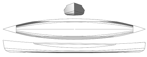

Sample images:
Line drawing

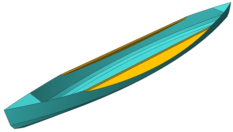

To see the how the tumblehome panels work, I've colored them. Boat obviously won't be painted like this.
It looks real bizarre in these snap shots but it looks a lot better in my design software and should look good in wood.

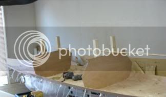

This 1st shows the legs/risers I'm putting on each frame so when I flip it over, it'll act like it's own work stand and assembly jig.

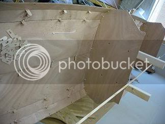

Here's a good one to show the hull shape. It's a shallow arch. Won't be a super-speed demon but should handle some moderately choppy water well and feel nice and stable on calm days.
