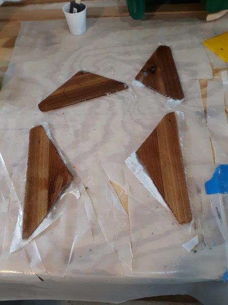

Need some corner braces for the transom. I cut them out of scrap from the deck, glassed them and will epoxy in later.

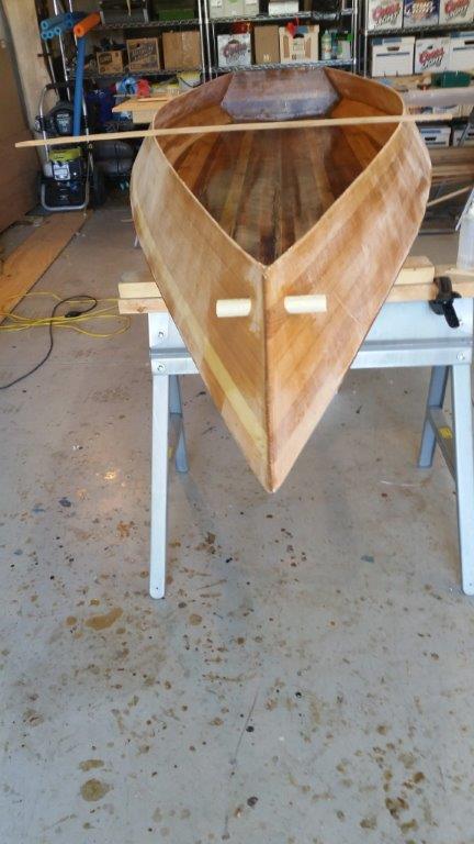

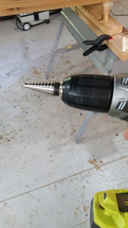

I like to make a bow tie rope like we see on here often. Ron (Texas River Rat) posted how he ties the knot, It's posted on here somewhere. I simply put a piece of 1/2"PVC through the bow. I drill pilot holes with a long 1/4 ' bit and run it through both sides of the bow to make sure it is symmetrical, if not drill a new one. Then I use a step bit, which cuts a nice clean hole about any size. Mine are expensive metal cutters, but Harbor Freight has some less expensive. Epoxy the PVC in place, cut off flush, sand and you're done.

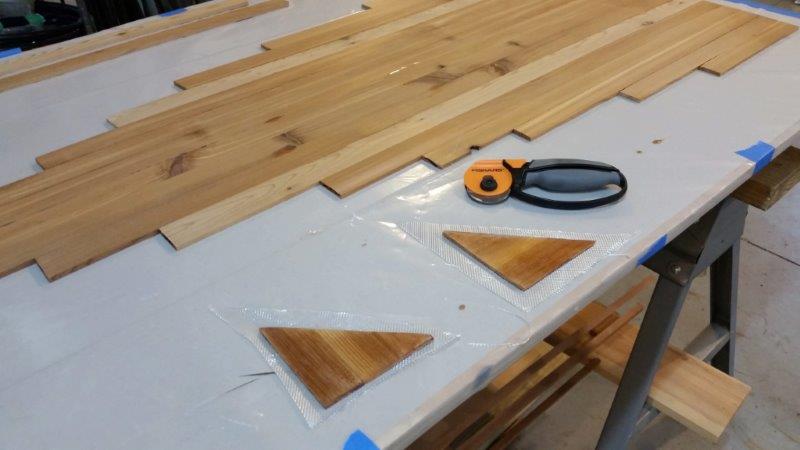

For the front deck I make a pattern out of cardboard and trace onto paper, cover with plastic and glue up the rough shape. I like to use the 23 gauge pin nailer for gluing the strips. My planer is only 13" so the deck is initially made in two parts, Then epoxied together glassed and it's ready to epoxy on the boat..I think I've learned that big deck supports aren't necessary and just glue in some simple supports.

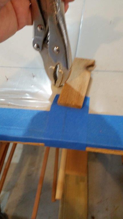

To epoxy the deck supports in I tape another stick of wood to the deck support to hold them in place while the epoxy sets. Always cover the pieces you don't want glued in place with packing tape.

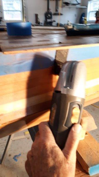

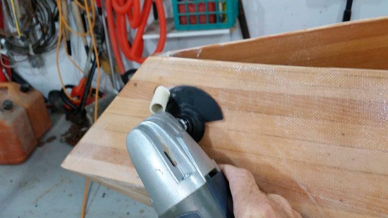

The decks are trimmed with the multi tool. It's a great value at harbor freight.
Next round off the junction of the deck and sides with 80 grit on a stick.

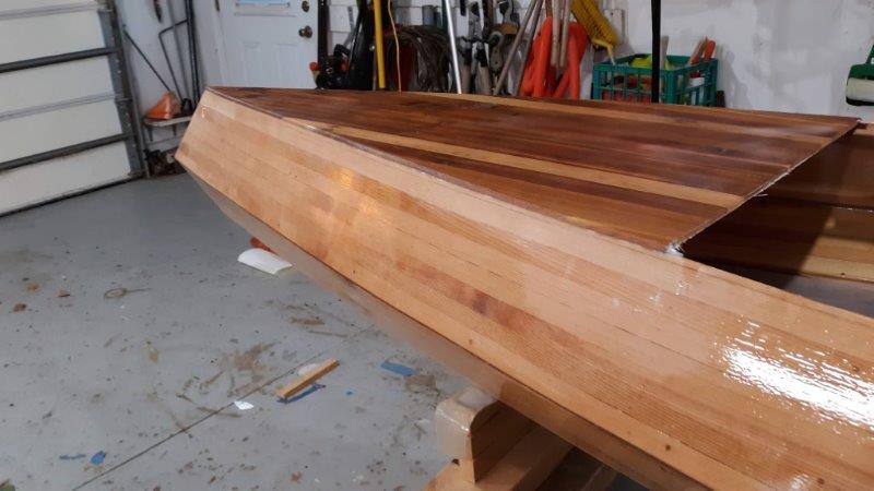

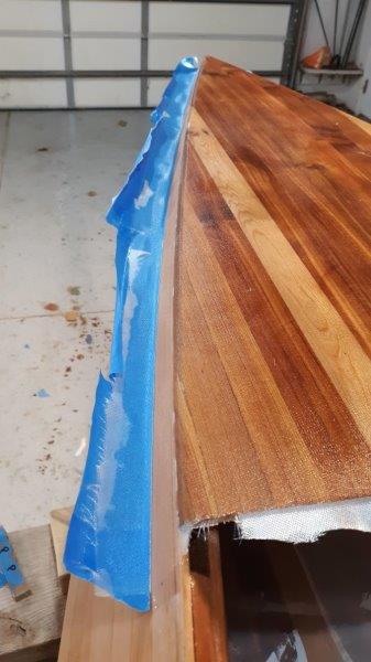

On this boat I used 3.5 ounce on the deck. I think it will leave a better overlay seam. I define this overlap seam by taping off where two cedar strips join. Then when epoxy is "green set" I bend the tape over like a hinge and cut the glass with a utility knife. Then scrape and sand the overlay seam. It literally disappears with one coat of epoxy.

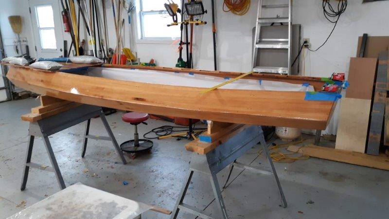

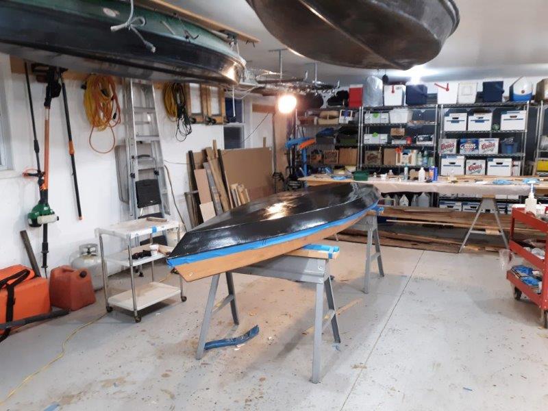

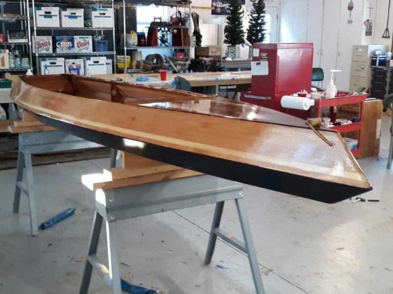

Finished, well just about needs varnish after the epoxy cures a week or so. I'll get to that next spring when we return from Texas.

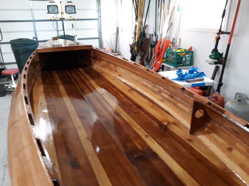

The deck needs a splash board both for function and also probably for strength. I cut, planed, and rounded the edges of a cedar fence board.Then made a card board pattern to ensure a good fit, routed a groove for the deck to fit into, and glued the board in place. Covered the splash board with 3.5 oz fiberglass and epoxy.

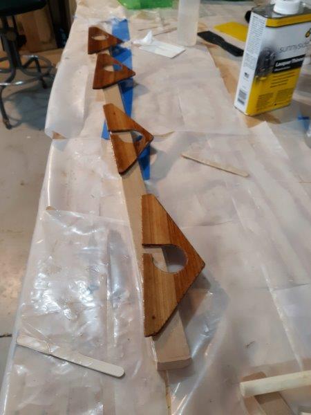

Next are the rod holders, which also serve as supports for the "tumble home" panels. I often fish with long poles and thought these type of holders might keep the poles out of the way when not in use, time will tell. They added quite a bit of rigidity to the top side panels.
The rest of finishing this project consisted of epoxy/graphite/rockite on the bottom and a final fill coat on the boat.
Thanks to Bee Keeper for his research on the bottom coatings, This is the third boat that I have used rockite in the epoxy graphite mix. I'm convinced it is more gouge resistent. However, as always another lesson! If a little is good more must be better? I mixed two heaping spoons each of Graphite and rockite in 3 oz of epoxy. The result, a really rough non skid surface! After a couple hours of sanding it off, I went back to my original one heaping spoon each of graphite and rocktite in 3 oz of epoxy. It is important to make sure the edge of the masking tape is sealed really good as the black mixture seeps easily.

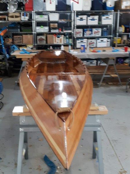

here are a few pictures of the finished boat.
IT was a fun build,even with some time out to get rid of that pesky gall bladder! Can't wait until the crappie head up the creeks to try it out..
