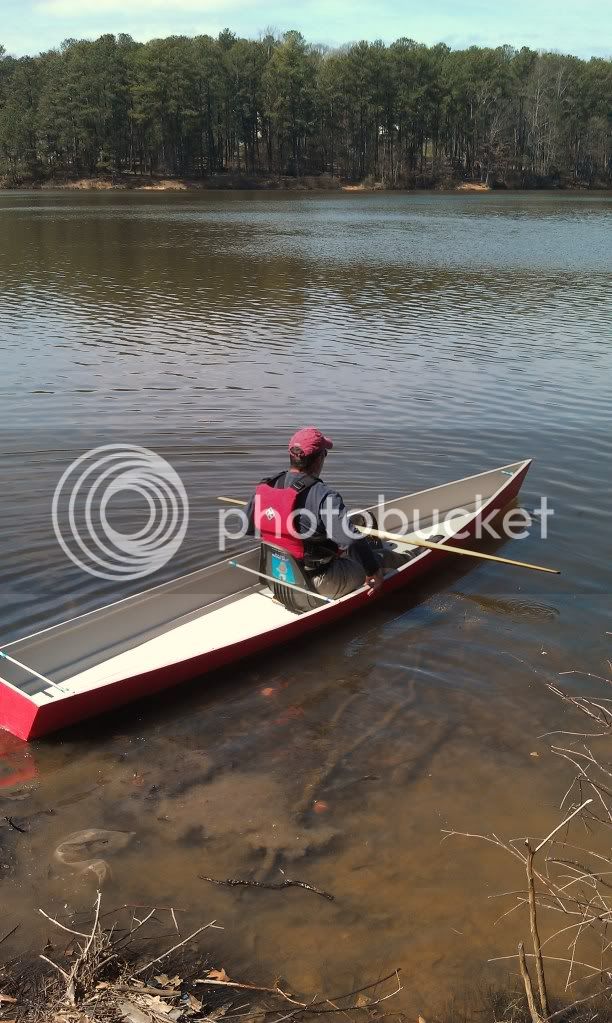

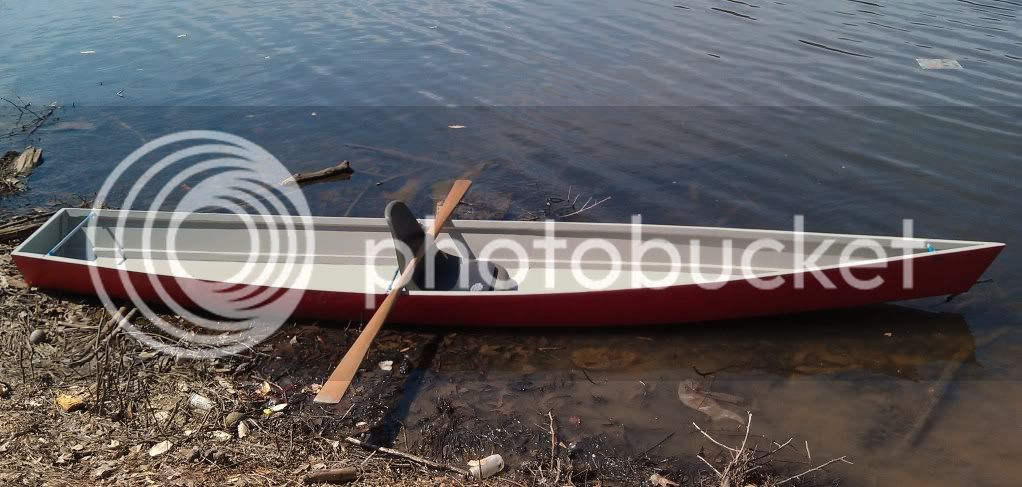

Thanks to all the help here. She is finally done. I call her a Glade-rogue- an adaption of the classic Glen Simmons Glades Skiff as explained in "Gladesman" and the tried and true pirogue.

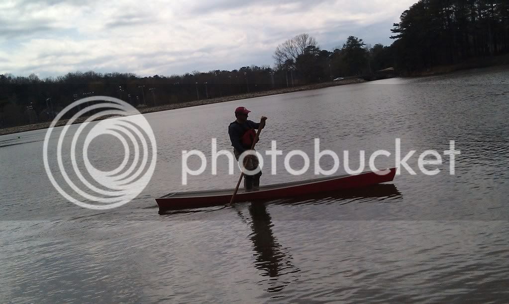

I'm envious of him standing and paddling - I'd be fishbait in 2 seconds if I stood up in it.
I'll bet the Inuits never envisioned their paddles being used in that fashion. It's a good paddle for his uses. He can swap sides very quickly while standing, handy for paddling seated, and makes a nice prop for a rain fly - an all around good paddling/camping tool.

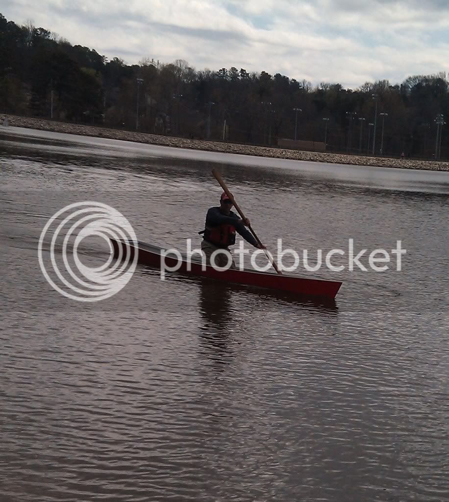

I love my Greenland paddle. I built it out of a piece 2x4 of cedar. It may not clear as much water as the traditional kayak paddle but I never get sore and I can paddle all day. The added bonus it can be used a stand up paddle, push pole or gator whacker(not proven yet). I hope to slime it tomorrow.

Finished boat looks good. What's the length and width? I like that style of Greenland paddle to, short enough to be usable in tight places.

She is 14ft. long and 24" at the chine and 34" at inwale. I will be adding another thwart or rib up forward to stiffen her up. Oh if any body needs aluminum thwart material try your local chainsaw shop. The Stihl pole saws are always getting bent and the aluminum tube they are made from make great thwarts. You could even use a weedeater shaft. Make sure you heat it up before flattening( Don't ask me how I know this).
What kind of plywood, frame wood? The boat looks "light". Do you know the weight?

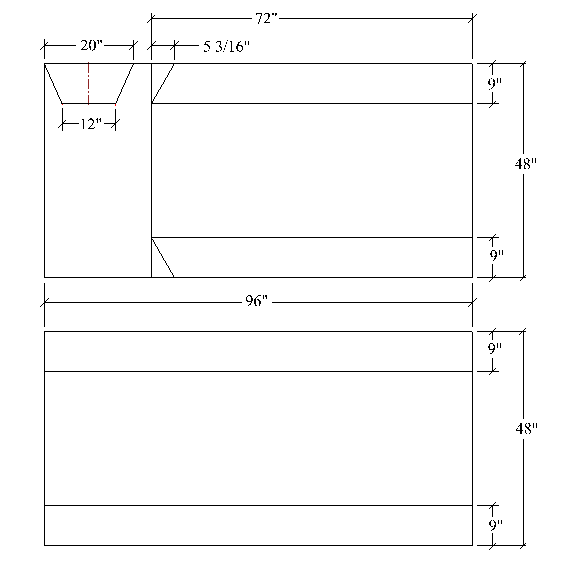

Sorry for the delay, I just saw your message. Their are no plans for her yet. I did all off the top of my head. She weighs around 45lbs. I need to add a thwart or rib up forward for a foot rest and strength. The stern is 20" at inwale and 12" at chine. I took 5mm luan ripped down to 9" butt joined with fiberglass cut to length(14'). I then laid the sides flat on my build table, applied cedar 1x2's (lowes) to sides using pl premium(now I like sika construction adhesive) and weighted with bricks. I made sure to plane the ends of the 1x2's to 11.5 degrees with block plane, constructed the stern plate, attached center former,attached stern, bent bow around and glued, traced bottom out,cut and attached, used construction sealant for filets,made thwarts,removed former, epoxied inside and outside, primed and painted. The next one should go faster now that I have worked out the construction details. I will post pictures of this next build.

I love the shape, Hydro. How does the square stern affect the paddling? It looks to be almost out of the water when trimmed out, which is a good thing.

I do not know the distance from the bow to the center thwart. But the drawing above might be close to what is needed to build the boat.
