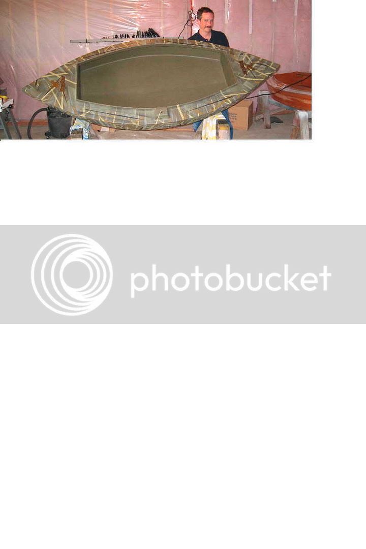

Well here goes I have never posted a pic B-4. This is very small 8' boat that I finished in 2004. My brother was building one at the same time. You can see his in the background. These were scratch built without any plans.

Good job on your duck boat and don't leave it in the grass or you will never find it. :D
The one in the right side of the picture looks pretty good, from what I could see of it.

yea, looks good. How much did it end up weighing? what did you do inside the front, back and sides? Is it just air in there? The molded oar locks look very professional. People probably do not believe you made it yourself.

The Boat weighs in at 28 Lbs. The constuction material is 1/4" luan plywood, encapsulated in epoxy. All the seams were fileted with epoxy/wood flour and fiber glass taped on both sides. The oar locks are 2 x pine. I made some plastic inserts that snap into the oarlock holes to act like a bushing. Both of the bulkheads are air chambers. My original plan was to make those areas storage. But that could be done at a later date. It was a fun project to make. I had never tried stitch and glue construction b-4.

Wow, that is a little boat but light as a feather. ducks will be in trouble.
