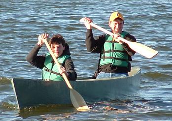

Welcome aboard! I see the balance of grit-eaters vs. non-grit-eater continues to lean toward the South. :p
So you like pirogues? Need 500 pounds on board? How about the Pirogue 500?
http://www.jemwatercraft.com/proddetail.php?prod=Smpl
