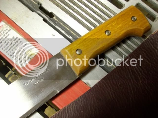

I've been needing a new machete. The el cheapo I bought 25 years ago just wasn't cutting it. Just plain stamped metal. I found this nice one at the local flea market for $6.00.
Yeah, I know, how good can it be for 6 bucks? I have a few tips for picking out a good blade. 1. Does it ring when you pluck it? Works surprisingly well on a big blade. High pitch means harder steel. Low pitch - softer steel. 2. How does a known hard tool ( file) effect the metal when rubbed across it. If the file digs in with little effort, keep looking. If the file wants to slide across the surface or just barely bites into the blade you probably have some good steel. Be a little discreet when you do this. :) 3. Where is it made. I figure Chinese stuff is a crap shoot. This was made in Brazil. I figure South Americans know machetes.

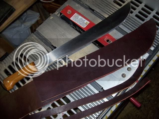

I cleaned up the blade with a bit of 320 sandpaper, put about 4 coats of TruOil on the handle and put a shaving sharp edge on it. My in store tests turned out to be a hit. The blade is made with high carbon steel and is tempered very well for hard use. High carbon steel shows itself when you grind it. It throws off sparks just like a 4th of July sparkler- a sure sign of high carbon steel.
I cut out a few pieces of leather and will stitch up a sheath for it.
An interesting thing about a knife is, the entire knife exists to support only the cutting edge - nothing more, and nothing less. We often get all wrapped around the axle with exotic handles, engraving, etc. etc. But, if the cutting edge doesn't work, all the rest of it makes no difference.
