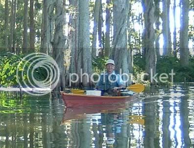

Joey, this is all i have of yours in the water. I guess i was busy 1. paddling 2. cursing 3. watching the whitcaps 4. scooping water out of the boat with my hat to get the camera out and take pics on the open lake.
Notice the big smile on his face? He hadn't taken any water in. His freeboard was about the same as mine and his sides are ten inches I thing, versus the 12" sides on my boat . I think I outweigh him.......he is a careful eater and I am on the SEE-FOOD diet.
38
Actually the sides are 9.5" before I planed and sanded them. Here's the only pic I have of your boat. Too busy watching waves I guess.
The difference in freeboard is partly weight and partly the fact that I have very little ( less than 1") rocker. Piper's UJ has probably 2.5" of rocker. This causes the center of the boat to sink deeper before it displaces enough water for the load it's carrying. Or not. :?
38
