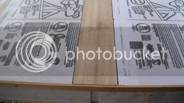

Each pontoon will be 2 ft wide 12 ft long 5 inches thick ,laid up from 1 inch foam laminated together.
The hulls will be detachable and hopefully be able to paddle separately. They will also be built with the option of covering in cloth like a skin on frame,or epoxy and cloth and will have wood strips inset in the foam so if I decide to I can come back and strip the hull with cedar strips.

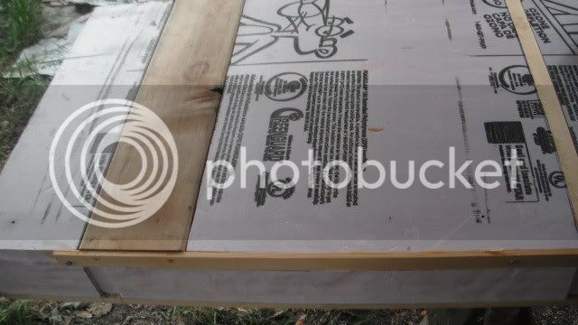

The second pontoon is glued up

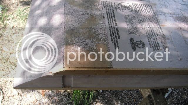

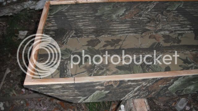

used a router to cut foam for wood inserts,pic of the bow before shaping
and after shaping.

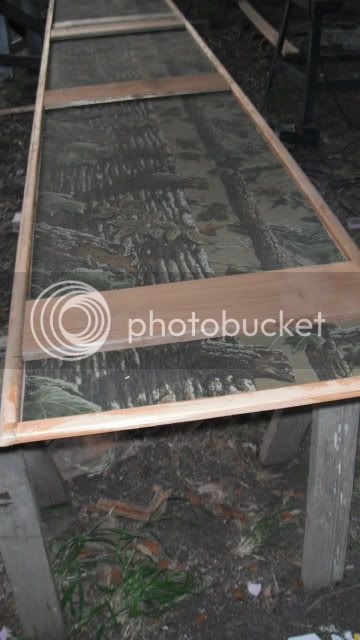

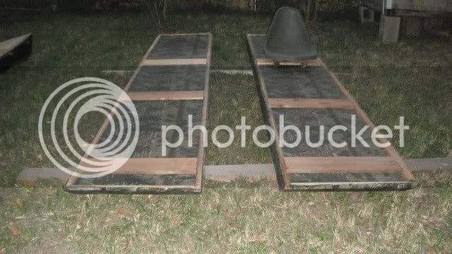

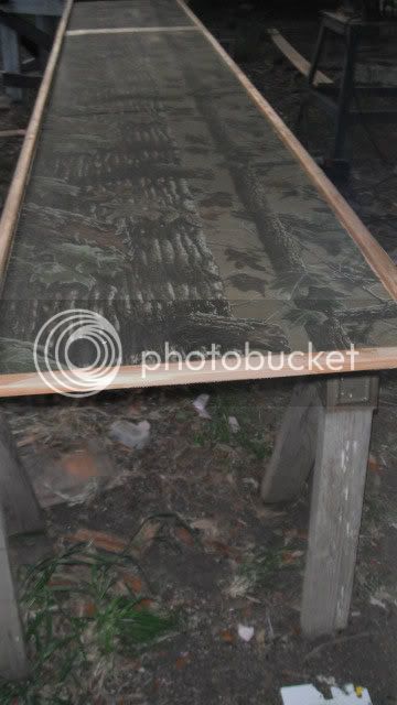

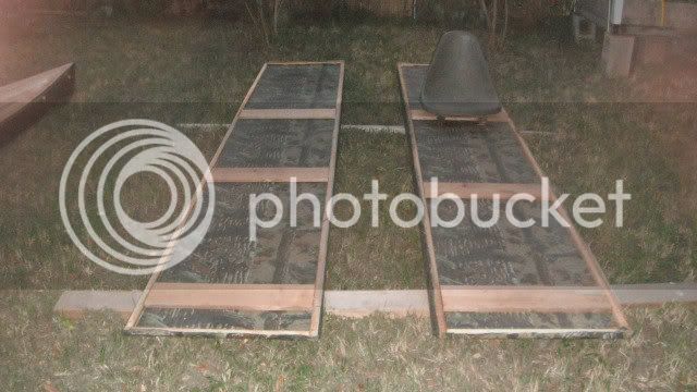

Both hulls are covered and close to finished ,I weighed them 27 lbs each .

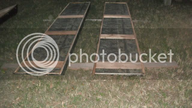

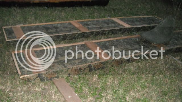

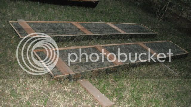

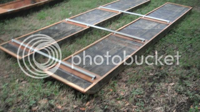

Laid them out a bought the way they are going to be.
I am hoping you can paddle each hull individually.
Blends in with the grass pretty well just might be a hunting boat lol.

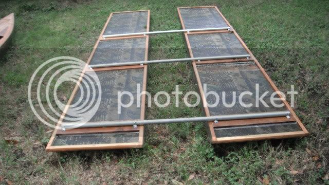

I will start figuring out cross bars and mounts, boat assembled should come in at about 70 lbs
but will break down into three pieces.

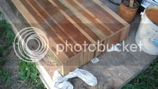

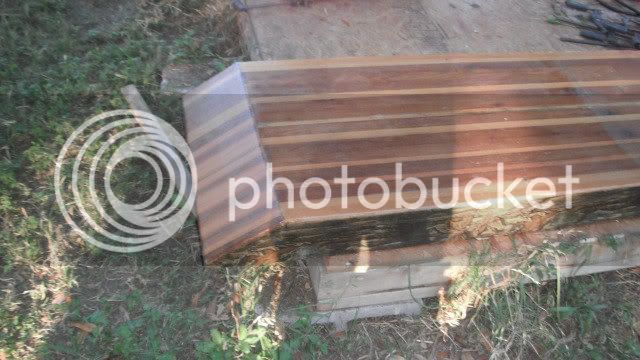

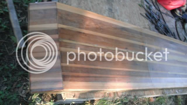

Did some serious thinking about this boat and how I am going to use it. It is going to be dragged across gravel and sand bars , bounce off rocks in the Brazos pulled up boat ramps.
I decided to cover the bottom and both ends with strips
I figure no one will see the bottom so I just used a lot of strips I had left over from other builds.
The sides and top are still camo.
