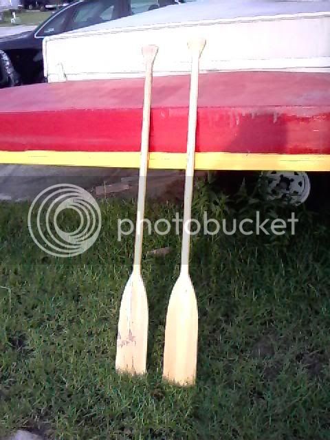

After reading about others who made up their own double paddle, I decided to do the same. I had taken my boat out a couple of times using only a single paddle and found that I was tacking more like a sail boat instead of tracking in a straight line. Below you will see my two paddles I used to make my ww2.

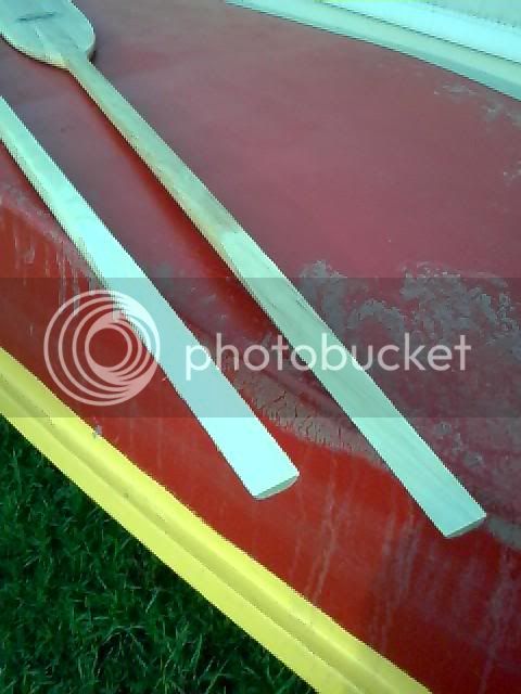

Next is a picture after using the belt sander and scarfing the end in prepping them for resin.

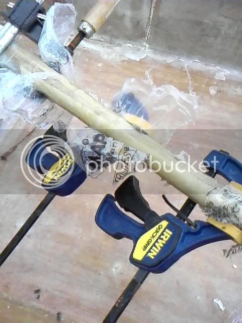

Next is a picture after I had applied the resin to the handles and then wrapped a layer of fiberglass around the splice. Holding everything together with a few clamps.

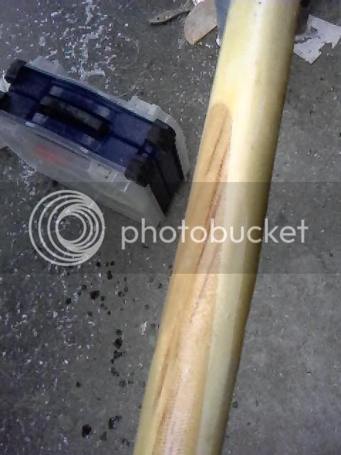

Not liking how the first coat of resin turned out, I sanded most of the fiberglass and resin off the handle and rounded the edges more and cleaned up the look of the new handle.
Once the resin was hardened I was able to smooth up the surface and without looking closely it is hard to tell that it is even glued together. When I took it out to try out last Friday the boat seemed to handle much better and I was able to speed up quite a bit. Now to just get in paddling shape so I dont have so many aches and pains from using muscles I havent used in such a long time!!!

Nice work!!
I've been debating how to go about trying a kayak paddle. Whether to build one and take a chance on making the wrong size, or buy a cheap plastic and aluminum one to experiment on.
George
A situation you have to watch out for when converting two single sticks into a double one, is the handle, called the loom. On a kayak paddle, you want an oval shaped handle; it is more comfortable to use than a round one.
Problem is, you need that oval to be at right angles to the width of the blades. IE: As the blades are positioned up and down, for normal paddling, you want the oval to lay flat. As held in the hands, it wants to be longer than it is thick.
Many canoe paddles are constructed the exact opposite, because they are meant to be used differently. So, while it's possible to achieve an inexpensive double paddle, it sometimes ends up being an exercise in futility, because the paddle hurts your hands in actual use. Just be aware wen buying those single blade paddles.
