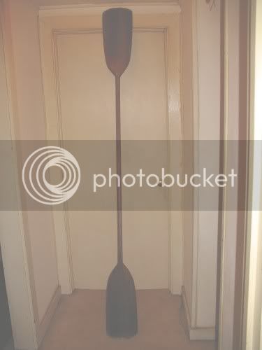

Just finished another double bent paddle and corrected all the mistakes I made on the first one. Cool weather has been playing heck with me and the Epoxy as I have no patience with either.....
Westbury and Paddle
Paddle from a side view, Double bend and Dog
Sorry about the naked dog Oyaker, His cape was at the drycleaners today! :lol:

Franke Great looking paddle. I've been wondering lately if a double bent would work, as I am a big fan of single bents. What problems did you have with your first?

for the kind words. I really like the way the paddles look, not really sure if they really are easier on the wrist as I don't have much problem with my ZRE bent shaft. Always glad to have anyone come down and paddle along. I do get some flutter with the first paddle and will let you know after I get to use the new one this weekend. I had intended on taking pictures of the build but get so involved with finishing the paddle I forget to take some pictures. Will try and remember to take some on the next build....

The first one, when I clamped the shaft, the laminations slid and I had to shape the shaft a little smaller than I had intended. It appears a little delicate but after using it for several months I really like it and haven't had any problems. I had also placed the blade between the wrong shaft laminations and this beefed up the power face of the blade instead of where I wanted. Not sure this really mattered but it's not what I intended. The new one I laminated the blade front and back and hope this adds strength to a really thin blade. Just trying new things to see how it works out. I hope to paddle the Etowah River this weekend and will report how the paddle works out.
