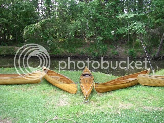

Covering the decks will help, but you have a bigger problem with a canoe and that is the height of the bow and stern. the taller a boat sits out of the water the more wind it catches,
My last three boats have been built with a very low profile fore and after and decks that are the same length and height and really help a lot.
Shape of the deck wont matter much on your boat because you have the square edges of the hull to contend with. so just keep it as low as possible.
I have paddled and owned a lot of canoes , and the low kayak shape and how they handle wind is the reason I dont have any now.

82
Some polytarp laced to the gunnels over a couple of flexable slats will cut down on the wind induced yaw.
As to the streamlining of the head, you are on your own. :lol:
Looking at the pic, the boat on the left is MUCH harder to keep straight with any wind at all. While the boat on the right, while affected is much easier to control.

Mine is the Scout model of the 'Indian Brand' canoe, but I forget what the manufactures actual name is. It may not have been a very big or long lived company. Mine is shaped more like the one on the right, but it has a very flat bottom. As I remember width at gunnels is about 30" and has a long radius to transition to the flat bottom. I've done everything with it including some white water, but the very things that make it so handy most of the time also work against me in the wind. As has been said on here many times, no boat does everything well.
