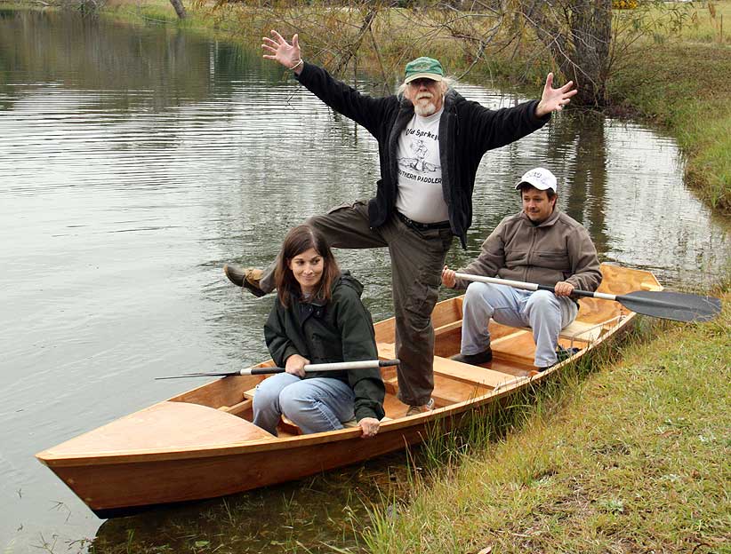

You might want to look at the one I am building at this time , it has a lot of rocker in it which reminds me or the river boats.
It is a cross between a Pirogue and a normal boat , can be built lighter then I am doing it and has some stability to it.
Hear's is all the pictures.......
http://www.unclejohns.com/bysk14/photo.htm
It can be rowed , paddled , sailed or even used with a motor on the back.
The boat is 13 feet 9 inches and 1/4 when made. The full story on the forum with all of the chatter while Uncle John was making the 1st one. He is the guy standing up with that nice "T" Shirt on :wink: while Cristy is thinking he will go swimming , judging from the look on her face and Jason is just sitting there. :lol:
viewtopic.php?f=3&t=7251
My Build........ viewtopic.php?f=3&t=7336
