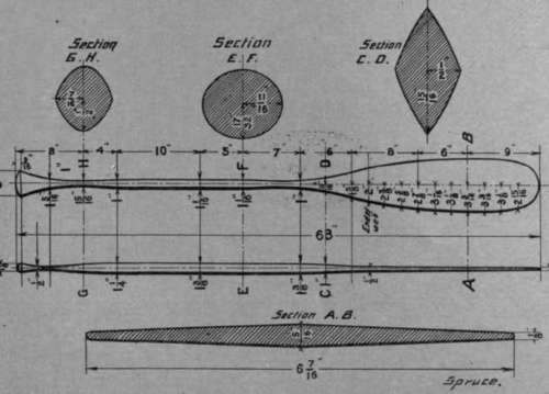

1905 Canoe Paddle Plans
From:
http://chestofbooks.com/home-improvemen ... addle.html
Also: Simple jig for rounding sticks:
http://chestofbooks.com/home-improvemen ... ticks.html
