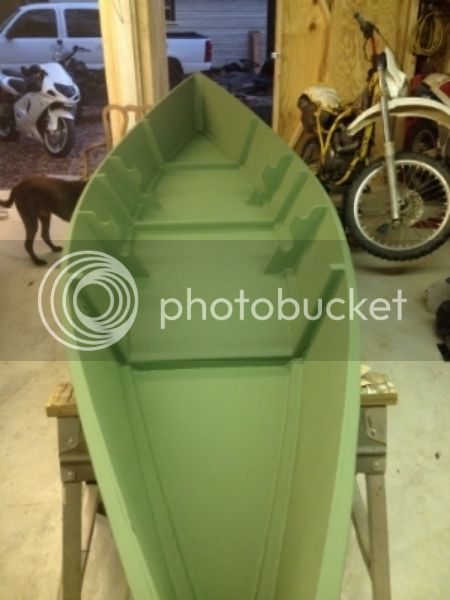

I've been working on a single outrigger design that is basically a "mini pirogue", it is 7' long with a 10" bottom and one rib. It will be attached to my pirogue with quick release mounts, a 2x4 going to the rear rib so I can also mount a trolling motor to it, and a 2x2 to the middle rib. The battery or other gear can ride in the outrigger to keep it from lifting off the water. I have some pictures but haven't had good luck trying to post them :?
I'm wondering if I need to make the height of the outrigger adjustable, or if I can just build the bottom flush with the boat and get it to trim properly by shifting some weight. With 200 lbs in the pirogue it drafts 3", I will usually have 50 lbs or so in the outrigger. I've also got it spaced out enough to paddle between the pirogue and outrigger if I need to, I'm wondering how much it will cause the boat to turn to the side instead of tracking straight. I appreciate the advice from anyone who has done something similar.

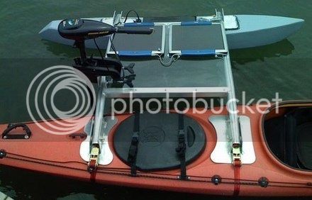

Judging from the pictures all of the outriggers pretty much ride on the surface of the water.

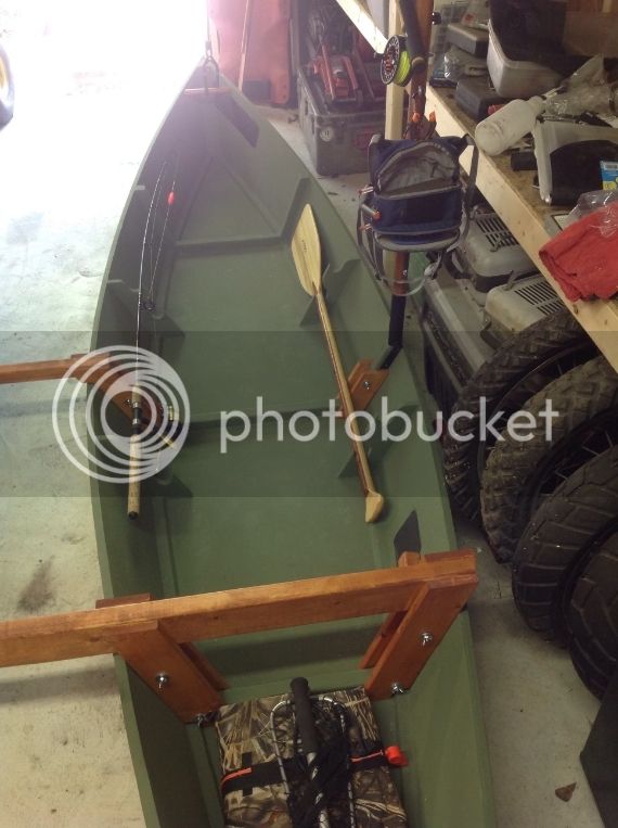

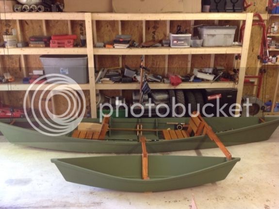

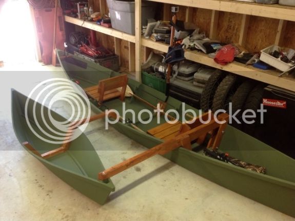

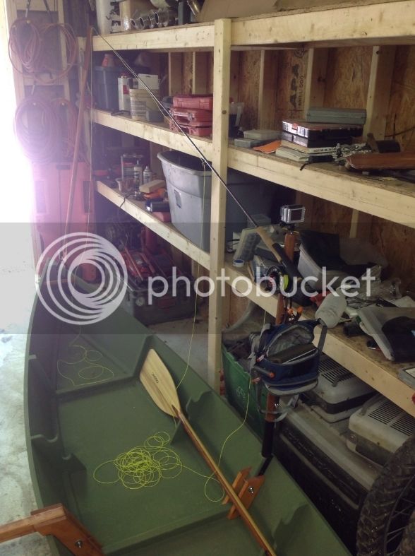

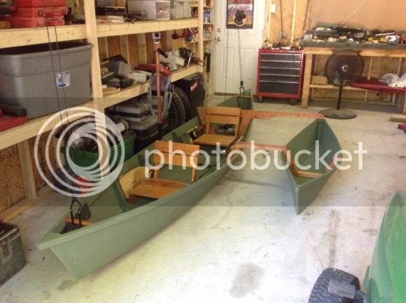

Well I got the outrigger done, the paint still need to cure before I get it on the water. I ended up mounting it 1 3/4" higher than the bottom of the pirogue, and it has 4" of rocker in less than 7'. I'm hoping that will be enough to keep the outrigger stems out of the water and not affect turning too badly. I decided not to make it adjustable for strength, I will carry some water jugs for ballast if I can't get it to trim properly by shifting necessary gear, or make my dog ride in the outrigger :lol:

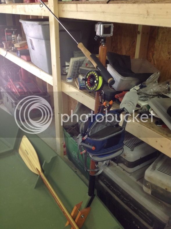

I also made an accessory pole/grab handle to stabilize myself while standing if needed and hold my gear. With the front seat removed and standing over the center rib there is nothing to foul the fly line and hopefully it will work great for fishing. I still need to build another push pole and shallow water anchor stake, as well as a paddle/pole clip.
I mounted everything by clamping to the ribs using wing nuts, it seems very sturdy but should allow it to slip if something goes terribly wrong rather than breaking the ribs in the pirogue. If it works well and I end up adding a trolling motor, I will add the Bigfoot button control so I can cruise along while standing with my fly rod in hand.
