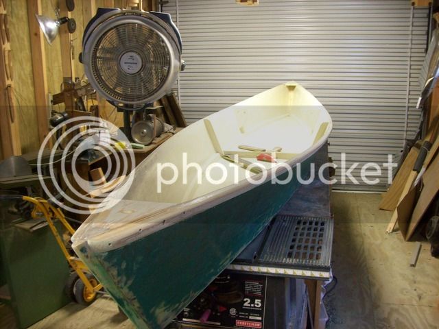

We've been talking about our next boats. I started listing the things I want in a boat and, what do you know, I convinced myself that the pirogue I have is THEE one I need!
So, I figured I'd start back with it on a positive note and give it a make-over.

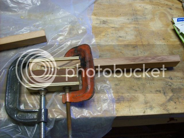

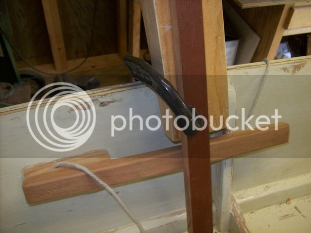

I'm adding a 3- for- one carry handle, tie off rail and jam cleat on each side of the seat area.

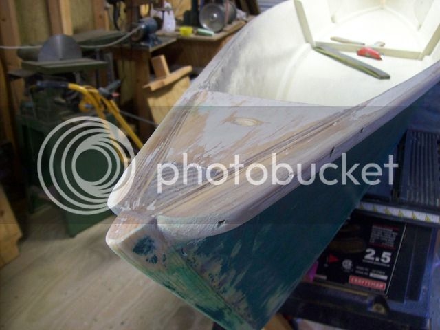

Oh, by the way, do yourselves a favor and get some of this sandpaper. It cuts so well and lasts so long that after passing the scraper on the gunnels and the inside of the boat, I hand-sanded the whole inside and both gunnels with a quarter sheet of 220 grit. This was a piece that had been used on some other projects before!! Great stuff.

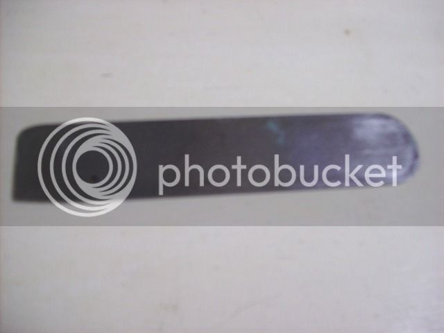

Scrapers don't get much press nowadays. I find they are a must in boatbuilding. Mine is a piece of steel banding material about and 1 1/2" wide.
It's ground to a different shape on all four corners and has a turned up burr all the way around. I've scraped off one wayward brush hair from a finish coat of varnish without touching the surrounding finish. Try THAT with sandpaper.

No, Jack, dried varnish. To sand out a dried in hair, you would disturb quite a bit of the surrounding finish.
I have my carry handle/tie-off rail/jam cleat all built and fitted. I just have to epoxy it in and add a few SS screws.
I love scrapers. In a bind you can make scrapers our of a lot of stuff. You can use banding straps like Joey said, worn out but not bent sawzall blades, little ones from hacksaw blades, ect. Sharpen them at 90 degrees and burnish a hook on it. That is rather simplistic. The internet has lots of instruction on scraper use.

Let's see if this old thread will open. Is the jam cleat a simple v groove or is there something exotic hiding there? I've put v's in pvc pipe, like the wood idea.
2,325
It's the simple v groove on the left. The rope comes in over the gunnel on the right, goes under the grip and comes up through the v groove. A sharp tug to the right secures the rope. A tug to the left releases it. The handle is at the balance point. It''s a "three-fer"........ jam cleat, tie off point and carrying handle. Not bad for about 4 ounces of wood.

Thanks I knew there was some knowledge there!
