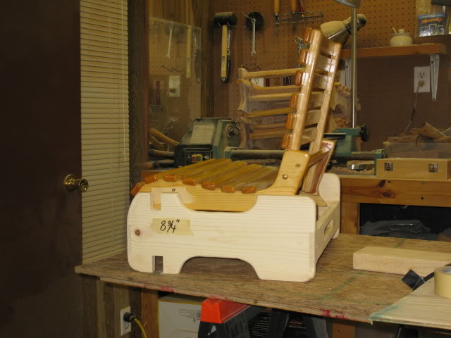

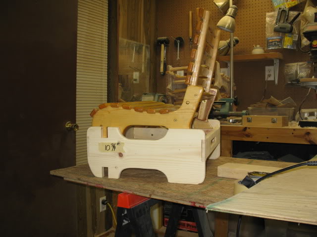

Mike the original design sits low and will aid in keeping your center of gravity low. You could probably use a higher seat in your Glades Skiff or Pit Pan. A higher chair will be more comfortable and easier to get out of, in the boat or as a camp chair.

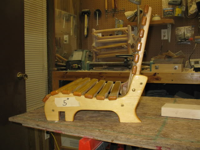

A base can be built to raise the seat, but I don't like having to load and unload another item. This one worked well for me and even gave me a choice of heights:
Normal height aprox. 5"
1230
1 st. option 8.75"
1231
2 ed. option 10.75"
1232
The easiest way I found is to just build the seat higher. You can use a wider board to cut the sides from. The lounge chair design I am using is easy to adapt to higher sides because the back hinges below the slats.
1233
I use a boat cushion or foam seat pad for another height choice. The curved seat slats really add a lot to long term comfort. If sitting or standing on the chair with the back folded down is important to you, the back support slats could be made straight.

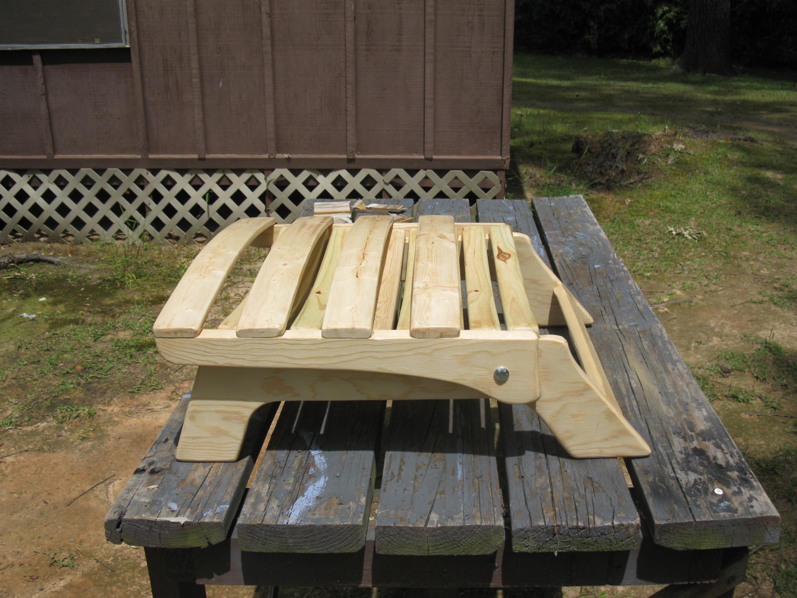

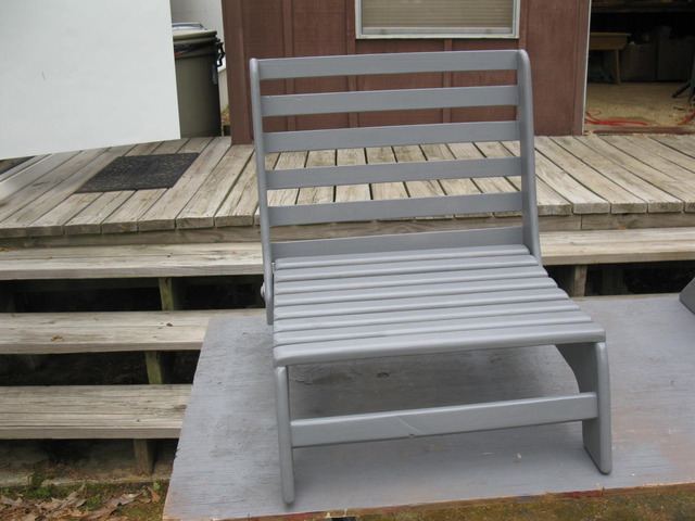

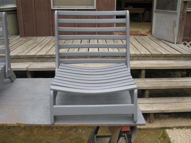

Built another seat. Several of my older seats left me so I needed a spare.
1234

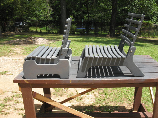

After being "road hard and put away wet" the paint on this one was not so nice anymore.
1235

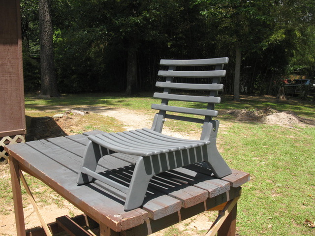

Repainted it to match the new one. I think this color will work better.
1236

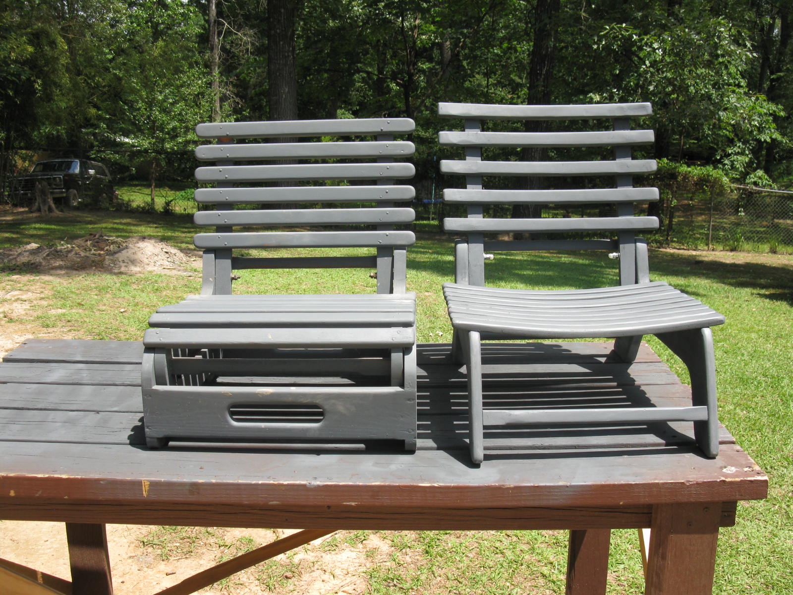

1,632
30

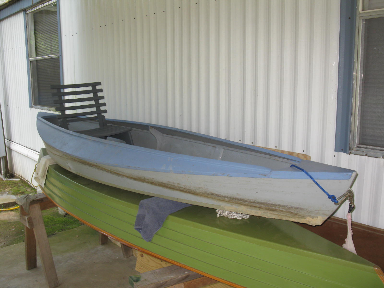

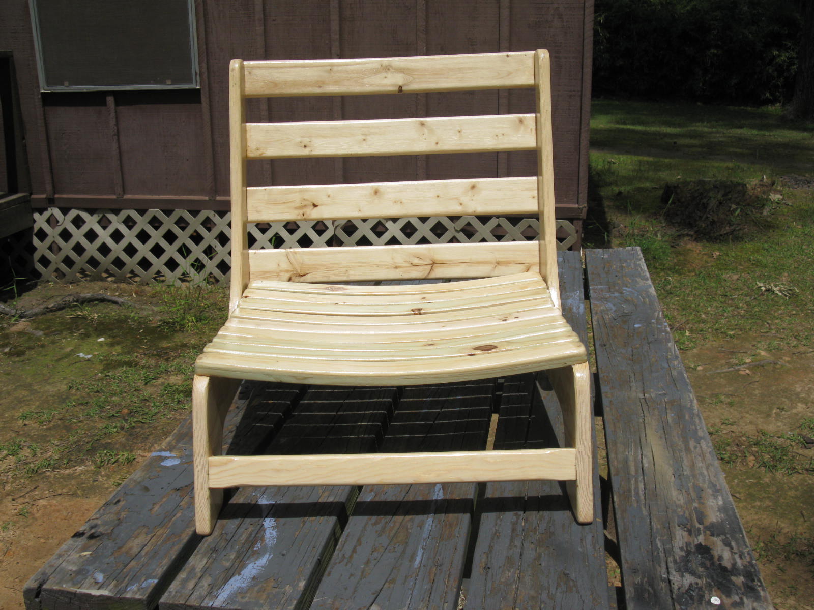

After using my son's pirogue seat and stand in the Ogeechee River Boat I decided he needed something more comfortable. I had to blend the designs to make the new seat to fit his boat. The proto seat back hinges on the outside of the seat. This was too wide so I hinged it like the original seat.
New seat:
1237
Next to original:
1238
In the boat:
1239
He said it was more comfortable and esier to load because it is one piece.
1,632
30
We find the deeper seat with a little slope to the back puts less preasure on the back of the legs at the taller seat height. The curved seat slats are really comfortable and they are the biggest improvement. I usually sit on a foam pad for the extra height, but the seat might actually be more comfortable sitting on the bare slats. Switching between the two positions helps.
I have to say my seats have evovled to fit my needs. Chucks design, the U.J. seat was probably develope with different criteria. It offers a lower center of gravity, can be used as seat with the back folded, easier to build, and has a set of plans.
