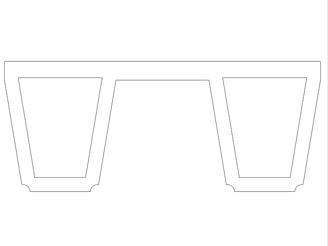

Stiffness and no twisting between the hulls is going to be the biggest challenge.
If I were building it, I'd put this style of frame made from 9mm ply at the front and back of your open cockpit area (your legs would pass through the open area). Fillet and fiberglass it into place.
Cut outs in the corners are to let water not get captured in one compartment.

Thanks for the info guys. Matt I was thinking it would need a cross member system something like you drew and I could put the bench to sit on at level of the bottom of the brace and tie it together with glass and epoxy. That was also my thinking about the one piece decks. Kayak Jack, you have heard or seen of problems with those WW's? I only ask because all I've seen is basically their commercial, and it probably wouldn't be worth the time to copy something that has a few "issues". (Don't bother to reply if we are straying into the wrong territory here with that question.) or maybe a PM. I guess the boat needs to be a bit pigeon-toed to keep the water from stacking/dragging between the hulls.
