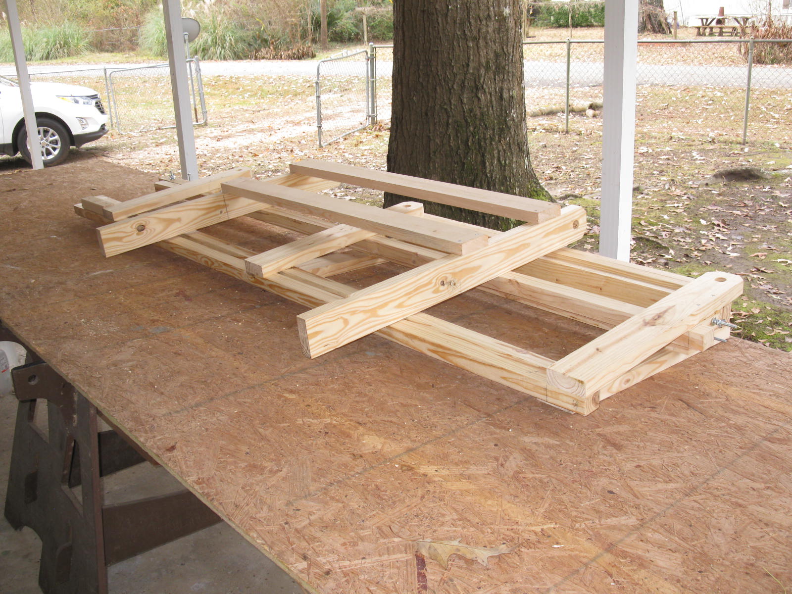

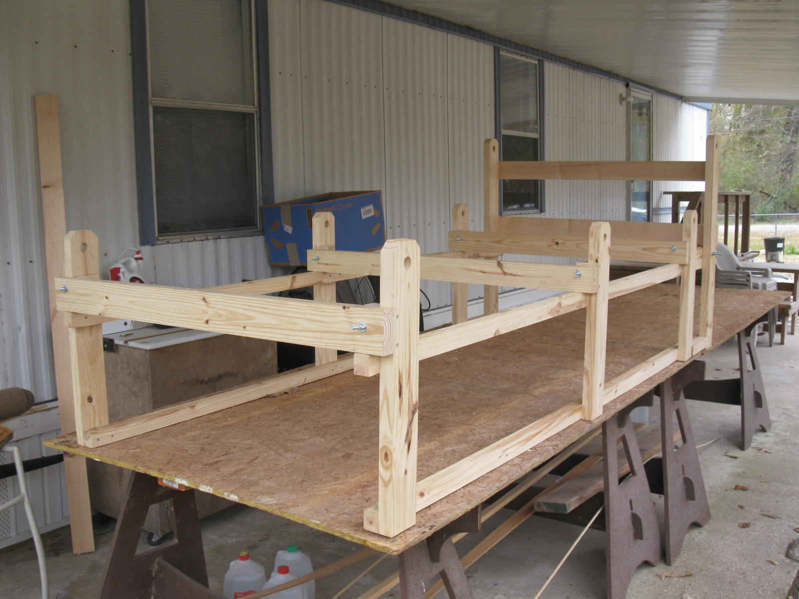

I have been wanting a better way to transport two pirouges at the same time in my truck. We usually stack one in the other and try to cushon any spots that rub. Boats move and they are hard to lift one into the other.
This is my first try and have not used it for real. May have to make some little changes, but right now it looks promising. I need to paint it and install some carpet. It breaks down for loading /unloading and storage.
This a trial fit. I will post more pictures when everything is complet.
Woodwork is finished. Disasembled for storage. Crrage bolts and wing nuts make it an easy job.

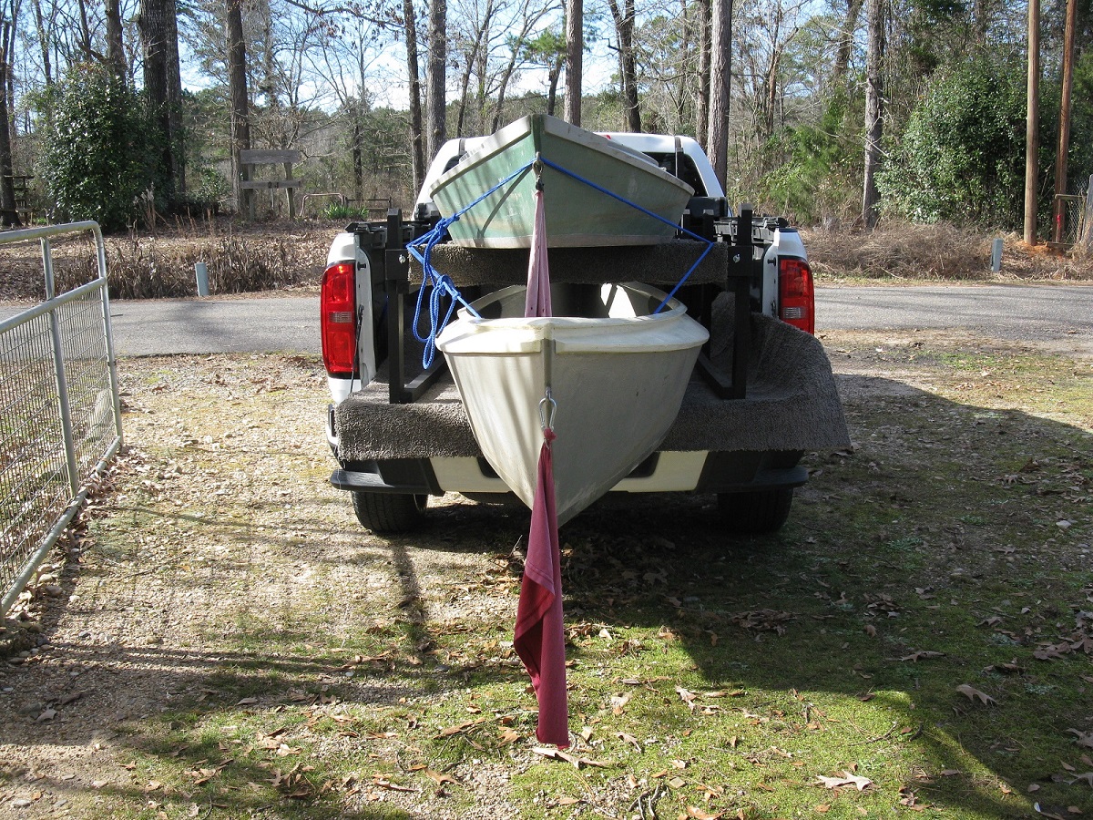

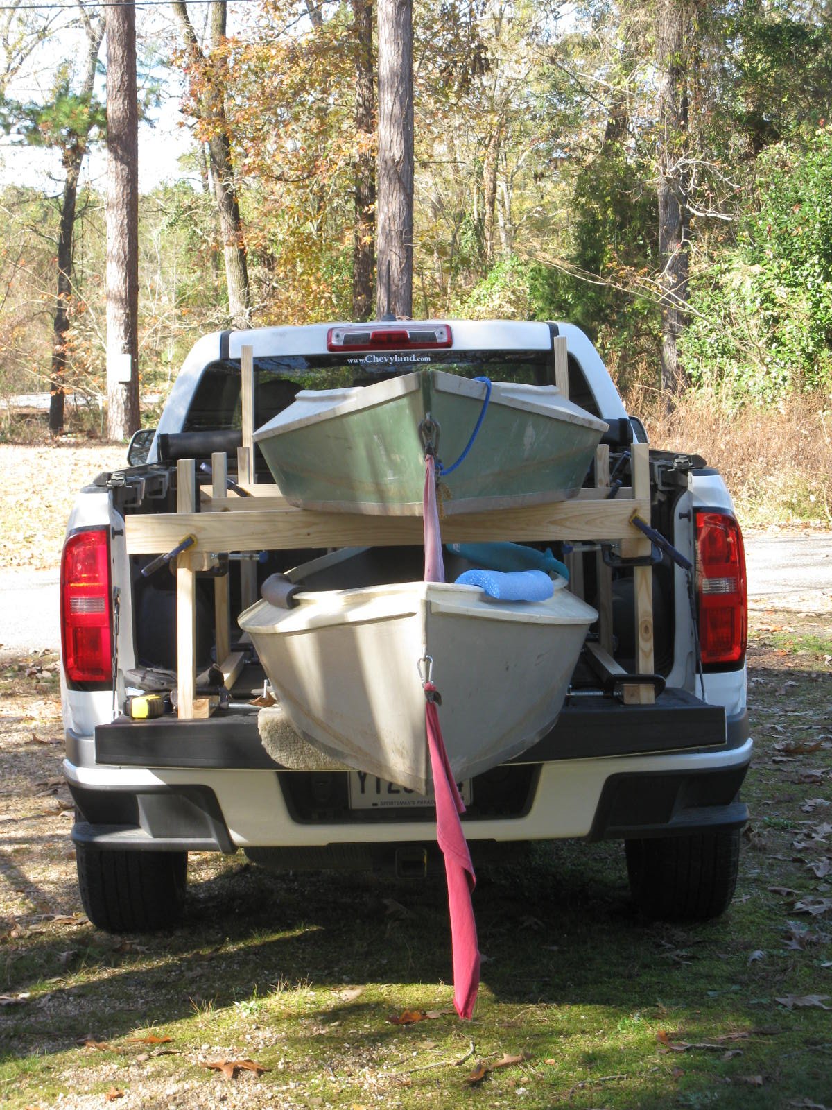

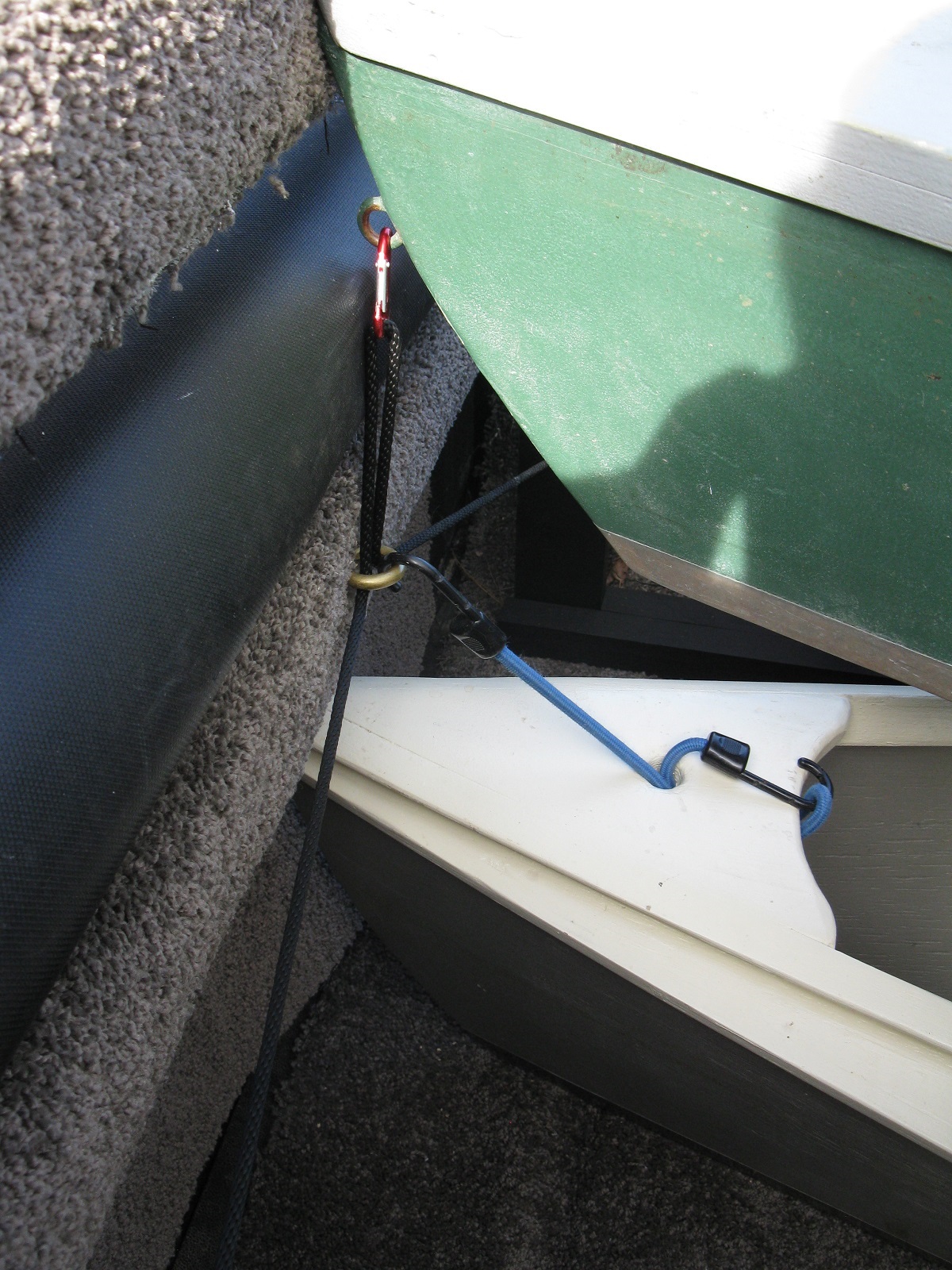

The rack and boats will be tied, straped, or bungy corded to the truck tie down eyes, (maybe all three).
Jack, there is no bottom shelf. The bottom boat sits on the floor of the truck bed. For a longer boat, a "shelf" could be added. The picture exaggreates the overhang. The boat's dimensions are designed to consider how it fits in the truck, without having to use the bed extender.

Separating the boats was the reason (excuse) for building the rack.
Loading the top boat into the other seems to get harder each trip. The rack will allow me to slide the top one into place and then the bottom one. No more picking the boat up over my head and trying to lower it in place, without dropping it or breaking something.
After painting I will cover the cross members with carpet. I need to find a place to unload and store the rack without having to disassemble it each time. It may be best if I just fish every day and that way I would not need to unload it. :)

The rack could/can be slid onto a couple of saw horses. I considered this when building it but since I'm about out of horses and room to put them I added the take apart features. Almost made it with "knock down" joints but decided the bolt and wing nuts would be tighter and stronger. The rack's overall size may be too bulky to carry it whole easily.
Some of the structure could be reduced in size but I didn't see the need or want to do the extra work. Taken apart each piece is not too heavy. If trying to move it assembled the overall size is the issue. It is wider than needed for my current boats but can fit a wider boat if necessary. It will be easy enough to make it narrower if I need to.

Finished the rack. It works fine. Lot easier to load "top" boat onto the rack and slide it into place.
Top boat is loaded first then the bottom.
Progrip makes for easy tie down.
