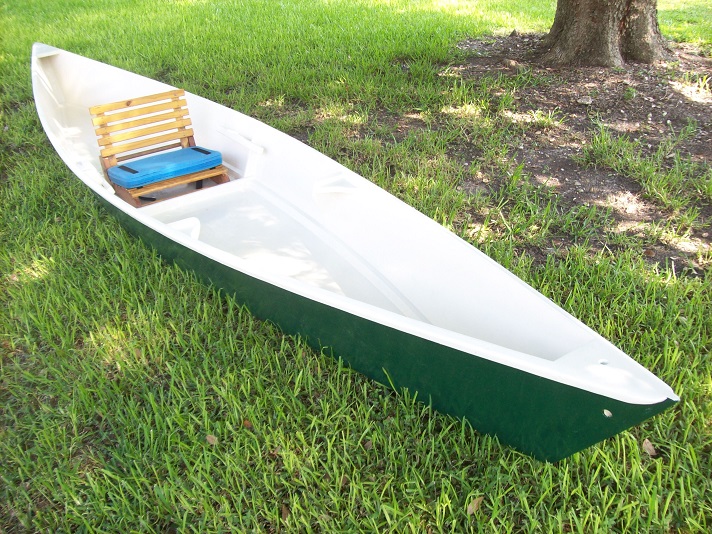

Hi, all. It's been a while since I've posted anything. I'm getting the itch for another pirogue and am going over designs in my mind. Has anyone built a dead flat pirogue, i.e. , no rocker.
This is my thinking. When a pirogue with rocker goes through the water, the front 3 feet of the bottom presents a small "hill" that the boat tries to climb. It obviously can't climb the hill so that water has to be directed almost straight down, slowing the forward speed. With no rocker, the thin bow still splits the water to each side, but there's very little water directed straight down. Now , no rocker might cause other problems like turning difficulties and sliding over obstacles.
I'll have to go back and look, but maybe Tx river rat's "Ugly Duckling" had no rocker.

In quiet waters, a boat wirh a flattened bottom can be OK. In waves, they are between bothersome and dangerous. Displacement hulls - ones that stay down in the water, and don’t climb up onto a step - are always pushing water. Under water, square corners that were easy to build, work against the paddler. Rounder, sleeker shapes do better jobs of moving the water. They move less of it for shorter distances; less power is required.
Would it break any rules if the bottom had a slight vee cross section? Sideways rocker instead of longitudinal rocker.
just a thought.

Jack, a vee bottom wouldn't break any rules, just complicate the build a bit. I agree that rounded corners work a bit better, but that's almost impossible with the flat panels of a pirogue. I slightly round the corners at the chines and that works pretty decent. The Swamper is done that way and is a really nice paddler.

Well, the pirogue we know today was designed for the waters where I live. It has to go over logs and debris, and be able to nose into the slushy banks of bayous so you can get out easily. Almost all boats are location sensitive, and I've found the pirogue to be just about perfect for these waters. Some boats do some things better, but the pirogue does most things very well. The only thing I've found it doesn't do well are 2 foot waves with whitecaps. Now THAT will definitely get your attention! Don't ask me how I know that. ;)
