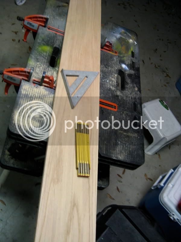

First I started with a pretty nice grained piece of red oak.

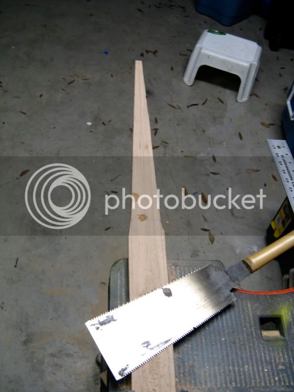

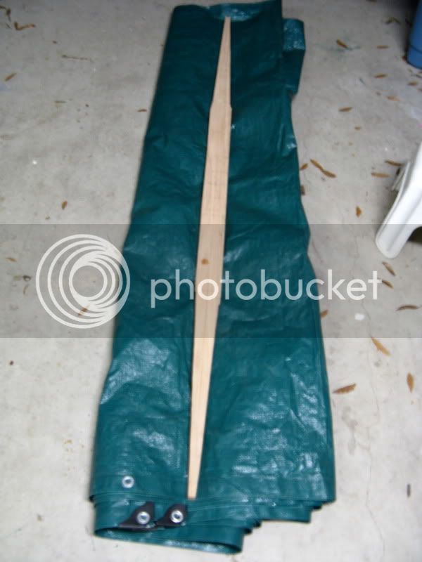

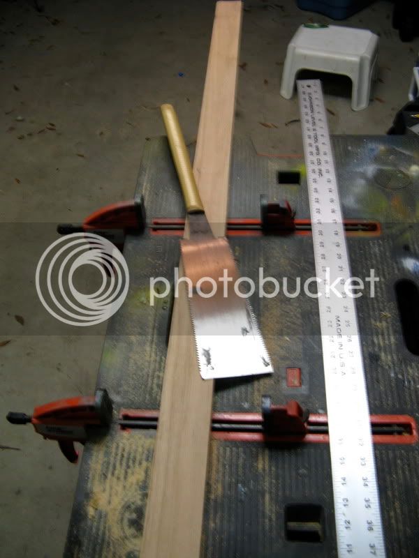

Ripped it by hand with my riobi saw, which I might add was no easy task.

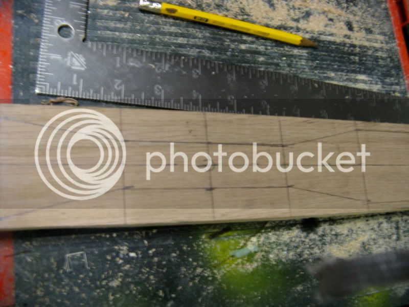

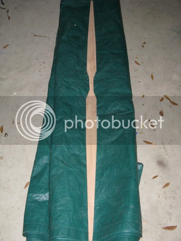

Did my lay out

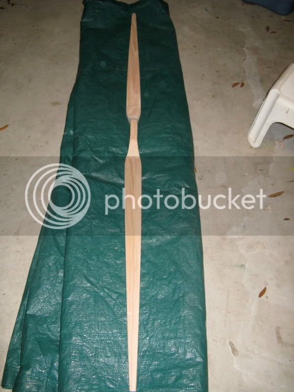

Rough cut
Another view

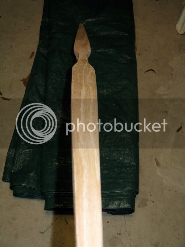

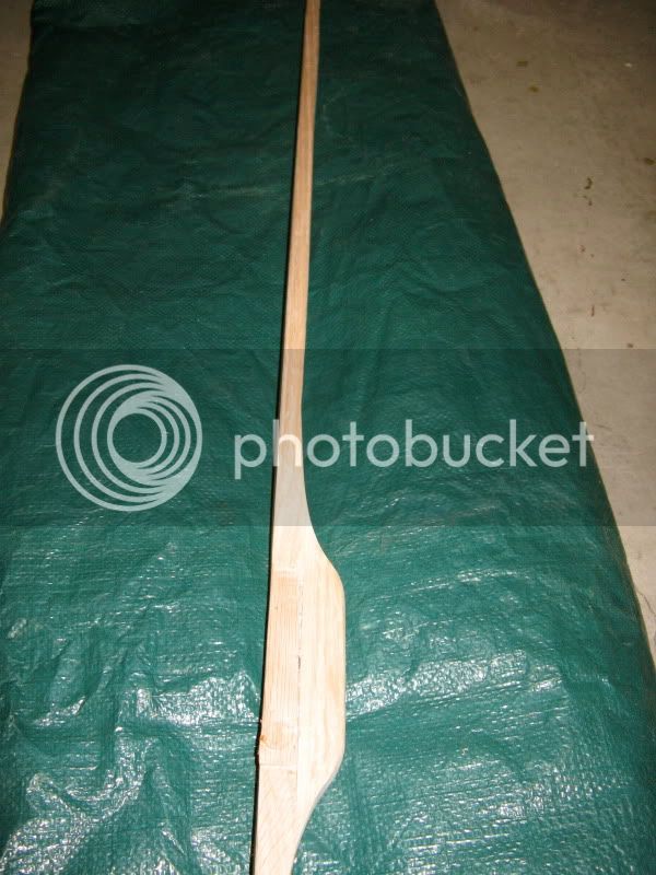

And rough cut my grip

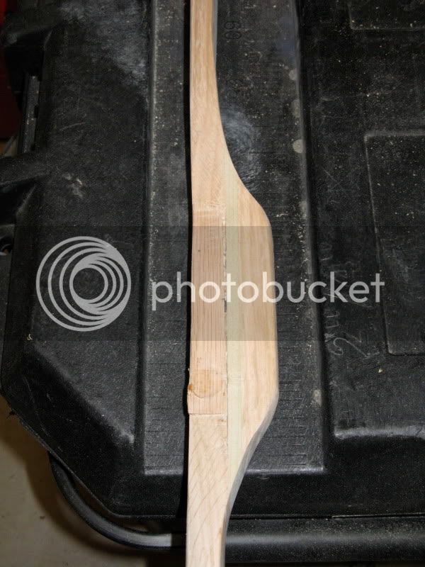

Here is wear I messed up a bit. I got a little over zealous with the chisel and cut the grip a little off kilter and a little narrower than what I would have liked. But I am trying to fix with a couple small pieces and some artistic shaping.

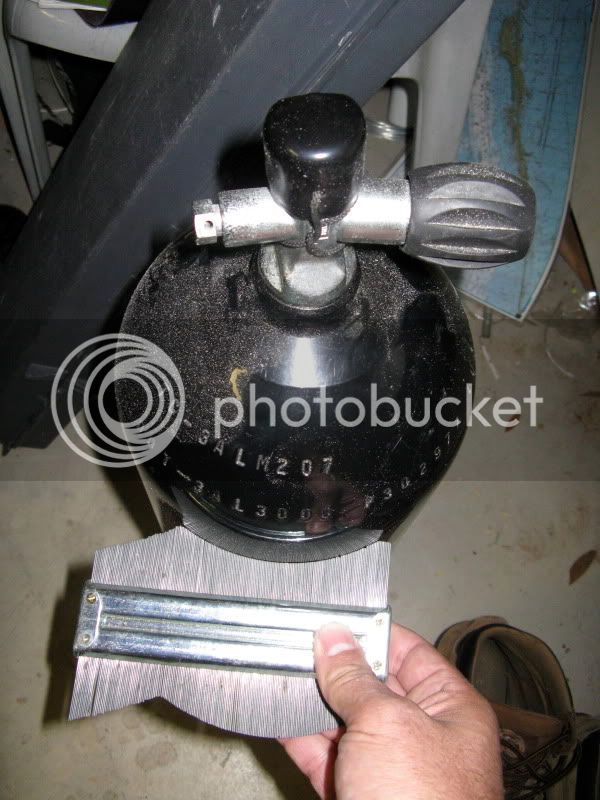

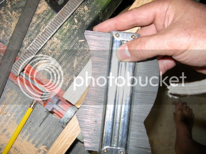

I glued on additional red oak and a couple small pieces of poplar to for the rest of the grip. Notice my high tech radius template

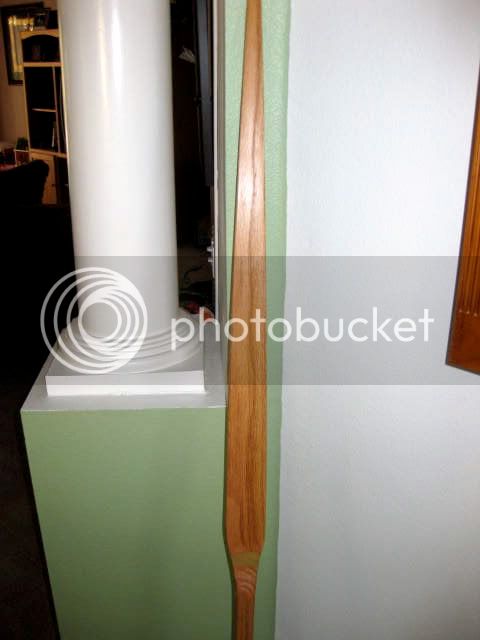

Now I am starting to fair it out.

BTW, on your Japanese hand saw, take a pair of common pliers, and break off those two, outside corners about 1/4 " to 3/8". Expose the teeth. This way, you can start a cut in the middle of a board as easily as on the edges. A Japanese carpenter taught me that in Northern Japan about 45 years ago.

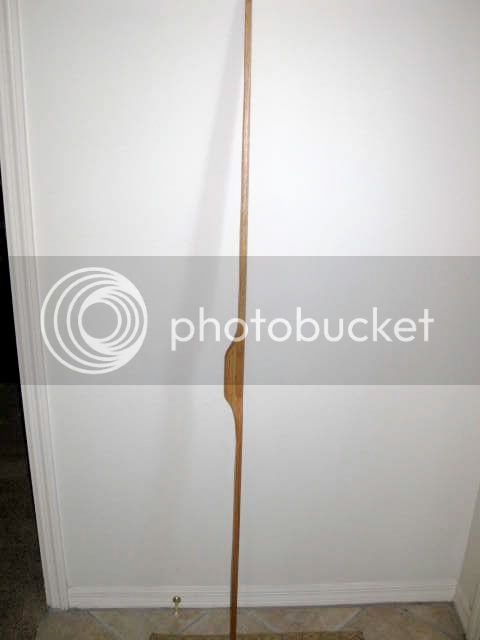

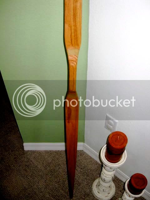

So my next step was to sand the bow down.
80- 120- 200- 400 grits
Then I hand rubbed some linseed oil into the work. I forgot how unimpressed I am with red oak. It just seems too porous for my liking. But the oil fills it in nicely and I will continue to oil the bow for a while.
I am not very happy with the handle. But I think I am going to hide it behind a leather grip.
